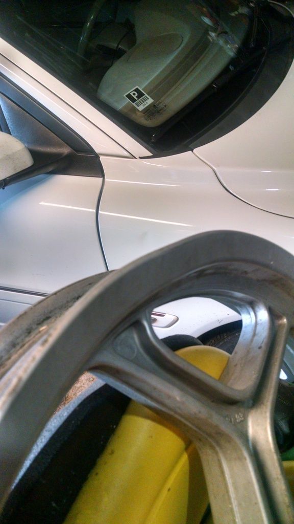

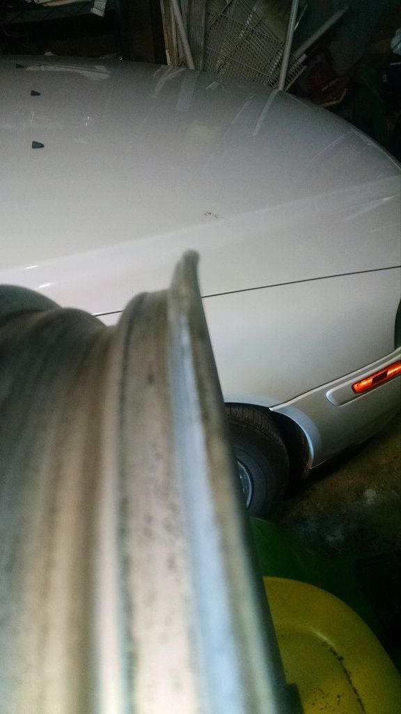

Okay, so here's the full rundown. I didn't have my paperwork and I was at work earlier so I couldnt give full details.
I bought the bike last august at 35,000 (it's now at 38,559 so i've ridden approximately 3,500 miles with it.) for the 7ish months I've owned it I've ridden approx 3,500 miles. All of these miles were on the original front wheel and the tire I mounted when I bought it. When I put the brand new tires on the original rim, my mechanic told me that the rim was bent and that it might not hold air. I decided to see if it would work and I had zero issues with it all season until early this year (Middle of February) that the tire ran flat, and ever since then, it had run flat after 2-3 days. I dunked it in a bucket of water to determine where the leak was and it was at the point of the bend.
Then I purchased a used rim that was white, repainted it, and installed it, putting the tire that had around 3,500 miles on it (still plenty of tread and no cracks or issues with the tire itself. It was mounted and balanced professionally.
When I purchased the bike I changed the tires, brake fluid, battery, and rebuilt both master cylinders. I also changed the engine oil, trans oil, and final drive oil. I flushed and refilled the forks.
When I started experiencing the issue the only thing that had changed was the rim, and the brake pads.
I know that's a lot of reading but you wanted the whole story, hope this helps!
Here are the pictures of the rim:
http://i1378.photobucket.com/albums/ah99/mike_smith46/Mobile%20Uploads/IMG_20160403_180551897_zps8xmooqiy.jpg
http://i1378.photobucket.com/albums/ah99/mike_smith46/Mobile%20Uploads/IMG_20160403_180559764_HDR_zpstmykjwrt.jpg
Are either of these the tire code?
http://i1378.photobucket.com/albums/ah99/mike_smith46/Mobile%20Uploads/IMG_20160403_180658157_HDR_zpslsykdmrj.jpg
http://i1378.photobucket.com/albums/ah99/mike_smith46/Mobile%20Uploads/IMG_20160403_180703292_zpsrel4y0tl.jpg

The date code looks to be "1715"  ie 17th week of 2015.
So it is just less than a year old.

okay that's what I thought, so that's not excessively old right? I've never had tires for this long. Also, I tried what Johnny suggested with holding the brakes and pushing with everything loosened and it had no effect.

Based on my understanding of what you have written, I think the tire has been deformed by lack of rim support in that portion of its sidewall and bead, and will be a problem from here on regardless of its date of manufacture. If it were my bike, I'd mount a new tire.
