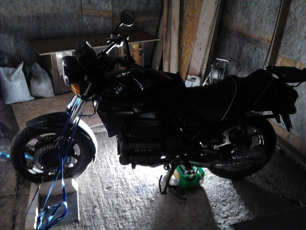

I've built a front wheel stand with ratchets to lock down the forks, played around with a trolley jack and blocks to see what works well, charged up my old point'n'shoot camera and bathed all the suspect  bolts in WD40...

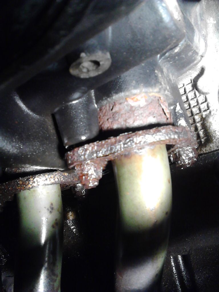

Speaking of which: I'm not everso keen to go near these!
Am I right in thinking I can get away with removing just the muffler, here:
And if so, will I need to order a new pipe-to-muffler gasket?

No need for the mica gasket sold by BMW. Use high temperature sealant or muffler cement.  Read this thread.

Speaking of which: I'm not everso keen to go near these! Am I right in thinking I can get away with removing just the muffler, here . . .
Then don't go near them, Kaleb, not if you're working on a K75. The video makes that clear. Better take another look at it. Replace the WD40 treatment with a 50/50 solution of ATF/Acetone for releasing seized fasteners.
Work with finesse, brace yourself and keep a cool disposition so you won't shear the head off a seized bolt in frustration. It's then that the real fun begins and the ticking clock gets a lot louder.

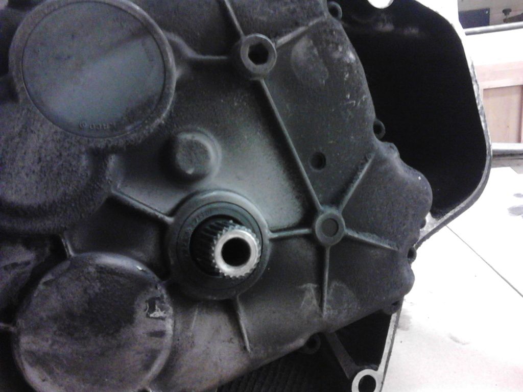

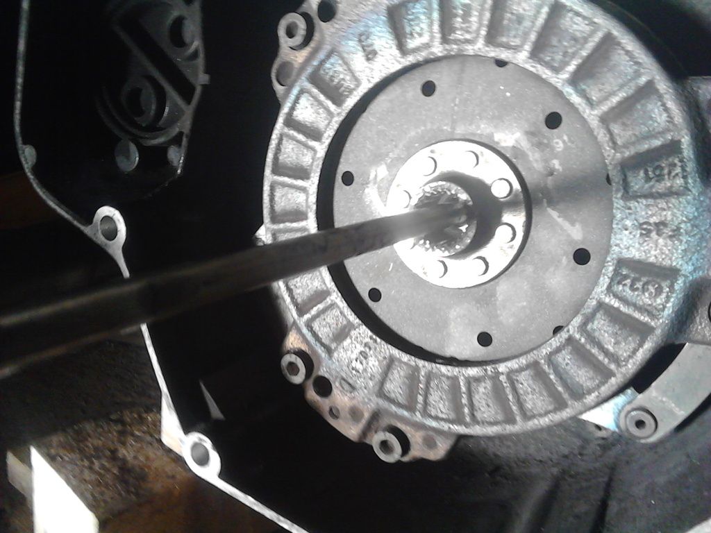

The clutch push rod is still protruding from the centre of the clutch. Chris Harris' appears to come away with the tranny, as is clearly visible sticking out of the block once he's removed it.
Mine looks like this:
No rod.
While my clutch looks like this:
Any ideas?
Oh and I found a load of metally-fibred crud between the tranny and the clutch housing, so I'm guessing (hoping) that's my catastrophically failed friction plate....
Good night hey, happy easter!

D'oh! Sorry, I'm being a plonker. Should've been reading Haynes alongside the video, of course it's a k75 thing, different to the 100 in respect of the rod sliding out with the tranny, or not.
All good then!
  • bristol, uk
  • k75 '93
  • Posts: 6856
Re: clutch fail essay
« Reply #24 on: March 25, 2016, 06:06:35 PM »
The clutch push rod should normally come out with the transmission.  It should not hang in the clutch like that.
Can you easily pull the rod out of the clutch?  If not, there is a problem there.  It could be a misalignment between the friction plate and the diaphragm spring.   Or, it could be that the pilot on the end of the push rod has been bent during an earlier transmission removal.
The bent rod could possibly be cause of the clutch failure.  By not being able to smoothly slide through the spring plate it may have interfered with the clutch action preventing proper action and burning the friction material.
Even the slightest bend in the end of the rod will cause a problem.  I think you can check for bend when you reassemble the clutch with the alignment tool.  Once all the clutch parts are aligned, it should be easy to slide the pushrod into the clutch assembly.  If not, you will need to replace the rod or attempt to straighten it.  You may be able to file away a very slight bend that can't be straightened. Just get the high spot that causes the binding, being careful not to touch the last cm. at the end that is held in the pilot shaft.
Here's hoping you don't need a new rod, as that will mess up your plan to be done before Monday.
