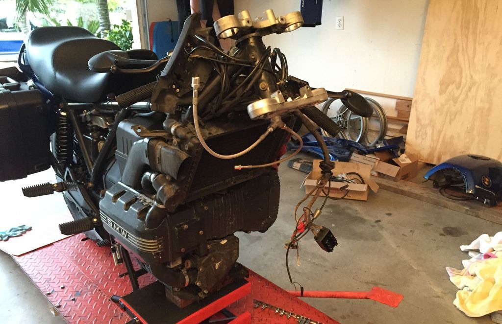

Swapped out the triple clamps and forks today. The brake lines have been a real puzzle for this project - but I think I finally managed to get all the bits I need and be able to use the Speigler lines I ordered a while ago. I should be able to put it together tomorrow and see how the BMW Sport forks feel.
No time for painting or other cosmetic work this weekend. Just gonna try to get it assembled in better working order.

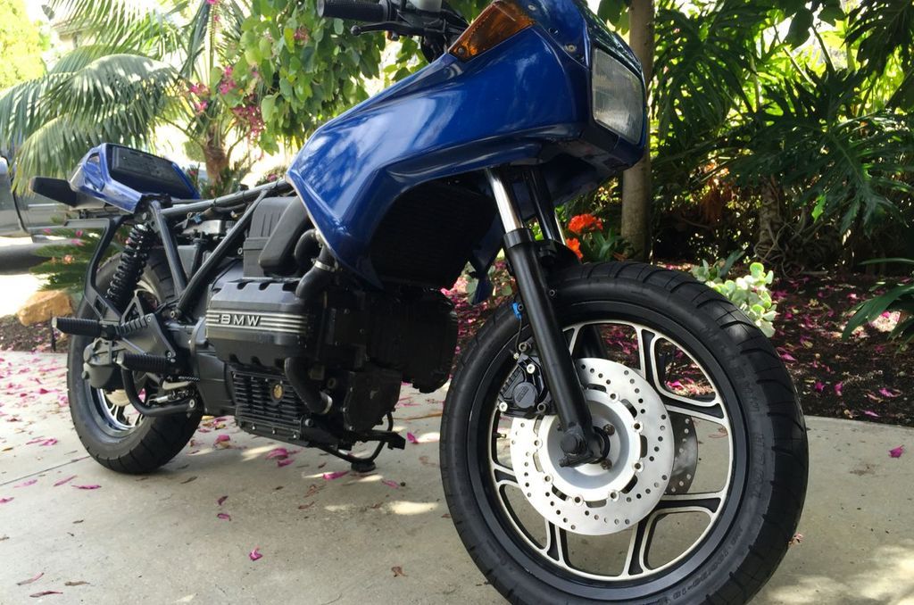

Finally making some more progress. While I've been pleased with the improvements in handling, the front-end still wasn't quite right. There was some chatter in the front end on braking, and I found the stiffer springs to be too stiff for rough roads.
Here's what I've got going on now:
Replaced steering bearing and races with All Balls brand
 This thread, and the fuch!ng Chris Harris video, were very helpful. I had never done this task before. http://www.motobrick.com/index.php/topic,6906.0.html  The old races had clear signs of wear, including a spot that got pitted (perhaps from sitting outside in the weather). I suspect now that the pitting contributed to the front-end chatter. FWIW - I used the dust seals that came with the All Balls bearings, despite the common-wisdom recommendation to discard those and use the BMW type. I have put the forks back on and the steering head moves smoothly and effortlessly. More discussion (and pictures) about the dust seals at the above link.
Removed Fluidbloc steering damper
I suspected that the damper might have gone to the dark side and started working against me. It can only be removed when the steering bearing races are out (FYI - a bit of clothes-hanger dowel is the perfect driver to remove the damper). It was a bit mangled - I don't think I have ever seen a picture of one, so here is the one I removed, for the record.
Had the 1990 Sport forks rebuilt
I was planning to do this task on my own, and had secured all the parts, but decided to let a pro do it. Glad I did - he said it was very difficult to disassemble the old ones, becuase the springs were so strong and there was some corrosion up top, probably due to failed O-rings. Progressive springs are in (hopefully will match ride quality with the Progressive shock), along with seals, o-rings, and all new crush washers.
Bits of paint and polish... more pics when it's rolling again.
  • Carlsbad, CA
