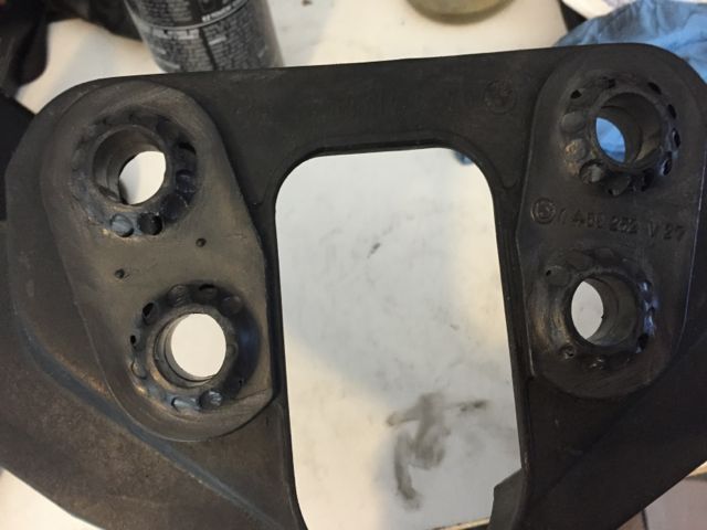

I think I have solved the bouncing gauge problem too. I filled all the smallholes in the rubber insulation mount with silicone gasket-maker. The gauge cluster is much more stable now.

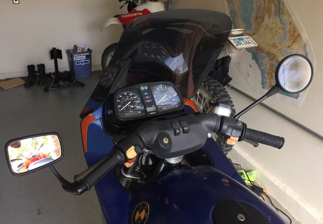

Been a while since I updated here. I got a little discouraged by the project - just things taking longer than I want and my wrench-to-ride ratio has got out of balance. In large part due my Red Moto Guzzi (lurking in mirror below) - which needed head gaskets, a new clutch, and some transmission work. Thought of selling the BMW - even placed a couple ads. But I put the price unrealistically high, which means I must not have been too serious. Anyway... I'm going to keep it and finish it up. I gave it a little attention today - new mirrors (because I really detest the lollipop mirrors).

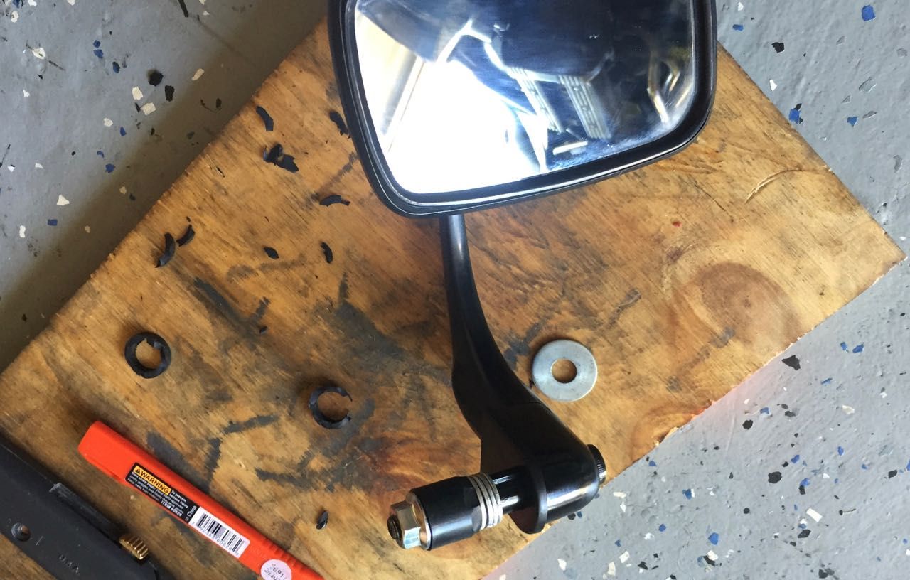

As I was installing them, it occurred to me that I have Axis-power on the bars now. BMW handle bars (Germany); Tomaselli grips (Italy); and Napolean mirrors (Japan). I just finished watching a WWII series...
The Napolean mirrors go easily on the LH side, but the RH was a challenge. I was surprised to see how far the throttle tube extends over the handlebar. The mirror installs with rubber compression fitting - which expands into the trhottle tube and locks the throttle. So for anyone else considering these mirrors, here's how I trimmed the fitting and spaced it so stays contained in the handlebar and does not interfere with the throttle.
Went for short ride - and my fairing is shaking again. I keep snugging it up and it keeps coming loose - that's one of the little things that's been making me mad. But it's solvable.  On we go with the project - but probably slowly until I do fair bit of work on my other Moto Guzzi (including another clutch).
