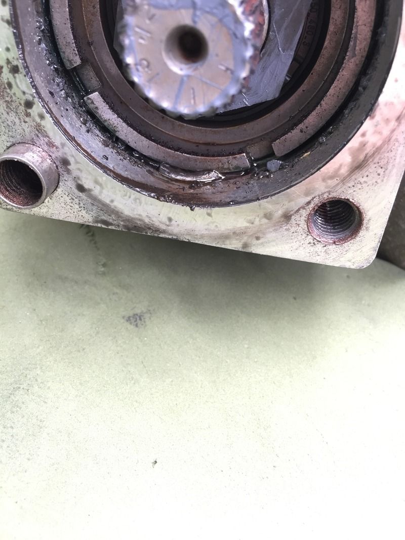

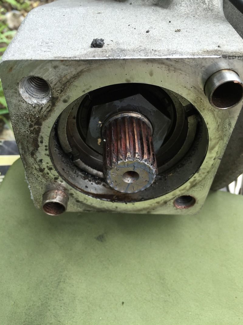

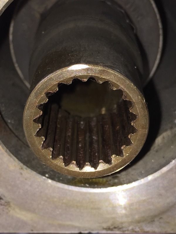

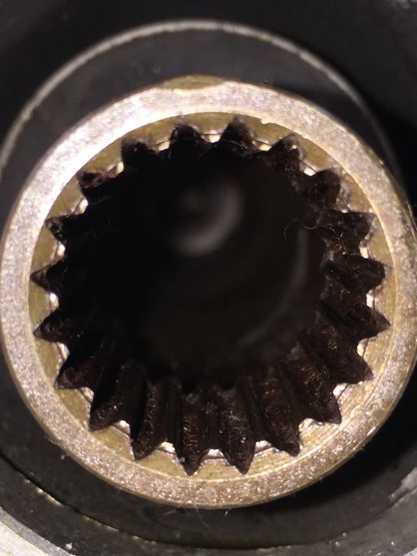

After owning the bike for about a year, I did my first ever final drive and drive shaft spline lube and I have a few questions. (comments welcome):
1. The final drive splines appear good. Drive shaft have some wear but are useable. There looks to be one area of the drive shaft splines/edge that looks damaged. Someone with more experience, please let me know what you think.
2. I seem to have a pinion seal leak. I have noticed a bit of stain at the final drive/swing arm joint but nothing bad and never any drips or running. From what I have read, I should keep an eye on it and occasionally make sure my final drive oil is topped up.
3. I found debris in the final drive around the splines. Someone said this could be grease that has separated.
4. I also found what looks like a broken piece of a metal ring. Any ideas what this could be?
Thanks for the feedback!
You can see the piece of metal here at 6 o'clock:
Drive shaft splines. They look funny between 11 and 1 o'clock but the rest look good. It also looks like a dent on the edge at 12 o'clock. Anyone seen this before?:
I would guess a piece from a lock circlip inside the uni-joint.....keeps the uni-joint to the g.box output shaft.

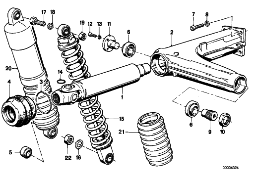

It most likely isn't part #3. Possibly #14 is what Inge was referring to.
There is a 'locking ring' that is located on the transmission output shaft that the drive shaft yoke slips over the top of the ring. There is a matching retaining groove internal to the drive shaft yoke that fits this ring to help prevent the yoke from slipping off of the shaft splines. This is why when you remove the drive shaft you have to "pop" if off as you have to overcome this ring.
The later paralever drive shafts use 1 of these type clips on each end of the drive shaft as the sliding is done in the middle. Part #3 in this picture is at least a reference.
26 11 1 451 977    SNAP RING - 19,7X2/5MM
Edit:  Ok in your post image part #14 is the same snap ring (same part#)..... they just didn't seem to place in the image in it's proper use or position...............my bad.
