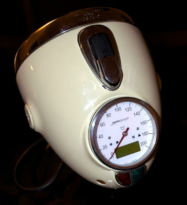

I managed to integrate a round instrument in a square K

RBM, I like that headlight bucket with the speedo, found it in benji cafe racer: http://www.benjiescaferacer.com/headlight-bucket.php. trying to find in internet how to do it using fiberglass but nothing.

The headlight nacelle I used is a real vintage BMW R52/2 headlight bucket from 1955.  I also bought real vintage BMW headlight mounting ears.  I refurbished the bucket and modified the ears to fit the K1100 forks I used.  Then I got the whole shebang painted.
The bucket from Benji cafe racers will work but check with them first to make sure the instrument hole is the right size.  The Motogadget Classic gauge is exactly 80.0mm in diameter.
