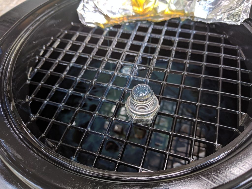

Rode to work and home (twice) today. After work, drained the transmission and final drive, refilled with Mobile 1 synthetic 75w90 and MolyB (2 TBS in tranny, 1 TBS in final drive).  MolyB is a right PITA to clean up.  :nono
I do not know if the transmission oil was ever changed. Here's what I found on the magnetic drain plug when I pulled it.  Bike has 6500 miles on it, more or less.  Should this concern me?  It does...
Lastly, HUGE thanks to whoever it was that posted the suggestion in one of the many threads here to make a 'splash guard' out of aluminum foil to keep the oil off the center stand and rear tire.  FAN-FREAKING-TASTIC idea!
The magnet is doing its job collecting particles; you're doing your job by changing the transmission oil at regular intervals. Your transmission is barely out of its infancy if that mileage you're citing applies to it. A little incontinence should be expected in this stage of its growth and development. Which would you prefer doing—disassembling the transmission looking for trouble or riding around gazing at your reflection in storefront windows or the paint of your highly polished cage?

...Should this concern me?  It does...
--Begin Humor--
Why the hate? The drain plug did it's job. Your lack of tolerance is troubling. My Wife's 8 year old son saw this and said "Do I have to grow up in a world where people so dislike metal shavings they'd resort to harsh condemnation and critique?"
--End Humor--
But seriously, I've ever seen a magnetic drain plug with out something stuck to it. I'd be glad it's there.
So long as there are no big chunks no reason for alarm.  It's simply the final machining taking place.  This is considered normal on my other bike with about 40k....
Chaos is right, BUT...I changed my tractor transmission/hydraulic fluid today, 12 gal capacity, 2 magnetic plugs, severe duty usage, 2yr/1000hr change interval, AND I did not have that amount of metal on my plugs.  Important points here are use quality lubricants (and moly), change when machine is warm, have a usage appropriate change interval, and don't drive like an 18 yr old :hehehe :bmwsmile .

Appreciate the feedback and guidance on the furry drain-plug question.  I'll make an entry in my log book "How I Learned to Stop Worrying and Love the Shavings."  :beer:
