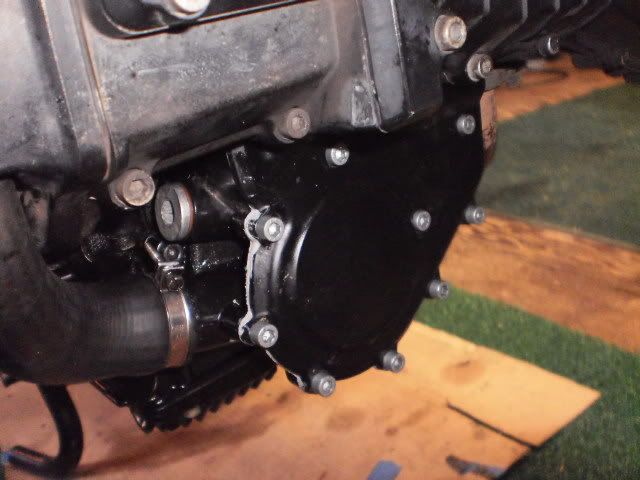

 Fix small oil leak from the last winter project, not enough sealant
Finished product
I saw one of these on Craigslist, and thought I woudl try one out.
Bob

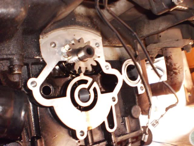

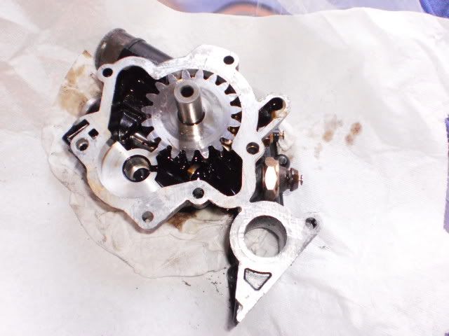

Finished product
I did the same thing last night. But my oil seal was in bass ackwards, with a bad shaft to top it off. So I rebuilt it, new seals and shaft. The put it on with some anaerobic flange sealant (Great stuff, btw. Soluble in oil, hard as a rock when pressed in between a flange, cures anaerobically, so it stays soft if it squeezes out.).

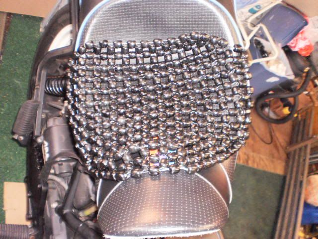

Hey orforester - I see you bought a "looks like toot attenuators... las vegas buffets on a daily basis over time will cause toot erosion to your moto seat...
the installation of beaded toot attenuators will absorb and distribute the toots over more space reducing its negative effect on the moto seat..."  Johnny Oct 2011
We really like ours, makes 500 to 600 miles a day an easy ride ...
I had a complete service on my K done at the shop here in Vegas, ready for a ride to Phoenix next week (if the weather cooperates), also tried out my Garmin 1300 mounted on my tankbag.  Still trying to get a "setup" that I like... dam - it was cold !!
Good luck, IMHO beaded seat covers are totally worthless !  BTDT, read a REAL pain in the ass. (pun intended)
Personally, I've tried gel inserts, sheepskin only to return to stock.
One is better off springing the cash for a Russell or Sargent seat and be done with the deal.
WHY are you mounting the Garmin GPS on the tankbag ?  Ram handlebar mount with a 1" arm is the ticket. ROCK solid, plus you can angle to defeat sun glare.
The ROHO system aka Airhawk looks interesting but pricey. Used for bedsore pressure management in the medical field so it may have some merits.
