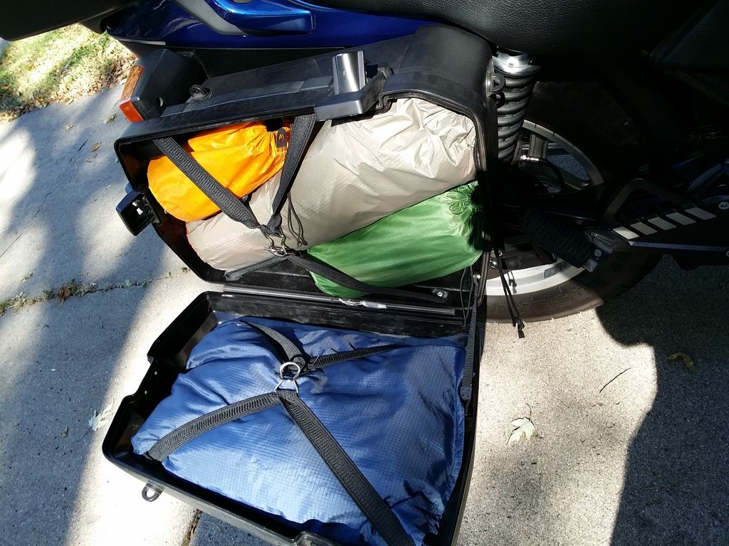

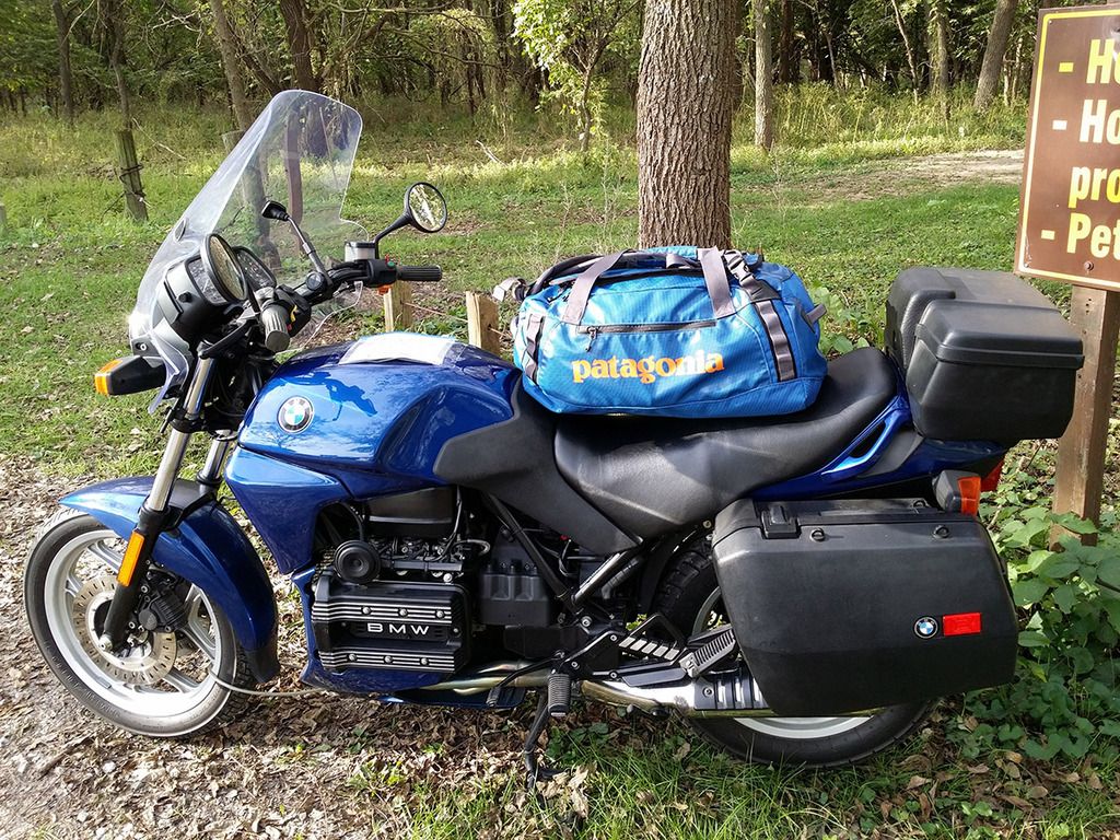

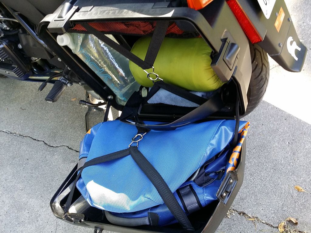

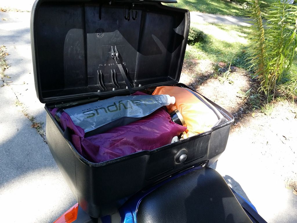

« Reply #2016 on: April 21, 2016, 01:39:02 PM »
Before getting into motobricking I dove deep into backpacking (week long, 40 to 50-mile trips in Colorado and Wyoming).  The gear that I optimized for backpacking - it tuns out - is perfect for motorcycle touring!  Here's a few photos from a recent tour of the Iowa's Loess Hills:
Right case:  stove (yellow);  tent (grey);  sleeping pad (green);  pillow (blue)
Left case:  camp chair (adapts sleeping pad) (red); sleeping bag (yellow); extra water (clear);  just-in-case towel (light blue);  backpack/duffel (blue)
Trunk:  water (grey);  food (purple);  misc supplies (orange)
Ready for 1/2 mile camp site hike-in at Iowa's Preparation Canyon State Park
