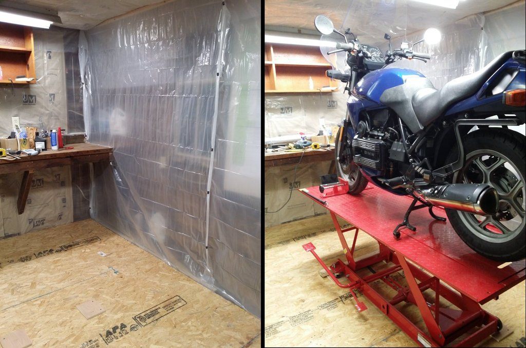

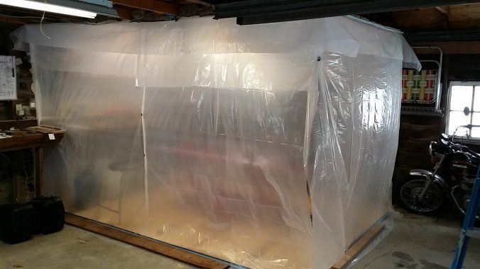

In Iowa, where winter temps hover in the 20's, an unheated, detached garage is not the best place to wrench on your favorite K-bike.  So this past January, I built a motobrick repair tent.
Tent consists of:  (3) 4x8' sheets of 1" rigid blue insulation (floor) + (3) 4x8' sheets of OSB / oriented strand board (floor) + 75' of 10' wide x 4 mil plastic sheeting (walls & ceiling) + 100 sq ft of R13 batt insulation (ceiling).  (2) 48" x two-bulb flourescent light fixtures provide the illumination.  (2) 1500 watt space heaters do the heating.  With this setup, I've warmed the tent to 65 deg F on a 10 deg morning.
The tent has allowed me to install headlight relay kit and progressive forks this winter - something I wouldn't have tried in past winters.
  • Ames, Iowa
  • '92 K75
- Scott

... I built a motobrick repair tent.
Offline slipring
  • Posts: 37
« Reply #1897 on: February 28, 2016, 10:11:23 PM »
...it did turn out a little kill-room(y), didn't it?
