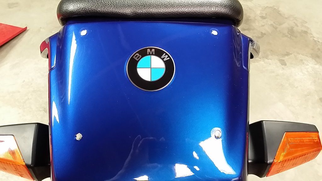

New rear BMW emblem:

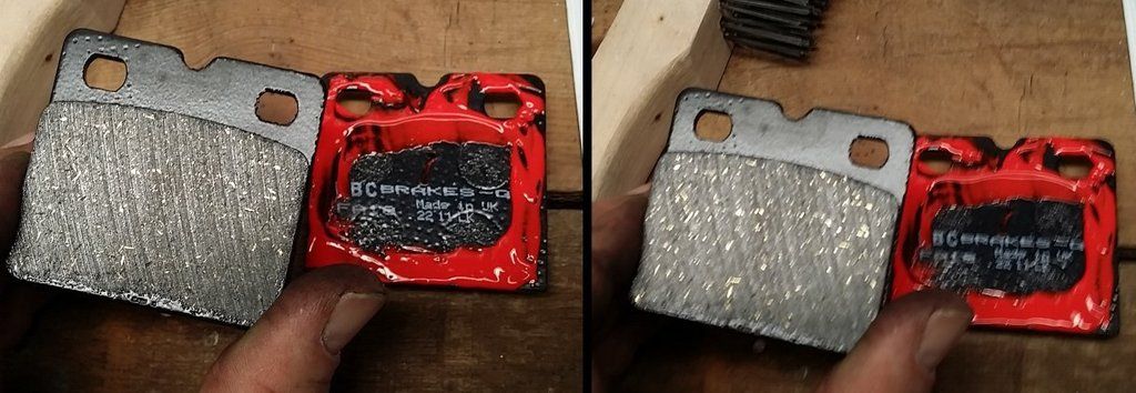

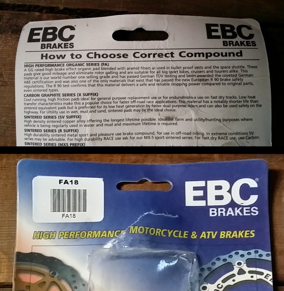

Thanks for suggestions.  I recently installed a new EBC MD611 rear brake rotor and EBC FA18 pads (with CRC Disc Brake Quiet) in rear calipers.  The FA18 pads (from fleaBay) are supposed to be organic/kevlar, but they did have what looks like metal flakes in the pad composition.  I still have a bit of squeal with rear brakes (though much less than before).  Two months ago I installed EBC FA171 pads (again, with CRC Disc Brake Quiet) in both front calipers and that brake system is now dead quiet.  I don't recall the front ones looking like the rear ones in photos below.  Is it possible that these were packaged incorrectly and what I just installed are actually of the "sintered" variety?
