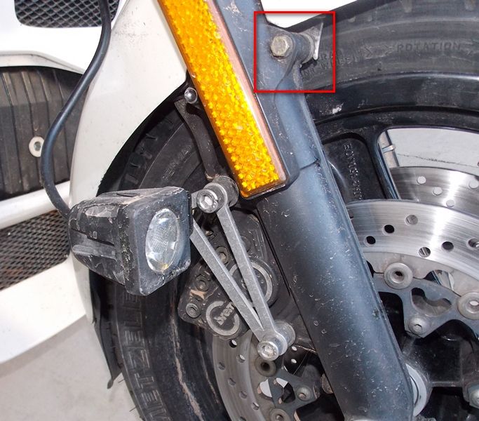

New brackets for my LED's.  Moto Ghost (my BMW shop in Phoenix) makes these.  Moved them from where they were ( red squares)
