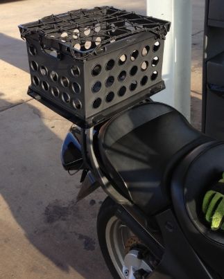

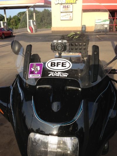

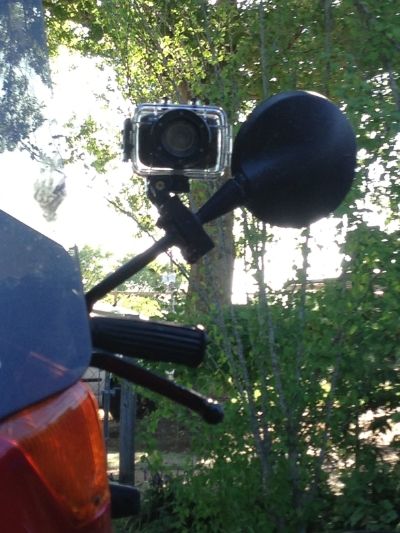

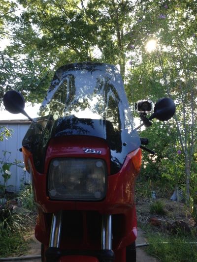

I picked up a knock-off moto-camera on Woot a while back. I used the handlebar mount on my left mirror stem on my K75S and the suction cup mount on the dashboard of my R11100RT. The videos turned out pretty good for a $45 camera.
K75S:
R1100RT:
K75S:
R1100RT:

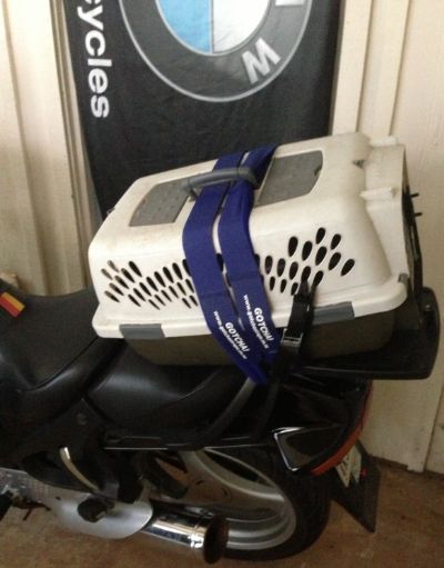

I also replaced my Givi top case on my R1100RT with a WalMart $3.50 upgrade. Not sure if I can make this work on my brick.
Turned out much better than my last upgrade attempt. My first try blocked the pinon seat.
