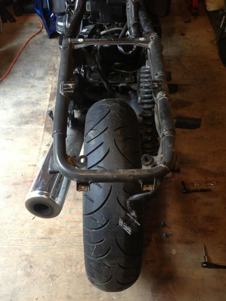

Got the tranny back on and the swing arm. Worst part of the job so far was that boot on the front of the swing arm. Hopefully it continues to go smoothly. During photos:
