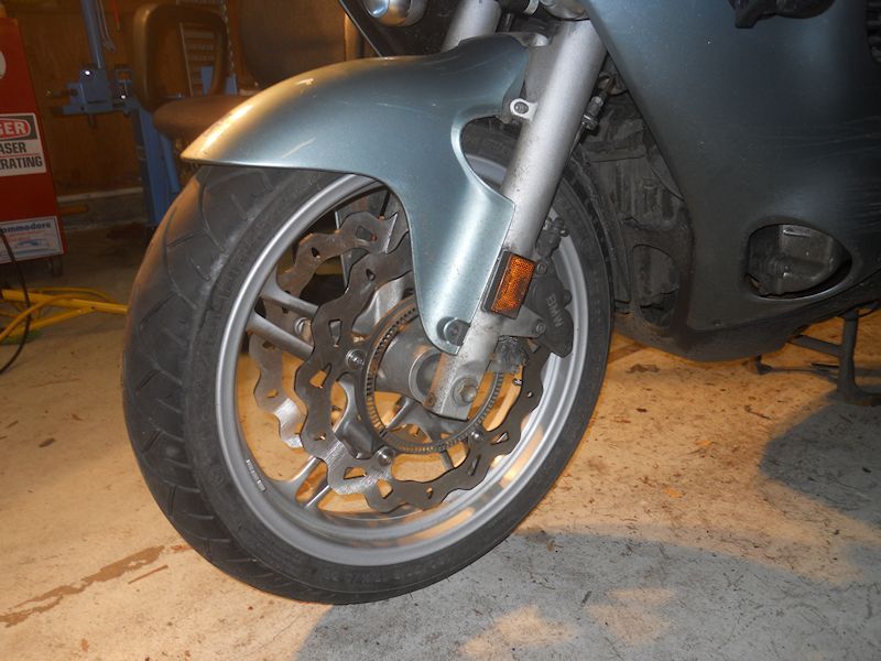

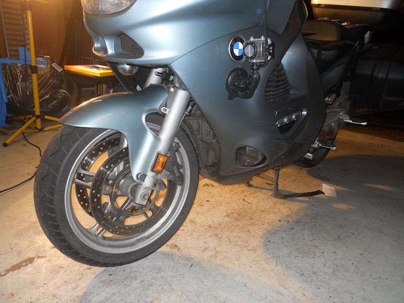

Brake rotors were still in spec, but not by much.  Noticed last tire change some grooves and pitting.  A little searching and a set of Galfer Wave Rotors were purchased for less than a single OEM rotor.   And now there is no more "Loud Brakes Saves Lives" squeal!
OLD OEM
NEW GALFER
NEW GALFER
Ohhh, those are pretty.  Me jealous   :beer:

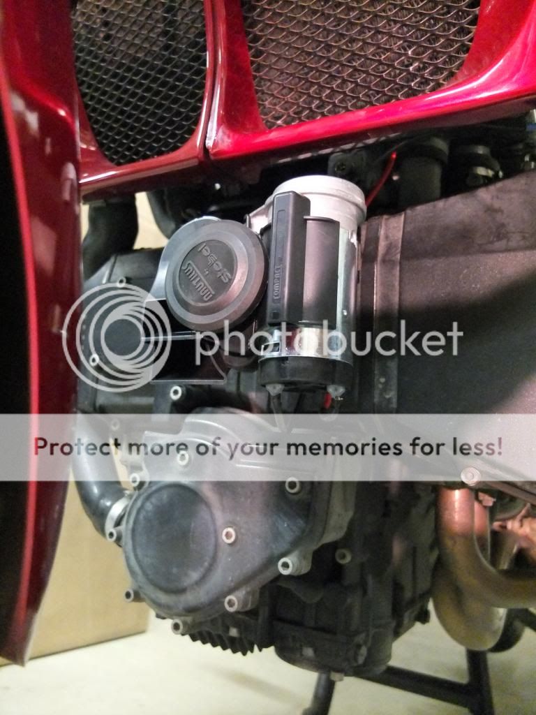

Installed the NASTIEST, LOUDEST, MOST ANNOYING Stebel Air Horn that I could find.  The wiring and the relay were interesting as well as the adventure of where to run the wires but it's LOUD.  Happy days!

How did you mount the horn?

Re: Stebel Horn mount.
From Stebel i purchased the horn and, for another $18 or so, a kit that had all the wires, the relay that was needed and nutsnbolts to mount is.  Total cost was about $85 if you include shipping.
On my K75 the horn hangs down below the radiator with a one-bolt mounting site.  The existing mounting plate for the stock horn is just three strips of metal with a hole in both ends.  The three strips layer together to make one thick strip.  Don't know why any old strip of thicker metal wouldn't work.  This horn fit perfectly with the existing mount.  I had to run a buncha wires back and forth to the new horn because the added relay needed added wiring.  The existing horn wires are used to send signal to the relay that THEN sends the juice to the air horn compressor.  No big deal.  The instruction for running the wires was VERY easy to follow, incredibly simply worded and they take you one little baby-step at a time.  I was worried about this part because I do NOT know wiring but it was cake.
The hardest part of this mount was finding a really good grounding bolt on the bike in a convenient but hidden place because i was too lazy to remove enough of the bike parts to get to the negative side of the battery.  the pos side was reachable but the neg side is tucked way underneath and I couldn't get a tool on it.
this sucker is loud.  halfway between the dual horns of a ferrari and a mack truck.  my wife doesn't allow me to erm...."test" it in the enclosed garage any more because it scares her AND the cats.  (which, of course for me is "fun" but i've now had my fun and will attempt to behave.  On the road though - all restrictions are off.
