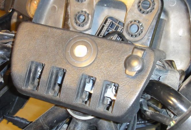

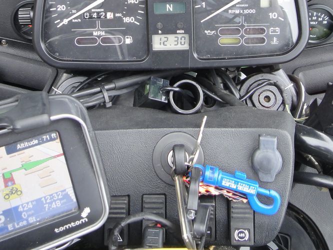

Since I don't usually run a tank bag unless I'm touring I hadn't noticed that using a square dash pad on K1100 forks where it mounts to the handlebar clamps positioned it down too low, making it difficult to use the switches with a tank bag on.

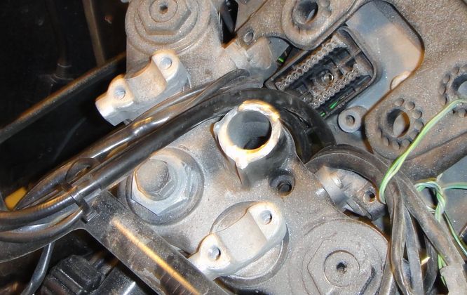

The mount for the K1100 ignition switch was going to be in the way:
So the first thing to do was to cut it off:

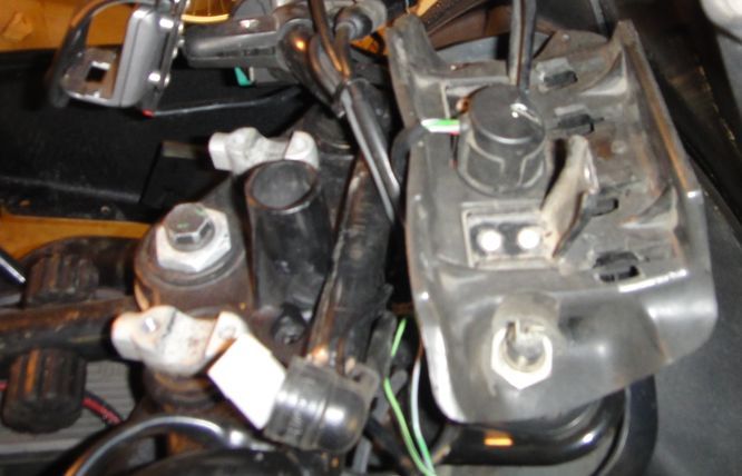

And then I fashioned an adapter bracket out of right angle aluminum bar stock and mounted it on the lower handlebar clamp bolts and also modified the dash pad's mounting brackets to bolt up to it:
Voila! Now the dash pad is up where it belongs:
