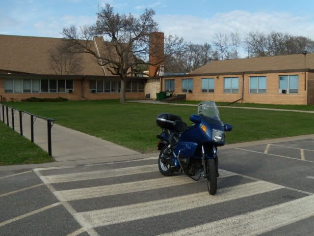

Finished putting everything back together after my winter projects.  And, got her back on the road!
First a quick trip to a local church parking lot for some figure 8's to get my sea legs back:
Then down the freeway and spent some time going around and around again, this time on a cloverleaf.  Everything seems to be working well!

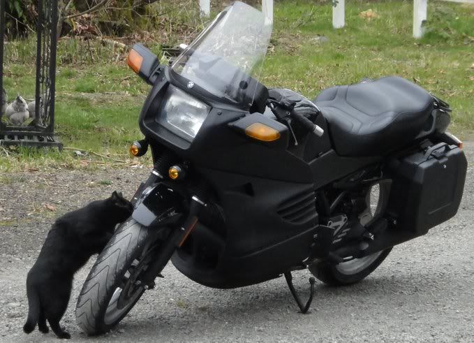

I had my brakes inspected today:

« Reply #207 on: March 25, 2012, 10:37:16 PM »
Izzat the famous Frankenbrick? Pretty dang Kewl. Cat inspector-dude matches yer paint job.

« Reply #208 on: March 25, 2012, 11:08:34 PM »
Lookin' good there, Wayne.  :2thumbup:
