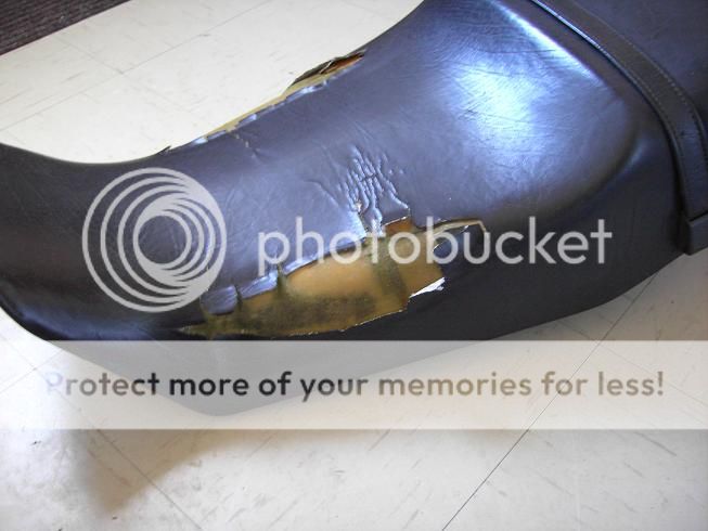

As for the seat, it had definitely seen better days...
Unfortunately, that's what happens when it lives outside - rain, snow, cold, heat and especially UV all contribute to hardening of the vinyl covering and then it splits on the creases when you sit on it.
Still, after a quick trip to town to visit the fabric/dressmaking/sewing shop to buy some new leather effect vinyl, followed by a bit of stretching and gluing I'm left with this:
I think it's a passable effort. Where the holes were in the old cover there is some wear to the foam which shows through the new cover slightly, but it's not bad at all. I may replace the strap at some point but I haven't decided on that yet.
This new material is a bit thinner than the original, and it's not 'rated' for external use so it's really not going to last as long as a 'proper' one, but it was £3.74 for a piece 140cm*75cm which is enough to do the seat twice. For that money I'll replace it every 6 months if I have to.
If I can find another seat base and maybe foam (keeping an eye on ebay etc. for a damaged seat) I'm going to have a go at carving a nicer shaped one. I'm happy to keep this one for the time being though.

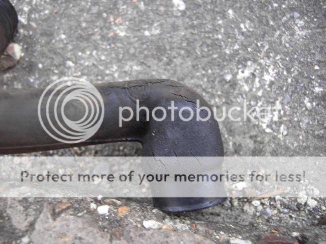

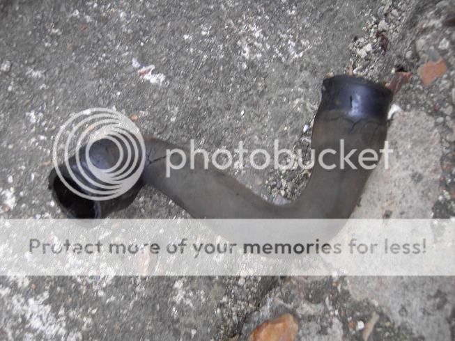

Expansion/radiator overflow pipe.
This had been 'repaired' previously using silicon sealant - this apparently worked for a while, but it's not ideal and anyway the pipe had come adrift from the expansion tank by about an inch or so.
I had a browse in the local car parts shop and the only pipe they had in the correct bore was fuel hose (it's labelled 5/16" and fits perfectly - just a bit of stretch). It's fine for this use, massively overspecced though being twinwall braid reinforced... Still, it's not going to pop!
Anyway, to get to the radiator cap I'm sure you're aware you need to move the fuel tank - rather than balance it precariously while leaving the fuel lines attached I decided to remove it completely. While taking off the fuel lines I noticed the reason behind the smell of fuel after running the engine:
Those splits and cracks go pretty much all the way through - the only reason the fuel was staying in at all was because the splits were being held closed by the bend in the hose when fitted. Both the supply and return lines were in that state right under the tank. A bit more of the same hose required then. This hose exceeds the BMW specs and is (I assume) much cheaper then buying the OEM lines - the only disadvantage is that it's not shaped/bent to fit and the BMW hose clips are too small as it's slightly larger externally (same internally, just thicker walls).
Seeing as I was working without a manual one bit was confusing - tugging on one end of the return hose didn't move the other end... A few more spanners to investigate.
Oh well...
The large pipe between the airbox and plenum didn't want to shift easily, so with a bit of wiggling I got the lower part of the airbox out so I could get to (what I discovered was) the fuel pressure regulator to swap out the hoses.
It's a bit awkward and a tight fit for hands and tools doing it this way, but to my mind it's easier than stripping out the plenum side - especially considering the hose clamps on the inlets are the crimped originals.
So, got new fuel lines run in - changed the routing slightly so it didn't kink on any of the bends. The bit going from the fuel rail to the pressure reg. 'looked' fine, but as I was there and had enough hose I replaced it anyway.
Then I got on with the original job of replacing the expansion tank hose! Again it needed a bit of creative routing - this time to account for the lack of clearance between the tank and frame rails.
I didn't take any pics of the new hoses - it really wasn't very interesting to look at. But, if anyone wants to see how I routed the water line to avoid being pinched by the tank it's only a couple of minutes to lift the tank and snap a pic.

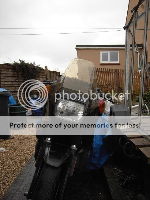

Right then, the windscreen/windshield/whatever you want to call it... A while ago someone tried to steal the bike but didn't notice it was locked up and dropped it. This took a chunk out of the screen on the left but fortunately didn't damage anything else (well, it mashed the end of the grip a little but I don't know if it happened then or not...).
While it doesn't really affect it, it looks bad (it doesn't look quite that yellow in daylight, it's a combination of artificial lighting and the background) - my thought was to trim down the screen to even it out. The line drawn on was me playing with the shape. Once I'd decided on the shape I wanted/could make I drilled a couple of holes to make cutting the plastic easier - if you've tried cutting one before you'll know just how easy it is to crack it using a saw...
Once drilled and trimmed, it was just a simple matter of filing and sanding the edges smooth and then fitting to the bike.
I think that looks better than when it was broken. I'd like to replace it at some point but finances currently dictate otherwise...
So, another free repair completed.

FYI: That's an aftermarket windscreen of some sort.  Factory one was narrower.

By terrible pics I was more referring to the quality of workmanship...
But anyway, I arranged to spend some actual money and ordered a new crankcase breather hose from the local BMW car dealership. Looking at it there's no sensible and easy way to get anything other than the OEM part in, plus it comes with a 2 year warranty.
As it's something most of you will have done, I'll take a picture of me doing it :tongue

I visited BMW yesterday and collected my new crankcase breather hose and managed to find 10 minutes to fit it today.
It was certainly time to replace it.
However, the cracks weren't actually the worst part of it...........
Hmmm, it was a bit clogged. I imagine this was caused by a combination of condensation and the water pump leak that was fixed by the previous owner. I cleaned out the plenum stub the best I could and I'll just have to keep a bit of an eye on it.
I didn't have time today, but I want to see if I can have a look inside the plenum at some point to see how bad that is too - the stub from the crankcase looks clean enough.
The first start-up with the new hose was a tiny bit more difficult than it has been up to now (I possibly pushed a bit of the sludge into the plenum...) but once it caught it was fine and has started just fine a couple of times on an errand ride since, seems to run a little better and doesn't hesitate like it did when cracking the throttle from idle.
So, a worthwhile job, even though doing it found more work for later :laugh still, that's what happens buying used...
