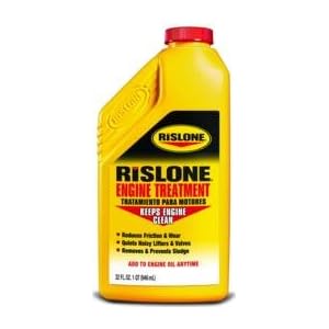

I can't recall where I have read it but, I have read about some others using some cleansing additive prior to an oil change. Like an extra detergent to help clean up the gum/crud from inside the sprags. Seafoam comes to my mind.
It may take more than one treatment to get it all, but it's easier/cheaper than a teardown.

Paul Glaves (top BMW mech guru) recommends Rislone for cleaning starter sprags.

Use an oil that is meant for diesel engines it will clean and keep clean the sprag clutch mechanism and the rest of the engine.
Works a treat.
