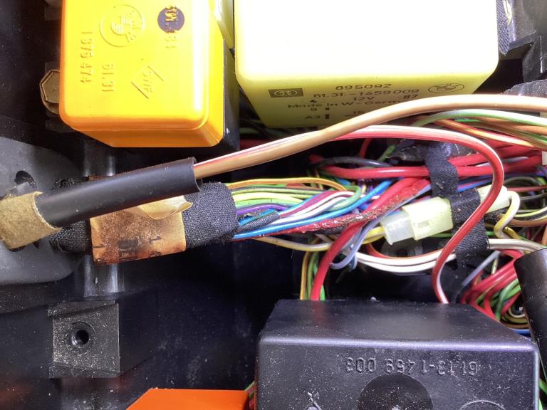

A red wire in the loom in the relay box had melted insulation.

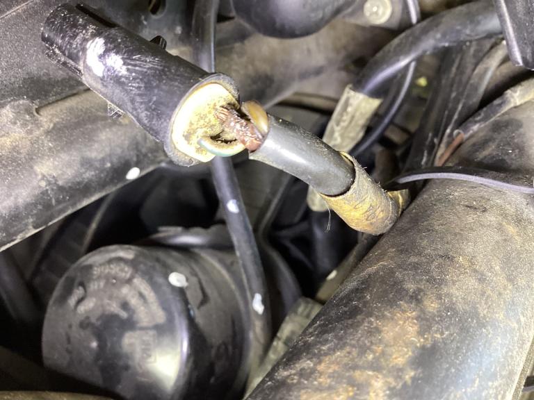

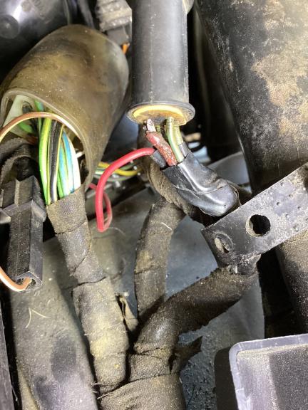

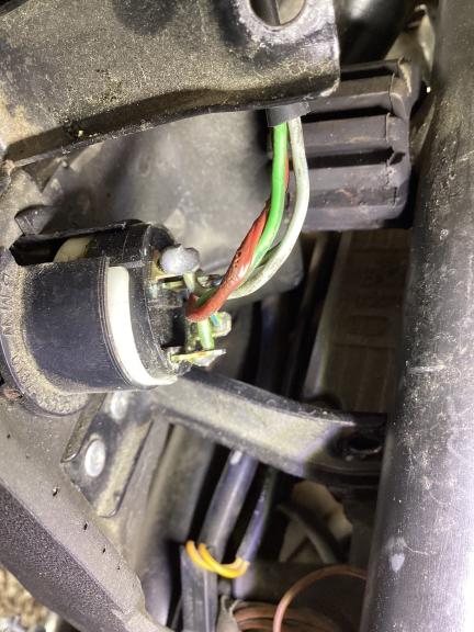

This wire went to the connector under the fuel tank.   Both parts of the connector show the same wire experiencing heat damage.  The wire going to the ignition switch was hot, and there is damage to one of the pins on the ignition switch.
My suspicion is the ignition switch was bad or a contact had broken on it.  I did have to carefully let the ignition switch and the pad it connects to dangle during my combo switch swap.  Maybe that weakened a connection on the ignition switch?

* wiretobottomconnector.jpg (52.63 kB . 432x576 - viewed 11 times)
* igswitchconnecttop.jpg (68.23 kB . 768x576 - viewed 11 times)
* ignswitch.jpg (47.46 kB . 432x576 - viewed 11 times)
* relay box.jpg (70.44 kB . 768x576 - viewed 11 times)
