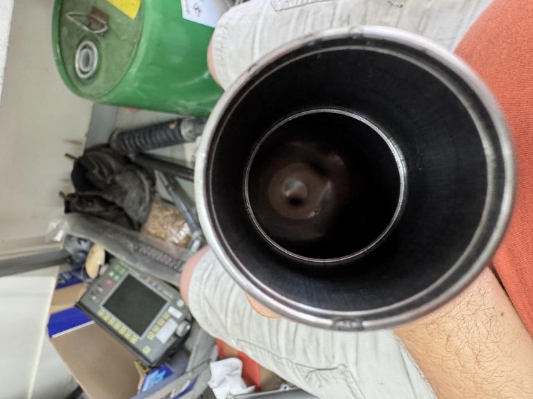

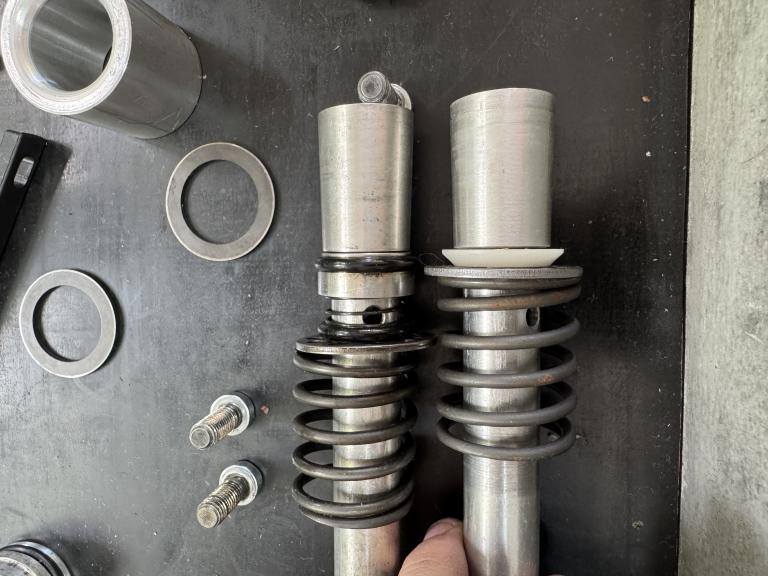

I started a suspension refresh on my 85 K100RT with progressive springs for my front forks and a new progressive rear shock.  I disassembled the forks and everything looks clean, and I would've thrown the shocks back together if I hadn't started tinkering to lower the front end.  I saw a video on Youtube of a gentleman cutting a section out of the stock delrin spring spacer and sandwiching it in the fork cartridge which increased the preload a bit.  In attempting the same thing, I galled up the piston not realizing it was locked on with the red Loctite!  I found some K100RS cartridges that fit the diameter of the tube, but the additional springs and hardware mean that the whole assembly doesn't seat all the way into the fork tube; it looks like the RS internals need another ~10mm or so bored out of the tube.  Could anyone confirm this dimension for me so that I can determine if I can modify my tubes to fit the RS internals?  Otherwise I'll use the bits from my RT and go back stock.
* IMG_0386.jpg (63.51 kB . 768x576 - viewed 685 times)
See the helper spring and additional hardware on the left (RS) unit, rather than the simpler tapered delrin washer and bypass valving on the RT unit.

Looking for the dimension from the end of the fork tube to the diameter where the cartridge bottoms out.  I believe I should be able to bore that to size at work, I just don't know how deep to take that diameter.

Thankfully the replacement internals look like a matched pair so I don't have to worry about a difference side to side.
I think I've missed a beat—not surprising for me lately. If the internals to which you refer are the ones in your opening post, tannerman, they don't appear to be identical. One has some different parts.
Yes Laitch, that's the comparison between my RT internals on the right of the image and the RS stuff I purchased on the left.  I have a matched pair of the RS internals, and the RT was identical as well.  I took that image to show the distance I am trying to determine is different between my stock stuff and the RS unit.
