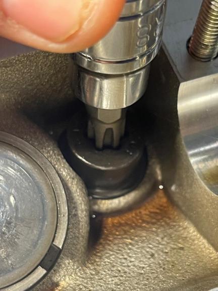

I'm currently working on my 1991 K100LT and I’m removing the cylinder head to replace the head gasket, clean everything up, and lap the valves.
I’ve run into a bit of a snag trying to remove the head bolts. I tried using a T50 Torx socket with a Milwaukee mid-torque impact wrench (rated at 600Nm breakaway), but the bolts didn’t budge. The T50 fits pretty snug, but I’m hesitant to apply more force since I don’t want to risk rounding the heads if it’s not the correct tool.
From the shape of the bolt, it looks more like a Polydrive/Ribe, maybe an M10, since the splines are more rounded than a Torx. I’ve searched online, in both the Clymer and BMW manuals, but haven’t been able to find a clear answer.
Does anyone know for sure what the correct socket is for these head bolts? I’d really appreciate any confirmation or tips on how you’ve removed them safely.
Photo of the bolt head attached for reference.
Thanks in advance!
— Ivan

  • BMW K100LT

Just wanted to thank everyone here for all the help and input. It really made a difference while I was chasing this down.
I just received a full Ribe socket set and tested each size carefully. The Ribe M8 fits the cylinder head bolt perfectly. I haven’t tried with the breaker bar yet (only with the Milwaukee mid-torque impact on max setting, and the bolts still didn’t move), but the moment I seated the M8 in the bolt, I knew it was the right one. There’s zero play. It fits like a glove.
In my opinion, this is strongly a Ribe M8 head. I’m 99.9% confident it’s the correct socket for the K100 cylinder head bolts. The only reason I’m not saying 100% is because I’d still like to hear official confirmation from BMW Group Classic, who I’ve contacted directly.
At first, I hesitated because the lobes inside the bolt looked unusually rounded (especially around the outer edge), and the socket seemed to have a slightly squarer profile. But after looking into it, that shape is actually part of the Ribe design philosophy. RIBE, just like Camcar Textron did with Torx, engineered these fasteners for use in harsh automotive environments where oil, dirt, and debris are unavoidable.
The slightly rounded outer area of the lobes is intentional. It creates space to allow debris or grime to sit without interfering with the contact surfaces. The actual torque transmission happens on the inner flanks of the lobes, where the tool seats securely. So even though it looks like the socket isn’t matching every contour, it’s only gripping where it’s designed to, and the outer roundness actually helps with self-cleaning and tool engagement, not hinders it.
Here's a photo of the M8 Ribe socket fully seated in the bolt. Again, thanks to everyone here. This forum has been incredibly helpful, and I’ll be sure to follow up once I hear back from BMW Group Classic.
* bolt 3.jpg (37.28 kB . 432x576 - viewed 1254 times)
