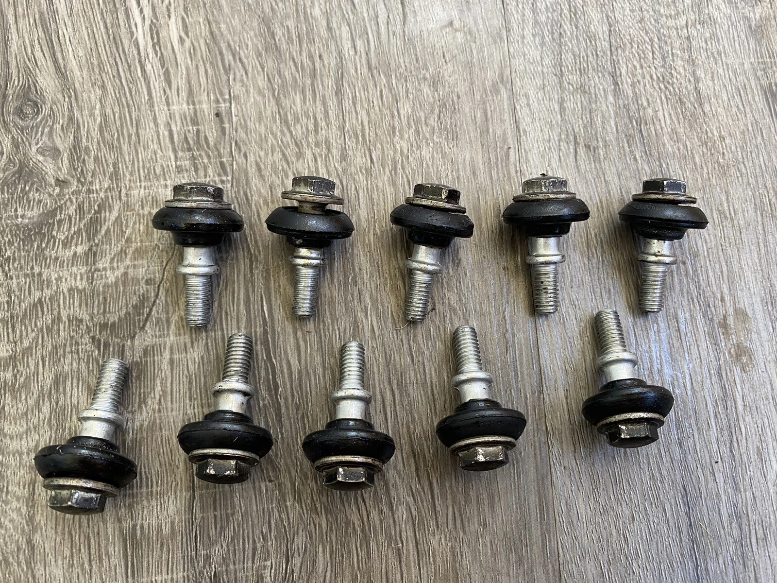

Im guessing i'll need to drain the oil before doing the valve clearances - are the rubber washers you mentioned on the outside, between the bolt head and the casing?

The gas cap is just a gas cap with nothing attached.
These are the washers for the valve cover bolts.

You don't need to drain the oil to check the valve clearances. The BMW K100/K75 2V repair manual downloadable from this site is at this link. It will help answer many of your basic questions. Download BMW's LE Jetronic training manual from the link in this post and learn how the 2-valve Brick engine management system works.
