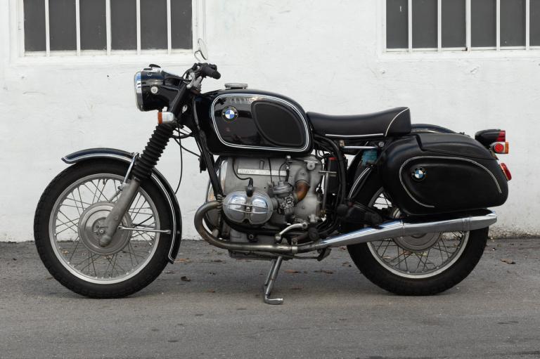

I’d just sold my 71 r75/5 after bringing it back from a circa 1980 slumber, having ridden it around for a year or so.

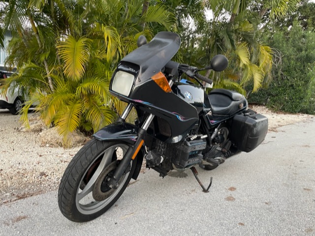

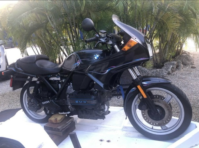

Lo and behold, delivered to my eyes was my next obsession: a derelict k75 down in the Florida Keys.
* C401560E-95E3-43E5-840C-0C50372E0966.jpeg (105.84 kB . 640x479 - viewed 2569 times)
Now, other life occurrences meant I have a shoestring budget (good for a derelict k75), no truck (bad for a derelict k75), and about a day to make this all come together. Compounding my sense of urgency, this bike was priced as if it weren’t in South Florida, where there’s got to be some rust tax that adds 1k to every asking price for some reason I’ve yet to fathom.
So the plan, as dumb as it is, is to go down and rouse the machine and.. ride it back. It’s only 80 miles, what could go wrong?
My better half and pup go down with me and my trunk of tools. Upon arrival, I recognize that pictures were kind, and salt air isn’t. Everything is crusty and rubber is a flimsy concept rather than a pliable material. If it were easy, though, it’d not be an adventure, right? ..at least that’s what I told my wife as she watched this calamity unfold.
All told, major items that were kaput:
Fuel pump and filter (expected)
Sending unit (was hoping it wouldn’t have lost continuity but.. darn)
Front master cylinder (frozen dry and filled with powder)
Front tire (valve stem rotten)
Rear shock frozen upon first compression
All keyed cylinders frozen (one key only, better be gentle)

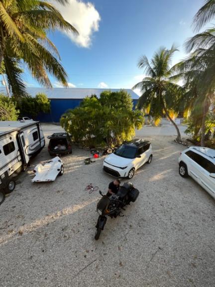

I replaced all the fuel lines, the overflow reservoir line, and hit the magic button. Off we went. Wife following me, we took our sweet time and turned an 80 mile trip into a 2.5 hour amble (then again, the Keys are generally 45 mph, so it wouldn’t have been terribly different under normal circumstances, either)
After exactly no real drama, other than some fueling misbehavior at the very end of the ride after an hour of freeway, the bike is in its new home, safe and sound. And the process of correcting hack mechanic work and the ravages of time begins.

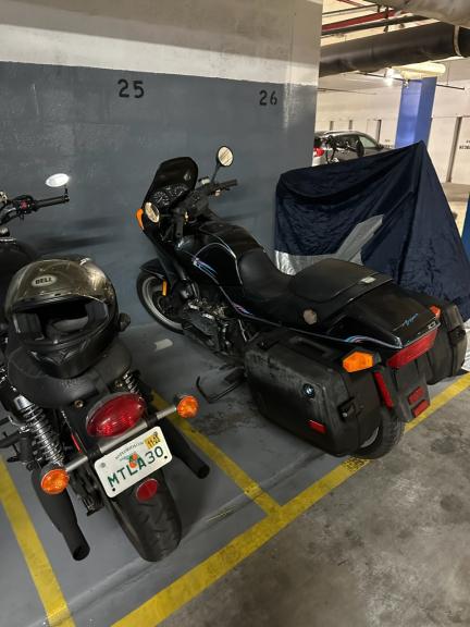

Offline Kt88
  • Posts: 25
Re: 92 k75s and a particularly dumb idea
« Reply #15 on: November 28, 2023, 10:31:32 PM »
Managed to re solder pump supply wires through the sender, so now nobody would be the wiser from the outside that the fuel delivery system has been hastily replaced.
The front master cylinder, while freely moving, is not holding pressure- or even generating it, for that matter, just bubbles- so I’m now shopping for one in usable shape or at the minimum worthy of a rebuild kit.
I’ve started replacing bulbs to get the bulb indicator light to relax a little upon startup. Those connections still seem pretty intact, but the PO’s alarm system is tied into almost every single part, including all the marker/blinkers. I’m a bit hesitant to just start pulling it since I imagine it’s protected against that method somehow, but I will absolutely do it before any big miles.
Once the front brakes are happy, then it’s time for new tires- open to recommendations there- full spline service, and flushing all fluids stem to stern.
Oh, and the plastic fairing support is cracked all the way through. It’s held together with tape at the moment. I’ll replace that, too.

One of the nicer bits about living in Miami is that I essentially have year-round riding. Does wonders for seasonal depression, but also does make every project a living one, as opposed to a winter disassembly as I’m used to.
Nevertheless, I’m persisting. It’s awfully rough on me, as you can probably tell.
Tags came in yesterday, and using the bike as my primary transport is now underway officially.

I’ve got some more cosmetic cleanup to do on the old headlight glass (yellowed and foggy), the fairing attachment, and the glazed windshield. I may use this to justify buying a random orbital buffer.
