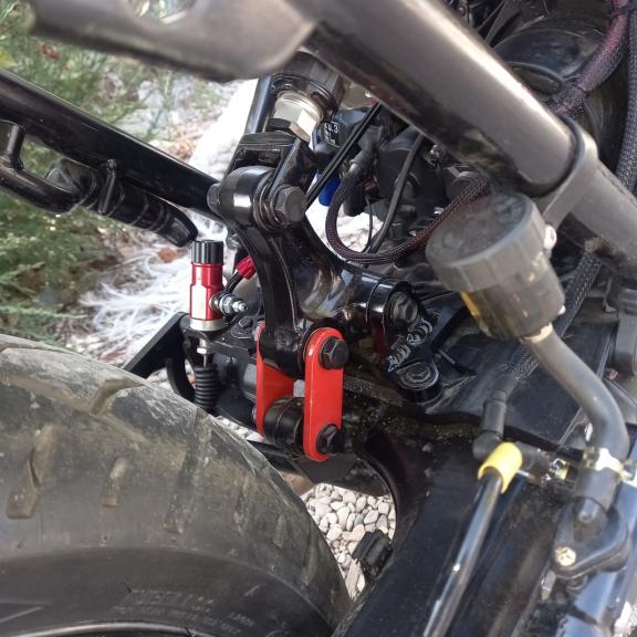

Who designed the central shock absorber system and its lower mount? Is wheel travel the same as with the original set up?
  • 1995 K75 89,000 miles
Offline ManX84
  • Posts: 15
Re: My baby was born !
« Reply #3 on: August 20, 2023, 04:52:24 PM »
I design it, this is experimental  :smoke1
I made some simulation with Fusion 360.
I design and made aluminum parts for the lower mount.
(the rocker come from a sport bike)
And a professional melt it with TIG.
shock absorber itself is an YSS with a specific spring ( I bought 3 to find the one)
not sure same travel, but it work very very well!
