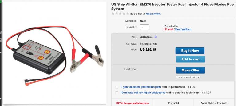

Need:
- Fuel injector actuator (sold as an injector tester online, $30 generic connector - $60 with injector plug).
- Carburetor cleaner or similar fuel system solvent, several ounces + a pressured can with a small straw-like attachment

Injector electrical actuator:
https://www.ebay.com/itm/US-Ship-All-Sun-EM276-Injector-Tester-Fuel-Injector-4-Pluse-Modes-Fuel-System/252990688970?epid=10028399003
* Screen Shot 2019-02-09 at 9.46.16 AM .png (31.6 kB . 768x347 - viewed 1347 times)

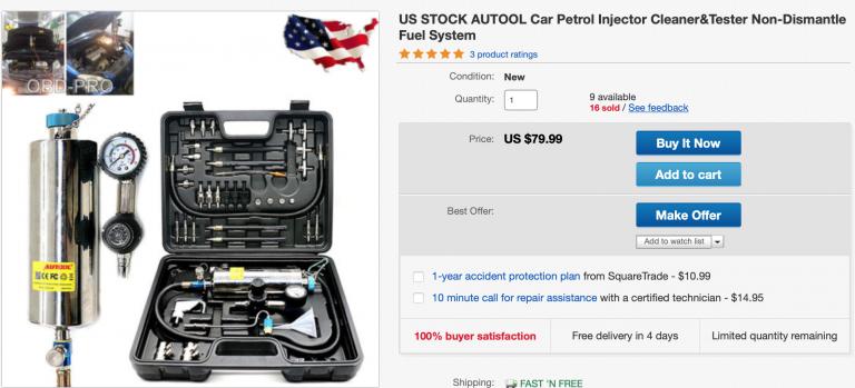

For $60 more, you can buy an injector cleaner kit that includes a metal container you fill with cleaner, pressurize, and attach in place of the fuel line on the bike. This can be used to leak down/ flow test and match individual injectors if you want.
https://www.ebay.com/itm/US-STOCK-AUTOOL-Car-Petrol-Injector-Cleaner-Tester-Non-Dismantle-Fuel-System/223134514003?epid=8002679867
* Screen Shot 2019-02-09 at 9.46.49 AM .png (44.06 kB . 768x349 - viewed 1426 times)
