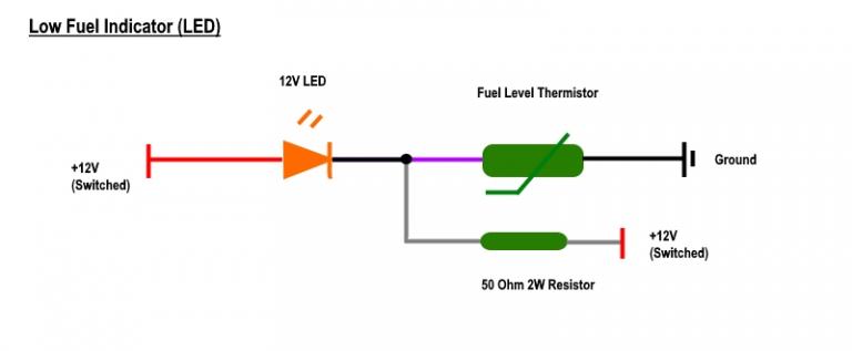

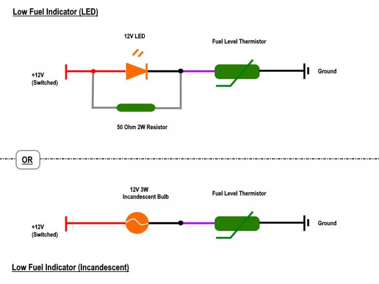

Offline DEcosse
  • Posts: 28
Re: Question about circuit for Low fuel warning LED
« Reply #11 on: December 05, 2018, 03:18:17 AM »
Happy to help
* Thermistor_Indicator.jpg (26.73 kB . 768x576 - viewed 942 times)
Upper section as described above - yes, you would use a '12V' LED.
An alternative solution is to use a 12V incandescent bulb which negates the requirement for the resistor - you can probably find a fairly small incandescent lamp fixture, although not quite as compact as an LED - be sure it is about 3W of power though in order to ensure enough current through the Thermistor.
Both indicator components are doing the same job - they not only provide an actual indication, they also pass current to the Thermistor.
In the case of the LED, its resistance is quite high, so the parallel path of the 50 ohm resistor supplies the required current.
The current through the resistor will be 'trying' to heat the Thermistor - however as long as it is submerged in liquid, the heat is dispersed away; however once it becomes uncovered, the device WILL actually heat up and when it does that its resistance drops accordingly- That is the whole premise of a Thermistor, its resistance is governed by its temperature - similar type of device is those use for measuring Air or Coolant temp but those are being governed by EXTERNAL temperatures applied rather than being internally generated by the very current through them. .
SO - consider the series path of the illuminating device and the Thermistor in series as a voltage divider:
(for this purpose consider the parallel combo of the LED and the 50 ohm as one segment of that chain)
e.g. if the source is 12V and IF the resistances were equal (they're not! - just for illustration)) - then the voltage across each would be 6V;
If the resistance of the Thermistor was 3 times that of the Indicator, then you would have 9V across the Thermistor and 3V across the Lamp (etc)
i.e. When the resistance of the Thermistor is much higher than that of the bulb (or the LED//50 ohm) then the voltage across the Thermistor is much higher than that of the bulb;
so in that circumstance the voltage across the bulb (or the LED//50 ohm) is quite small (relatively to source voltage) so does not illuminate.
However once the Thermistor is uncovered and begins to heat up, its resistance drops and thus so correspondingly does the voltage across it;
as the voltage across the Thermistor drops then the relative voltage across the lamp INCREASES (there will always be 12V across the series chain) - so the indicator lights!
Hope didn't over-complicate that with the explanation!!! :D
You can try this for yourself in a bath before you actually physically install it.
As far as the actual install, although the diagram shows the resistor apparently directly across the LED, it does not have to be physically there.
Indeed, the resistor can have a termination of the 'power' end at any switched source on the bike - as long as the other end is connected to the junction of the Thermistor and the LED.
