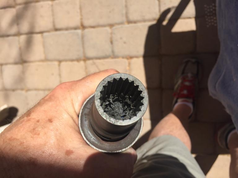

I've got two K75's and I've service the Driveshaft on both a couple of times.  We all know the  drill, not really complicated, takes a little time but, well worth the effort.
I recently bought a third K75, a 1994 "C" model. The bike has just over 100K miles but ran deciently, had a lot of the parts I was looking for to bring back one of my other bikes.
  I decided I would pull the final drive and take a look at the drive line.
   It diidn't look too bad, not perfect by any means but not horrible either,
* IMG_3696.JPG (32.63 kB . 768x576 - viewed 609 times)
   Not bad for 100K.

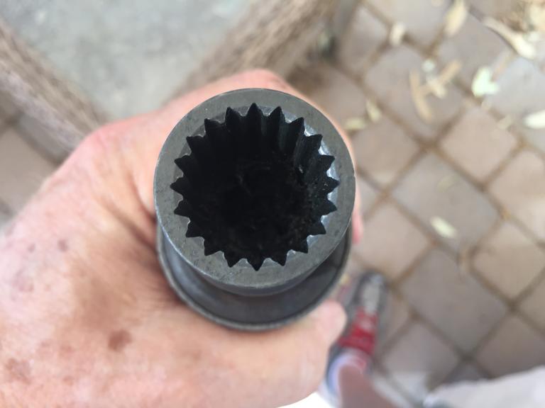

   While cleaning the splines for this picture I noticed there was something inside the driveshaft that would not allow me to insert the brush I was using more then about 1 and a half inches into the spline area.
   Here is what I found.
* IMG_3698.JPG (38.81 kB . 768x576 - viewed 574 times)
   It appears that some one plugged the end of this shaft with some type of silicone, or some such material.
I saw a Chris Harris video sometime back where he was talking about cutting a drive shaft to insert a silicone plug to keep spline lube in the splines rather then allowing it traveling up the shaf. then welding the shaft back together.
   I don't see any evidence the shaft had been cut and welded.  I'm trying to figure out how this was accomplished.  I stuck screw driver inside the shaft and the silicone feels solid.
   So now I'm wondering if someone filled the entire shaft with silicone?

« Reply #3 on: August 29, 2018, 11:39:11 PM »
its a petty safe bet that the silicone was placed there from the open end, so there no need to cut the shaft

« Reply #5 on: August 30, 2018, 07:34:04 AM »
I agree, it had to have been put in through the open end, but how did they form it to make such a solid plug without filling the entire shaft with silicone?

« Reply #6 on: August 30, 2018, 07:41:49 AM »
maybe push in a sponge or dowel then silicone over the top of it
i think ill do it to my bike next time its off
i spose you want it light and evenly spread so its not too unballanced
i think i saw on youtube that some weld a washer in or something like that

« Reply #7 on: August 30, 2018, 07:50:03 AM »
maybe a welch plug or soft drink bottle cap, ill be keeping an eye out now for something the right diameter
do you know what the diameter needs to be
