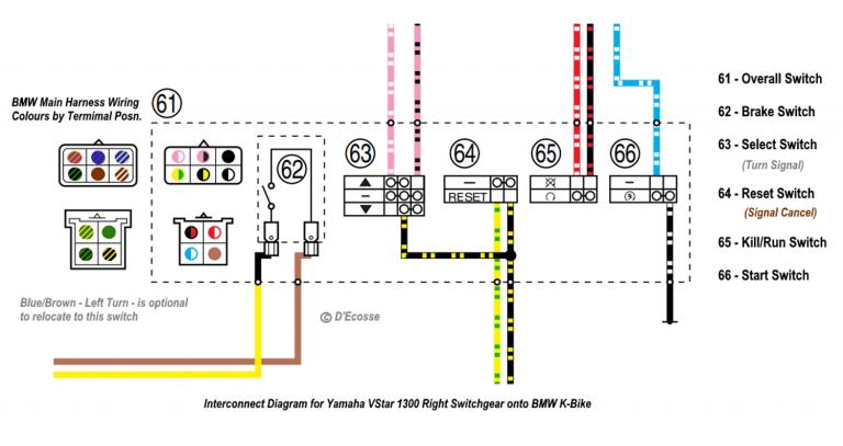

And also, the reason for wanting to stay with stock switches is because of my limited wiring experience. But hey....now is probably the time to change that.
I can help you with that:
Here is the wiring diagram and function of that Yamaha Switch assembly - even has the wire colours by terminal position in the connectors!
I have even updated it with the corresponding wire colours for the BMW in the appropriate mating connector positions
(the attachment gets reduced in size - if you decide to go this route send me PM and I'll send you larger image and more detail on the wiring colours/connector positions)
And here are the connectors you would need (simpler to replace the BMW ones and just plug this in as-is)
