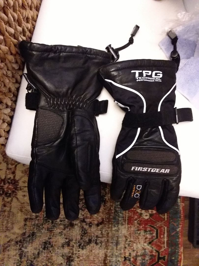

Here you go.
Insulated back,  thin palm.   I wear them down to upper twenties temp with heated grips on k75s and k13s.

Here you go.
I like 'em!

Here you go.
Firstgear makes some fairly decent gloves for the price. I have a older version of them and they not only hold up well but very comfortable. The fact the insulation is more padded on the top is really helpful. One thing for sure, the handguards that came with my K75S help out. I think these might be it:

Here you go.
Sweet!!!  Just what I've been looking for.  I have a First Gear touring jacket and find that their stuff is very well made.
