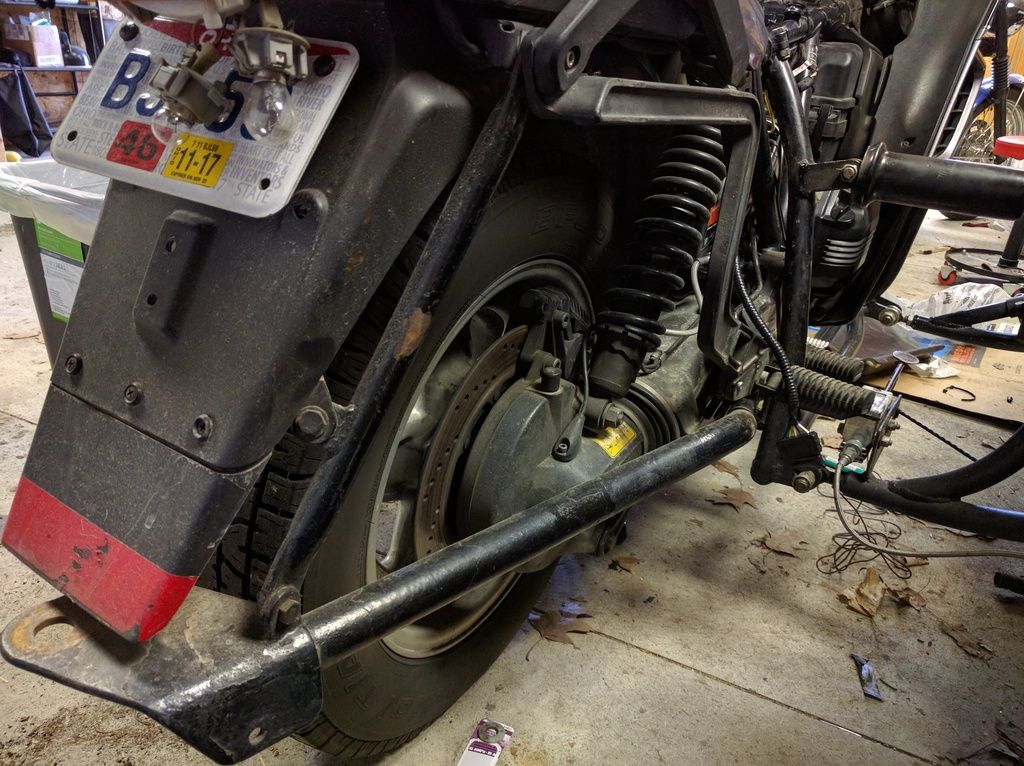

Is there a chance you could take a picture of where the various bracket mount? Or even sketch it out and post it? Doesn't have to be drawn to scale or a CAD drawing or anything. The main bar is the least of the problem. The sticky bit in fabbing it up is knowing where all the other parts connect. Definitely easier to not re-invent the wheel.

« Reply #7 on: April 17, 2017, 09:32:40 AM »
I'll get some pictures of it this evening when I get home. It appears to be a Reynolds hitch that the installer of the sidecar welded a tab to. If the tab wasn't welded to it, I'd just take it off and give it to you. Anyway, I'll post pictures later.

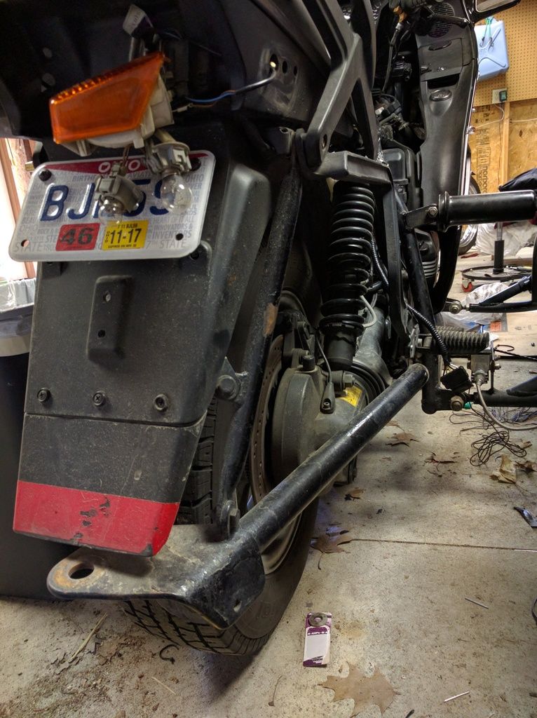

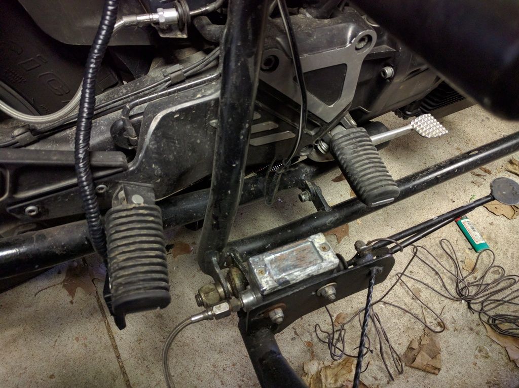

« Reply #11 on: April 18, 2017, 12:20:00 PM »
Here you go!  :euro

« Reply #12 on: April 18, 2017, 02:43:51 PM »
Thanks very much. I appreciate you taking the effort to do this.
I have a couple of questions:
1. It looks like it mounts to the rider's peg? Or does it mount to front and rear peg?
2. Where does the bracket go that is up behind the rear fender? About half way up is a bolt that looks to attach to something else.
3. Are there any brackets that go under the bike? I had heard that there were but hard to tell from the pix.
