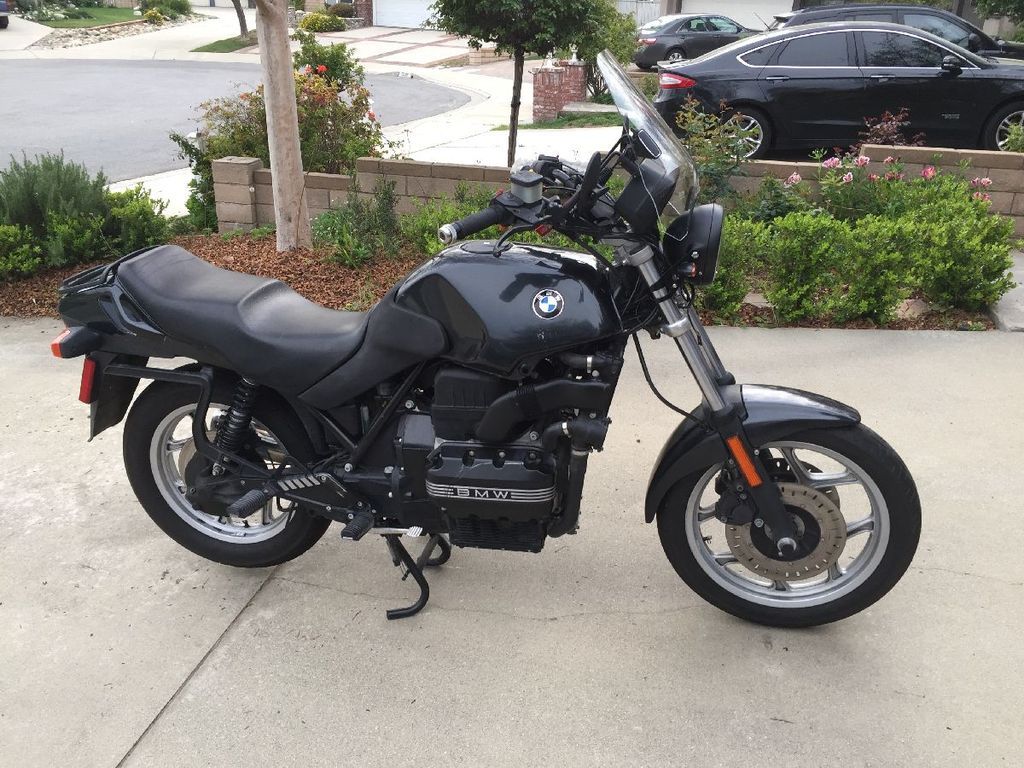

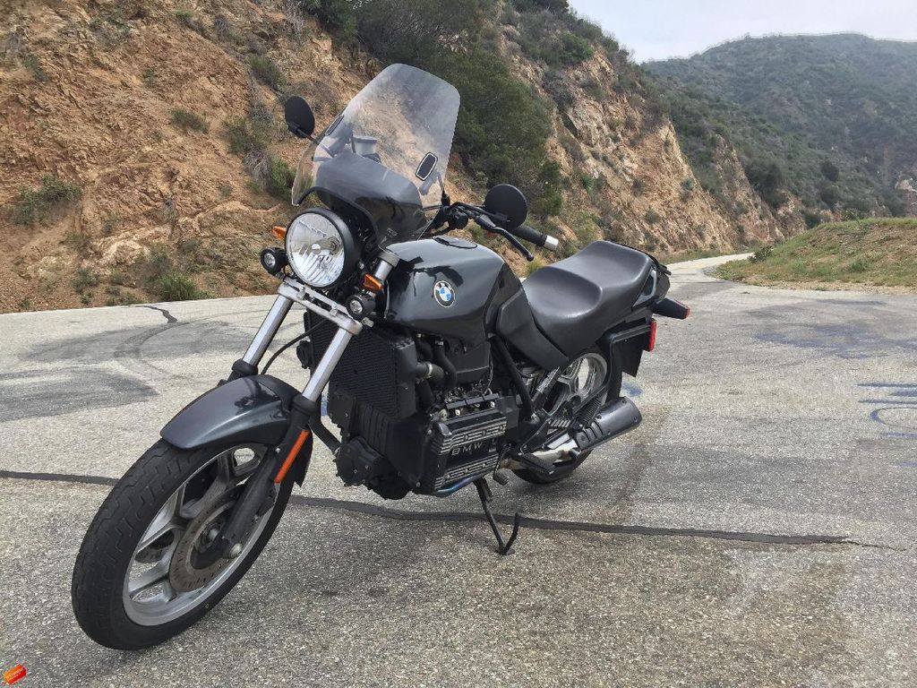

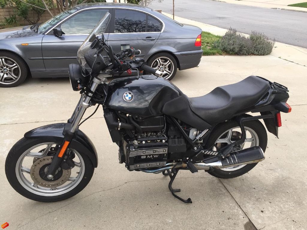

Good afternoon everyone. I just though I'd share my story since I'm new to all of this. I just purchased a 1991 K75 RT with 50,000 on the clock. I knew I loved this bike, but the RT fairings quickly proved to be too much for me visually and on the scales. I've spent the last 3 weeks stripping it down and putting together a lighter setup for myself.  In reading several threads here I'd like to point out that I was able to slim this guy down and install new running lights, headlight, windscreen, signals, mirrors all for a total project cost of about $330 at this point. It can be done with a decent amount of quality without breaking the bank, thank god! I'm very satisfied with how everything's turned out. Cheers, happy riding all!
Before:
Removed:
After:

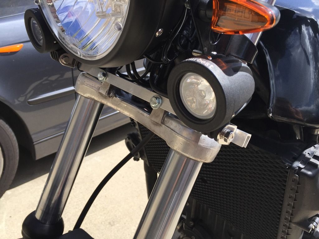

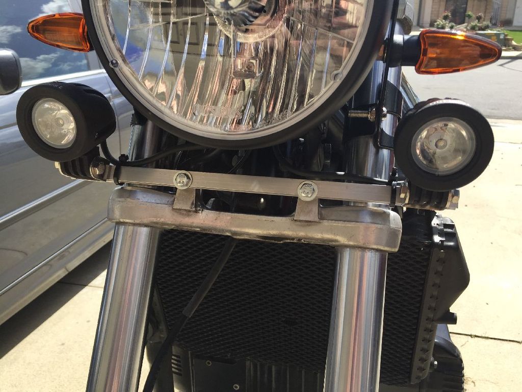

Well done, Garrett. Please post some closeups of the driving light mount when you get a break from enjoying the weather.

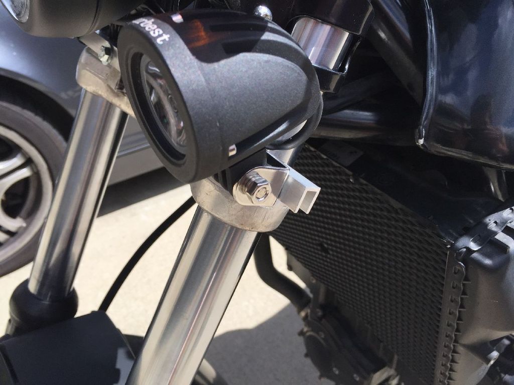

Thank you all. Laitch- Below is a closeup, up the running lights. Just a simple $4 piece of angle aluminum from home depot, drilled 4 holes, and mounted to the two holes on the fork cross-bar.

Thank you, Garrett, for the photos and explanation.
