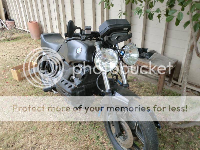

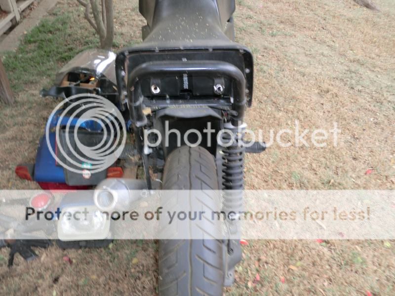

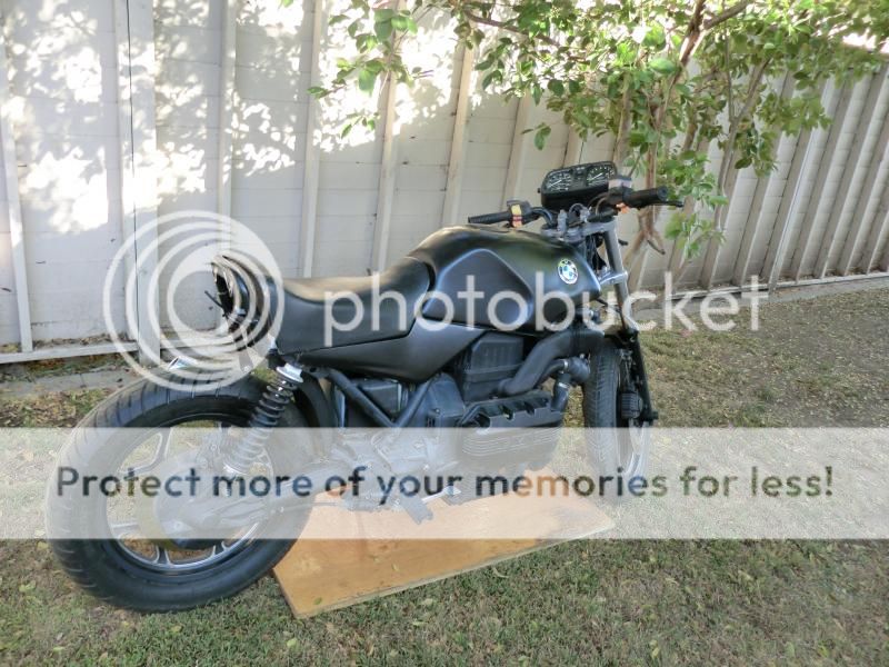

Hey guys, I've been stalking around on this forum for a little over half a year now, but am finally in a position to possibly purchase my first K bike. I've read about what to inspect on K bikes in person, but I am just looking for someone intimately familiar with K75s to take a quick look at these photos and tell me if there is something obviously wrong other than the lack of dignity.
I'm not too sure what's going on with that bar behind the seat  :dunno2:

I guess you're aware this bike has been heavily modified from stock to be a cafe racer style. The bar on the back is where the PO hacked thru the frame that supports the rear cowl to remove it and the fender assembly. I hope you live in a drought-stricken area or at the first sign of moisture you're going to give new meaning to the term 'wetback' -- no racial overtones intended...just the having of a wet back.
Hard to say if there's anything 'wrong' but there's definitely a lot of stuff 'missing'. Looks like there's a lot of rattle can black paint, too, hard to tell from the pics. I guess the question would be -- what's your intention with this bike? Keep it as a cafe or modify t further?

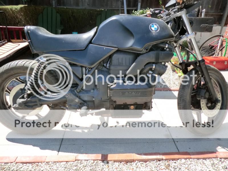

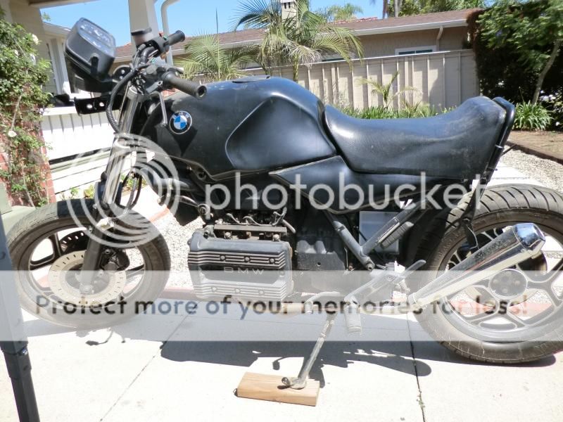

Here is the left side

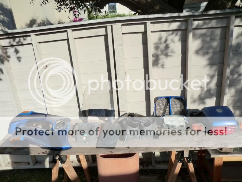

Here's the pile of parts

Go on ebay and check out what k75 parts are selling for. You'd make $800 on the drivetrain alone, assuming they're reasonable shape. And even if not, all those body parts, valve and crank cover, TPS, alternator....the list goes on and on. If you have a garage build some shelves and go to town.

The plastic may be the most valuable parts there.  K75s front blinkers can go for $70 each, the belly pan for a $100, etc.  This bike really shows the difference between custom builders and butchers.
