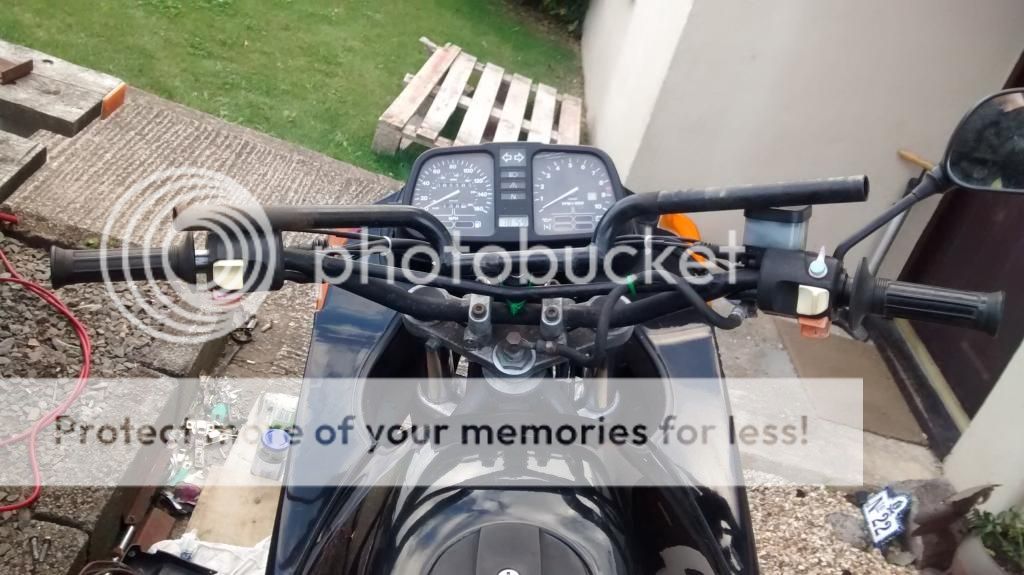

I also have slightly wider handlebars too (originals are sat on top for comparison):
