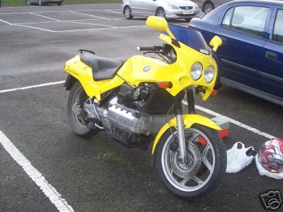

As promised, here are a few pictures I took right after I brought the bike back.
Needless to say.... I was a pretty happy camper....
As you can see from the second pic, the bike has been down (replaced left side fairing, missing side covers, etc.) but judging by the scratches on the exhaust, he wasnt going too fast when it happened.
Two days after I got her, I had a week long conference out of town, so I just now have the time to really dive into the project. While I was out of town, I couldn't help but order a few parts including some strap-ons bars (hopefully the 41mms fit...), bar end mirrors, a side-mounted license plate holder, a clymers manual, and a 12K service kit from beemerboneyard. Ive got a tough decision to make regarding the headlight - I want to go for something different from the plain white bulb - and the seat.
 For now, however, the first order of business is taking off all the extra plastic to see what I have to work with. After that she'll get a nice thorough cleaning under the California sun and I'll start wrenching. Still looking for a set of tools that wont break the bank - while I have some general stuff, I'm already running into problems with my allen wrenches not fitting the screws that hold the saddlebags on and am sure there will be more like this the futher into the project I get.
Can't wait to get started tonight and I'll be sure to keep everyone updated.
-Jack
