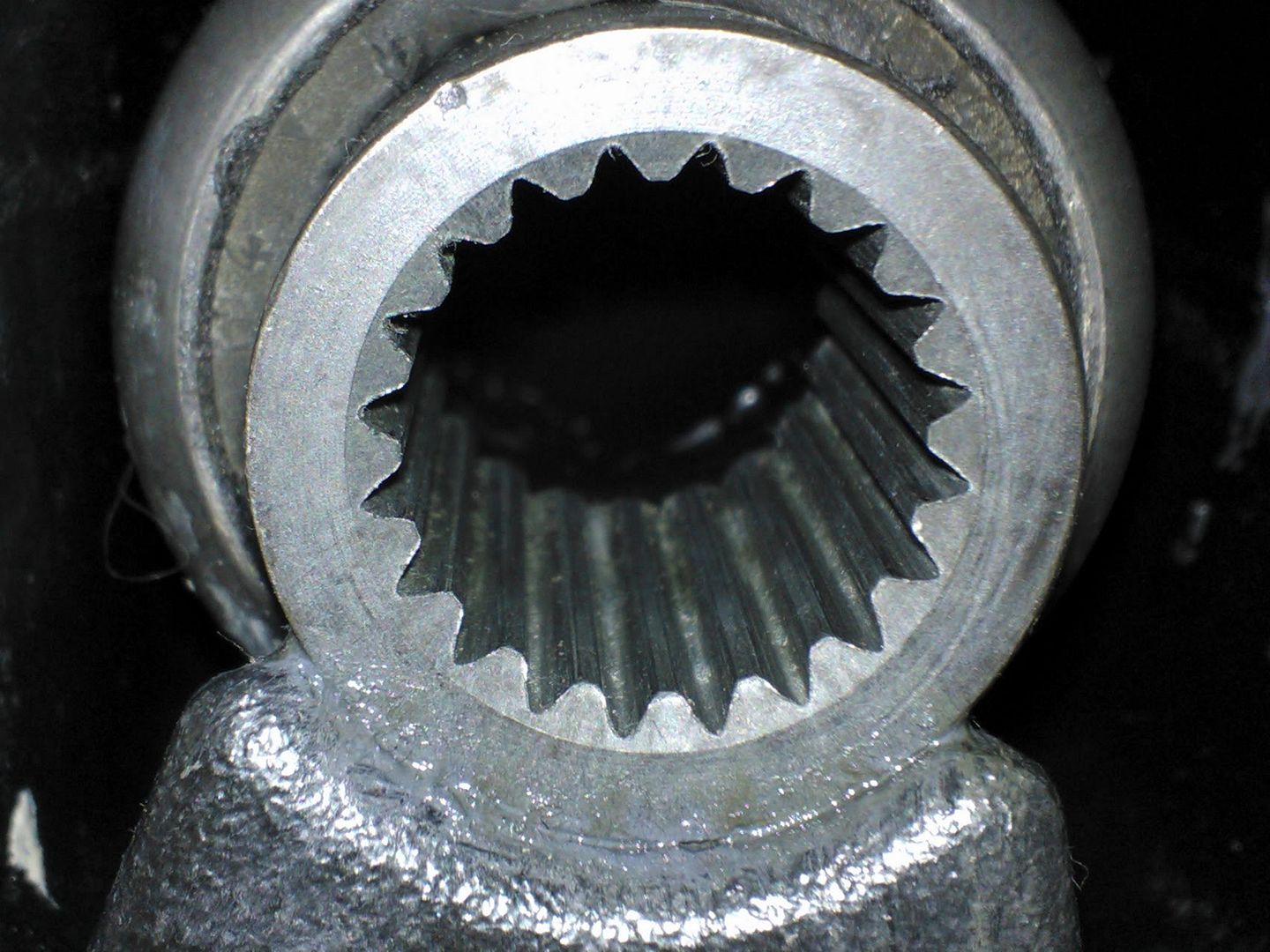

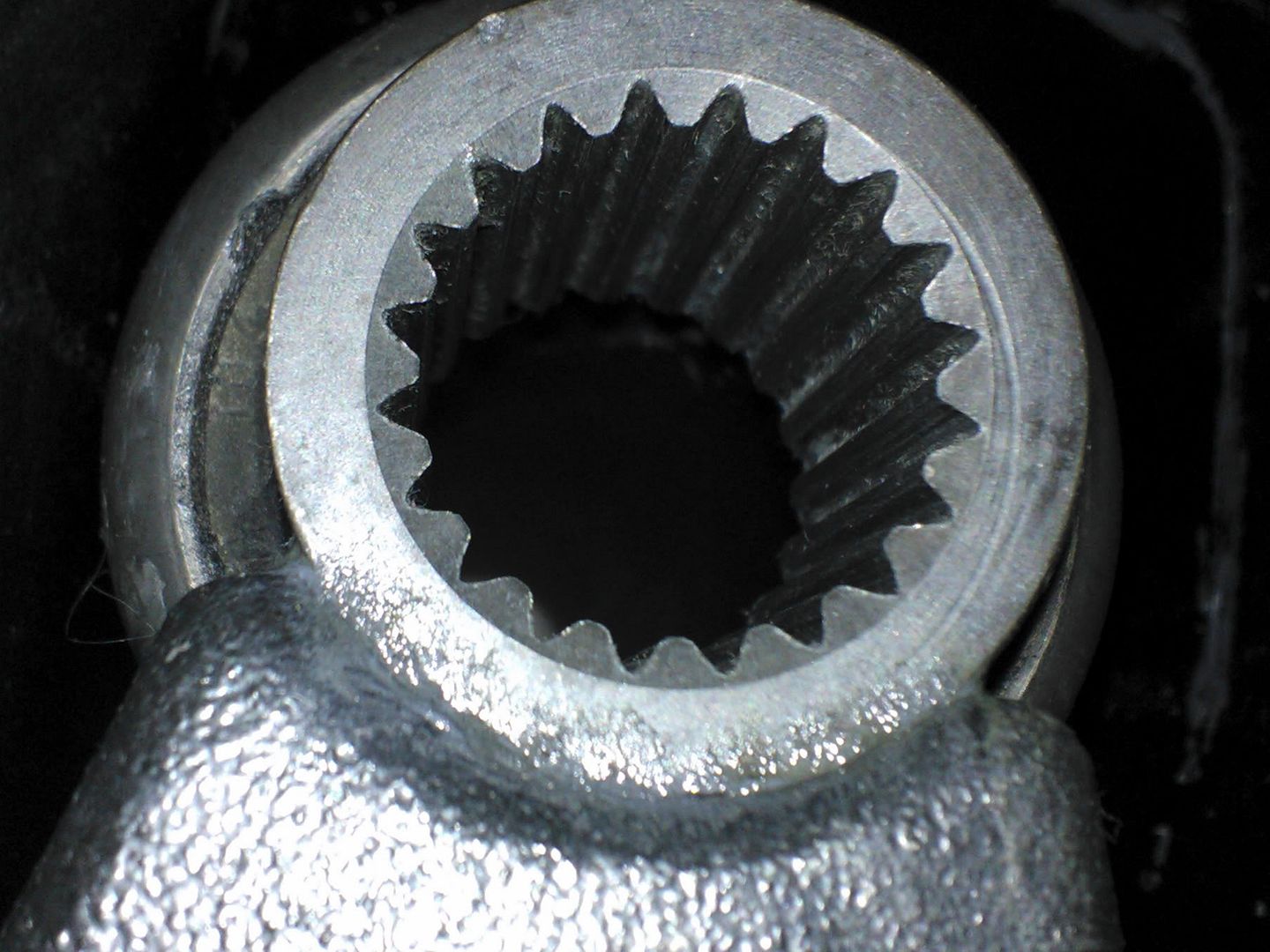

After rebuilding the oil pump and generally poking around cleaning things, I finally got around to beginning the spline journey and made it through final drive removal. Duck, you're latest write-up on the process is awesome.

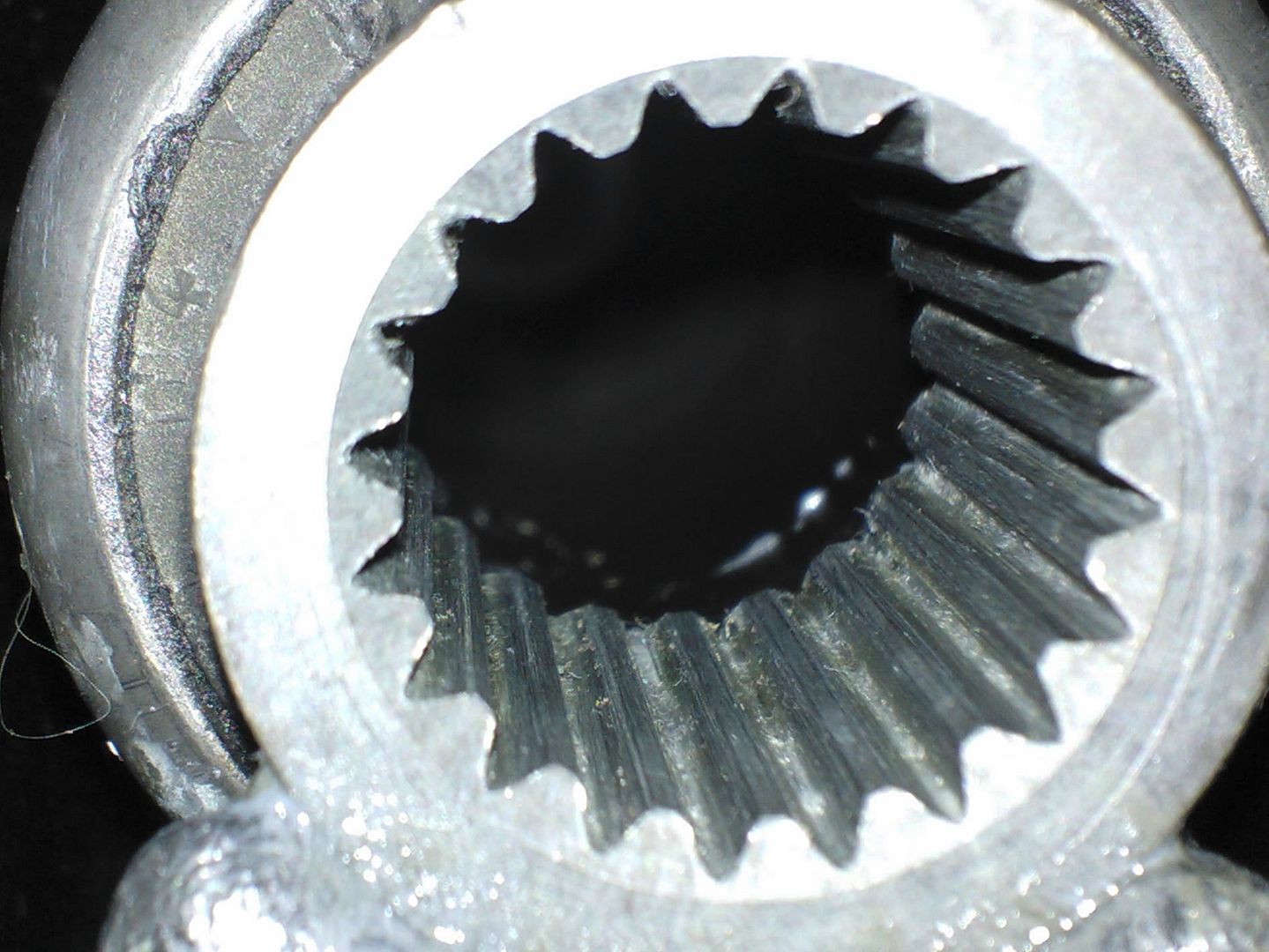

Splines in the FD look good and this end of the drive shaft seem decent.

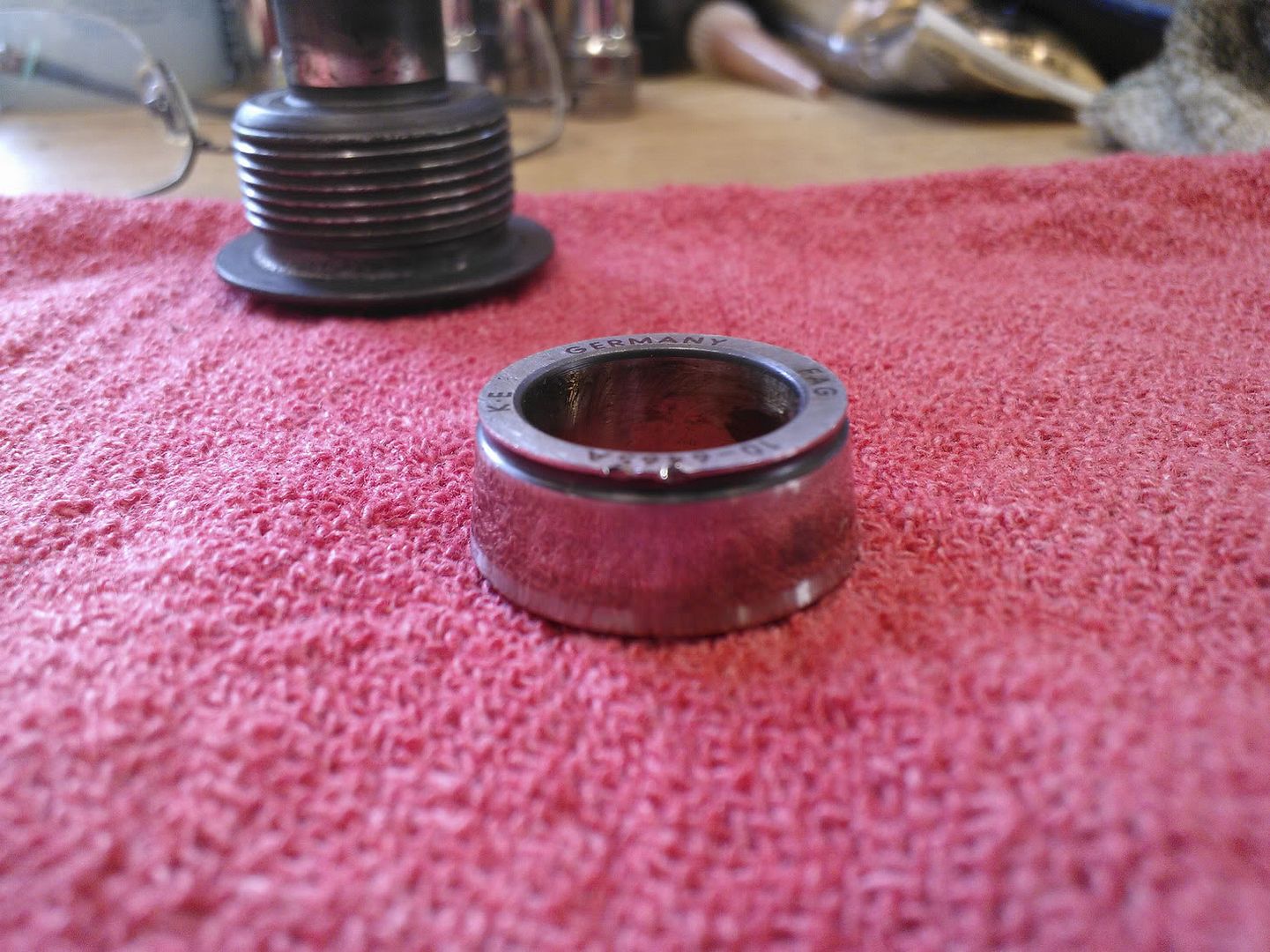

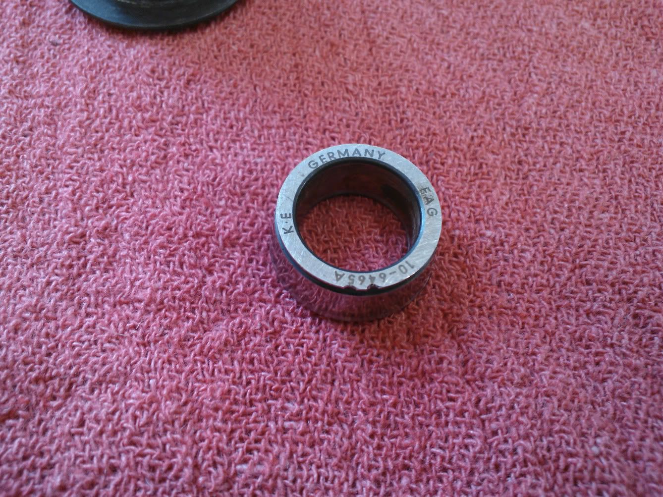

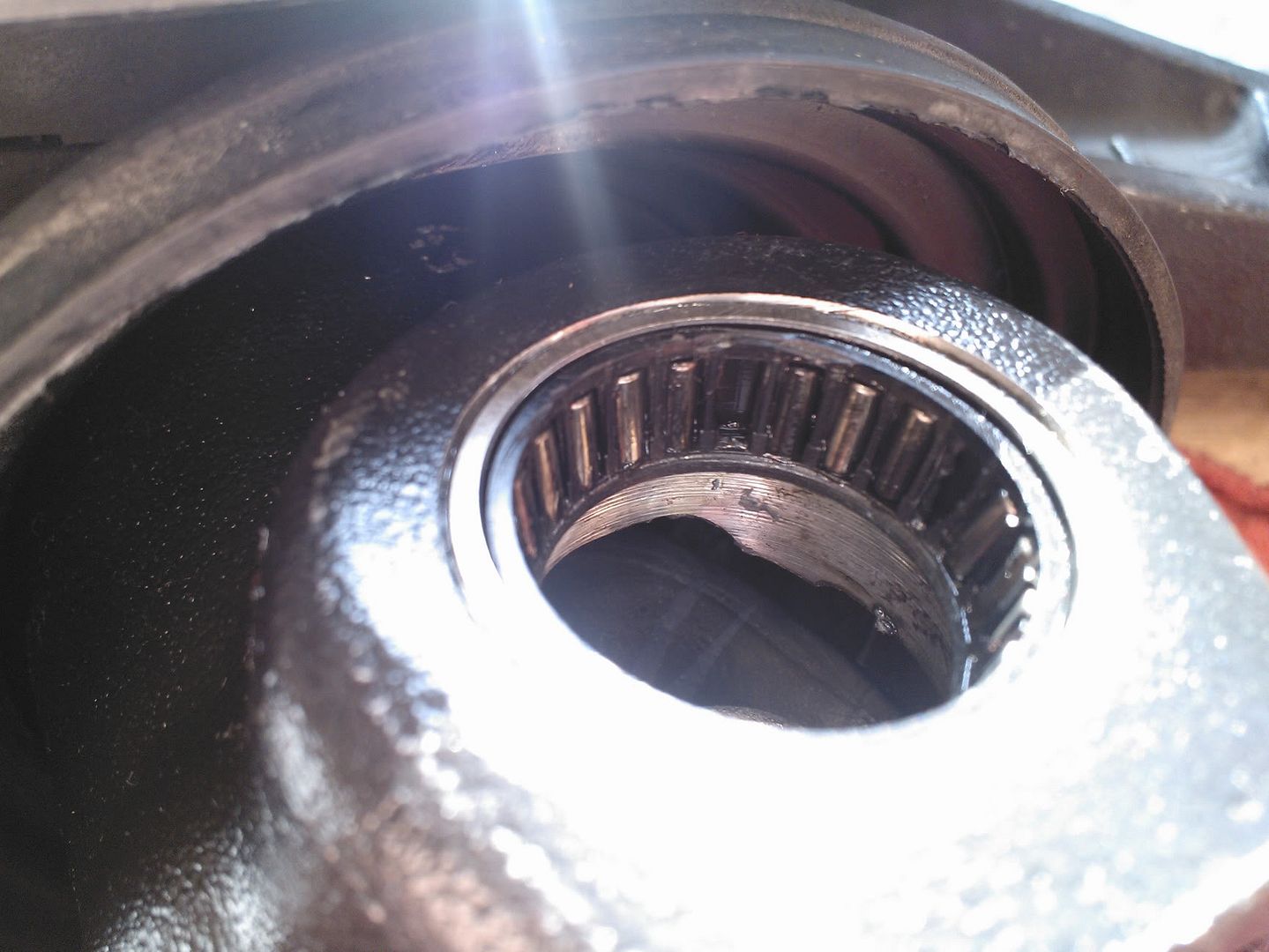

2 items were encountered which I think officially qualify as problems to be addressed. Left side bearing race has a couple chips on the inner edge.
I suspect the chips may have been caused by 2 roller bearings from the assembly exiting their assigned seating without permission (@ about 12:00 and 2:30 in the picture).
Does rubberchickenracing make bushings for the FD pivot as well as the swing arm or maybe stock replacements are sufficient?
Also, could folks weigh in on the apparent wear on the left side pivot shaft?

I tracked down some replacement bearings that are about half the price of BMW parts. They are super heavy duty bearings (OEM and Replacement), way over needed spec, and there is no reason to go to bushings for the swingarm pivot.
The rubber chicken racing bushings sound pretty good. Need lubed and adjusted though.

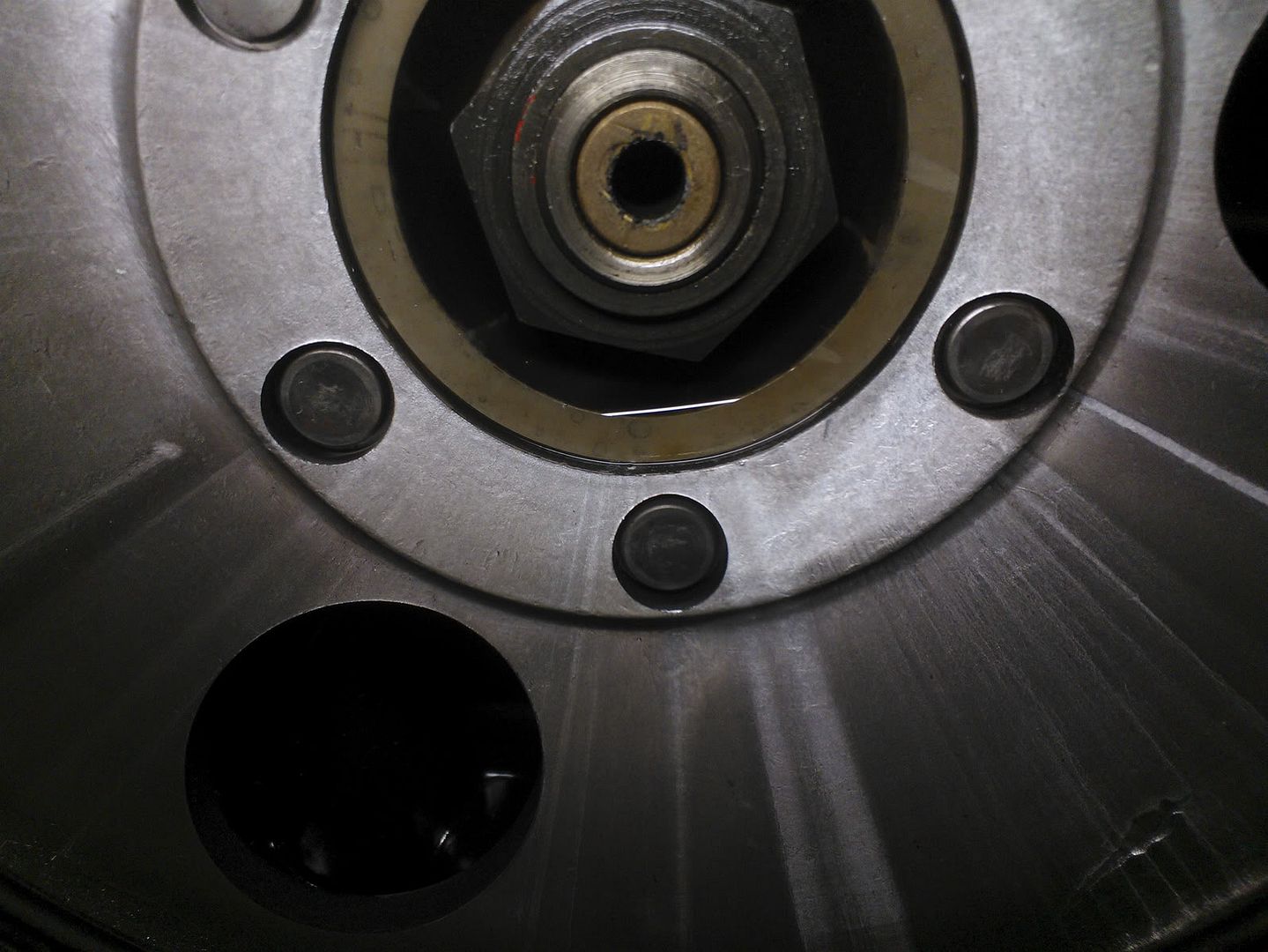

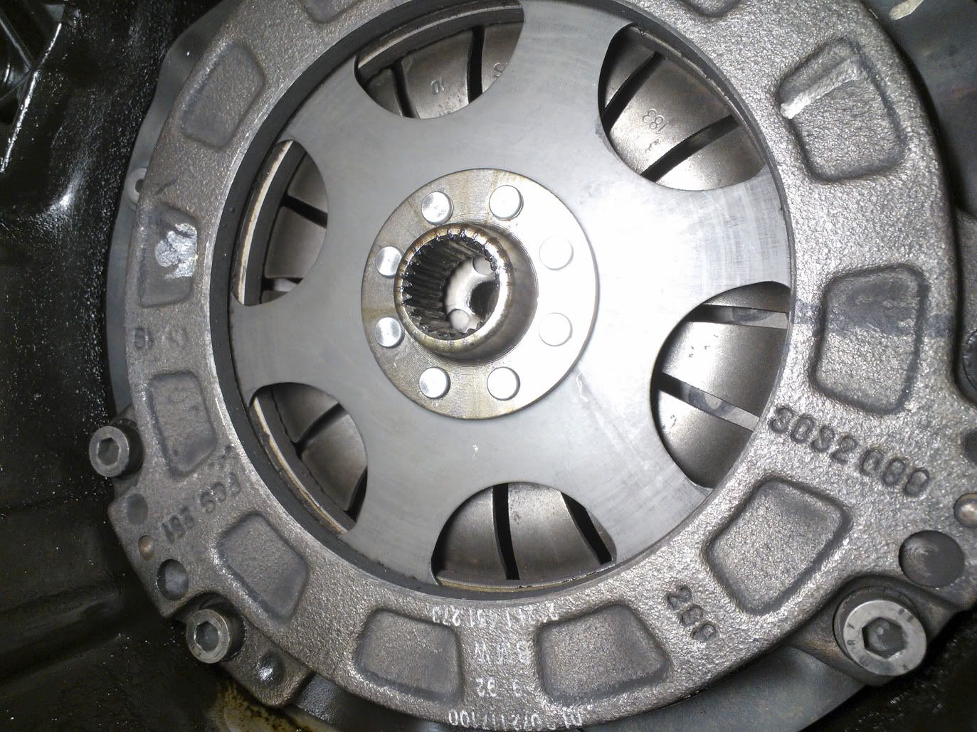

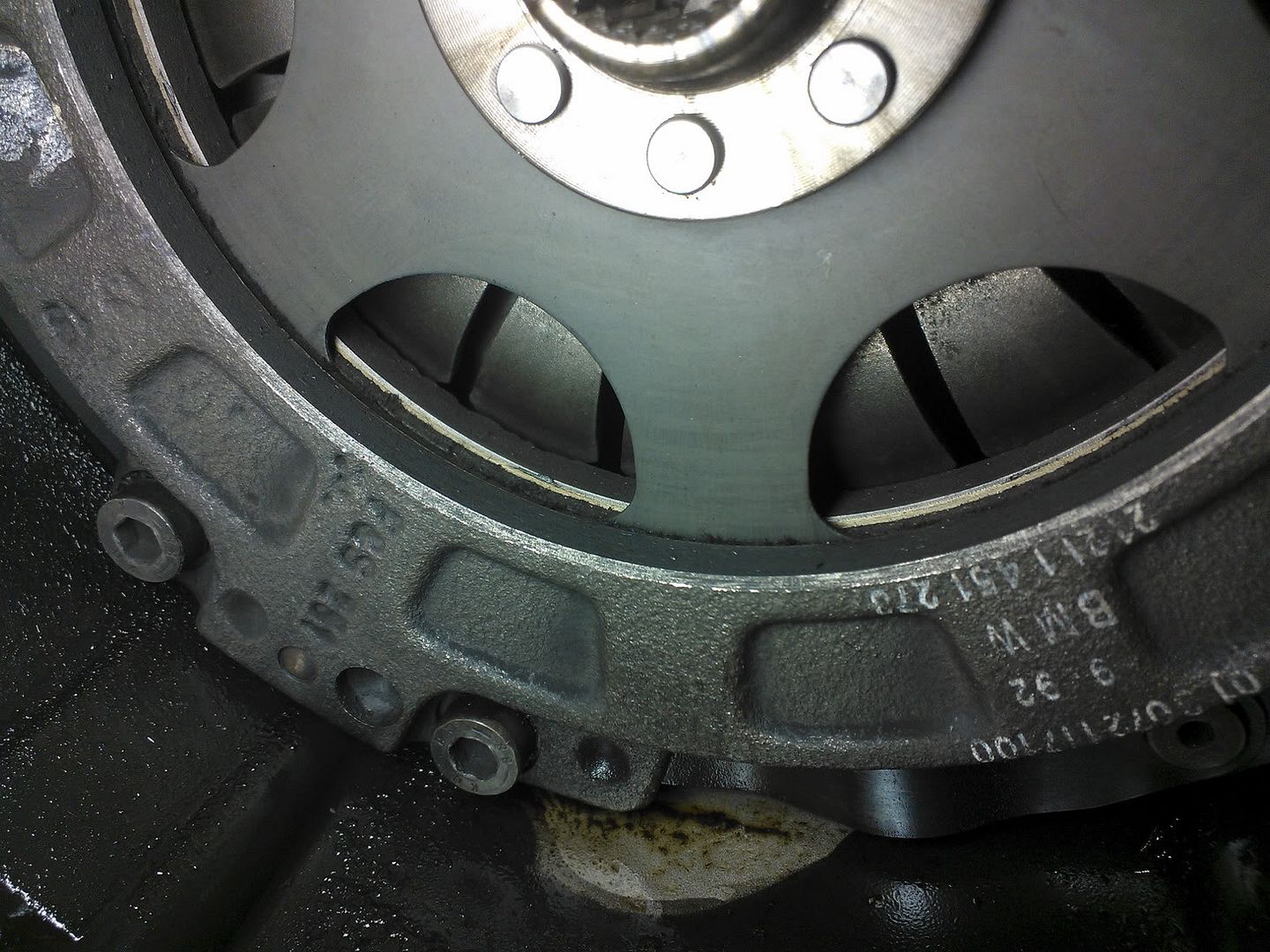

Disassembly complete except for the clutch

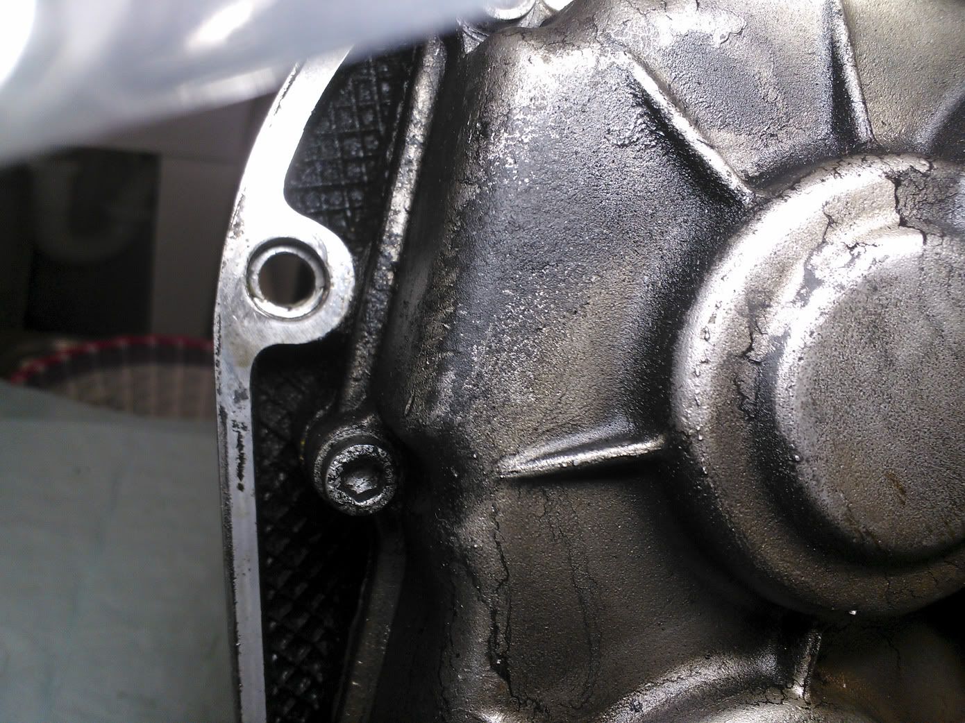

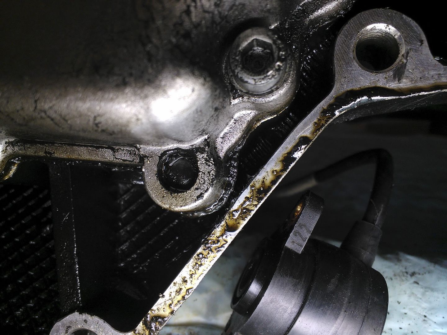

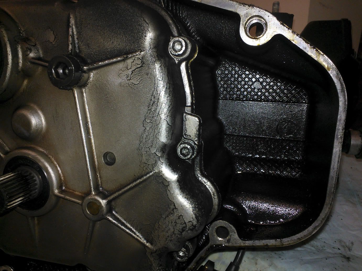

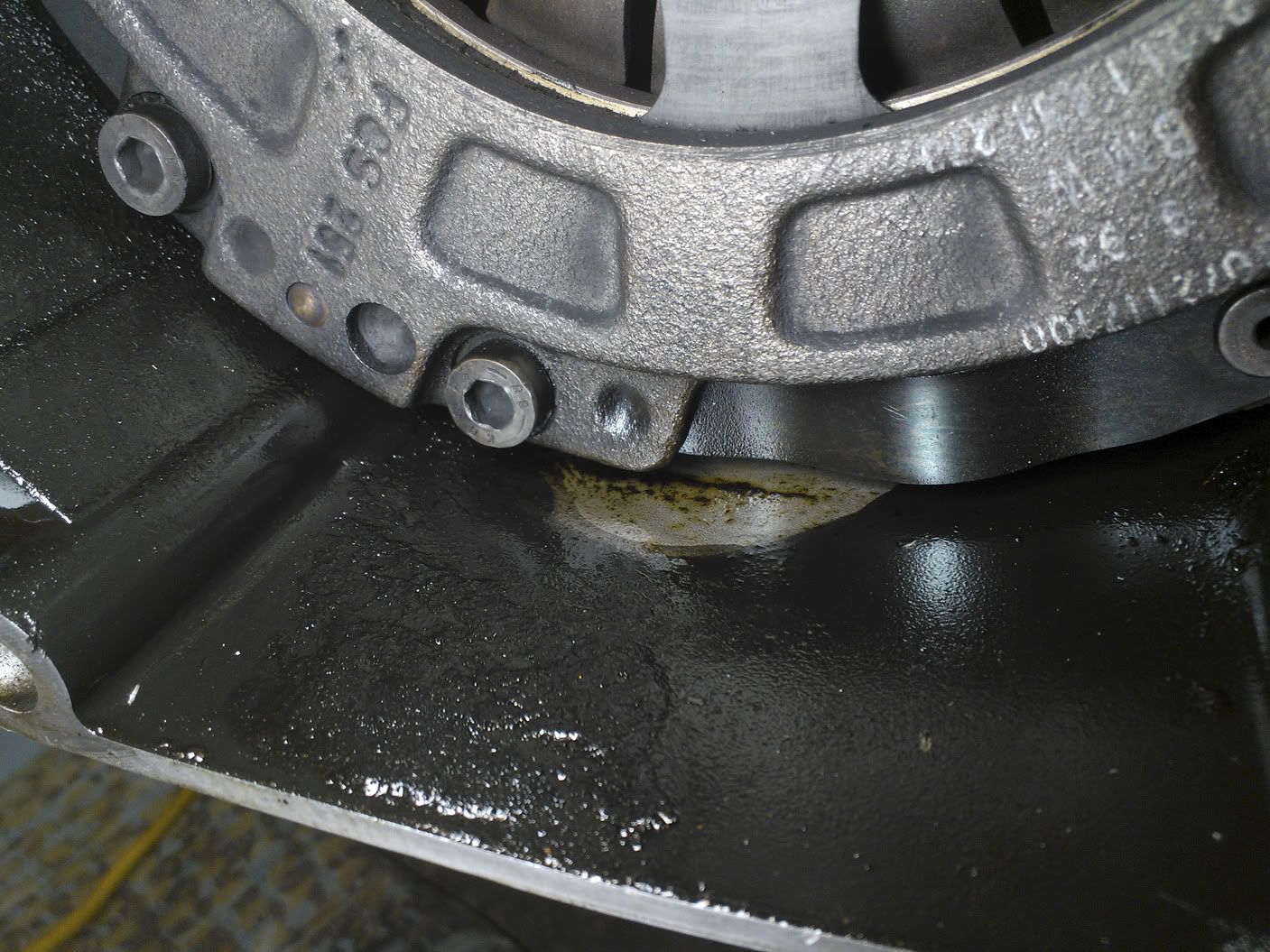

Swingarm pivot bearings look good so the only bearing needed is the one FD pivot. Next question on the table is where is the oil coming from? There has been oil present at the bell housing weep hole for some time. Any suggestions based on these pictures would be greatly appreciated.
Lee
'93 K1100RS
Re: Doin' the splines
« Reply #7 on: August 21, 2012, 05:39:34 AM »
You need to take the clutch plates off.  If it is leaking inside the clutch housing then you need to replace the O-ring,  If it is leaking in front of the housing then it is the main seal.

« Reply #9 on: August 22, 2012, 01:34:51 PM »
Clutch package marked and removed. Definitely wet inside the housing and around the clutch housing nut / thrust ring. Pointing to the O ring?

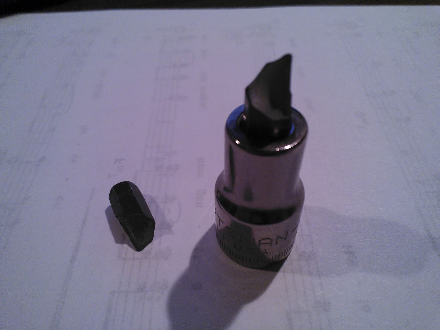

Off to pick up a 30mm socket to finish this leg of the job, a small bearing puller to deal with the FD pivot and a replacement for an allen socket which didn't survive the transmission removal.

« Reply #10 on: August 22, 2012, 09:39:43 PM »
Definitely the O-ring ... very brittle and crumbly. Main seal looks dry and in clean condition. Clutch disc doesn't seem to be fouled but might as well  go ahead and replace as long as I'm in here.

Wanted to change the hand grips but the bar end screws are completely destroyed. Will tackle that when I don't have anything better to do.
