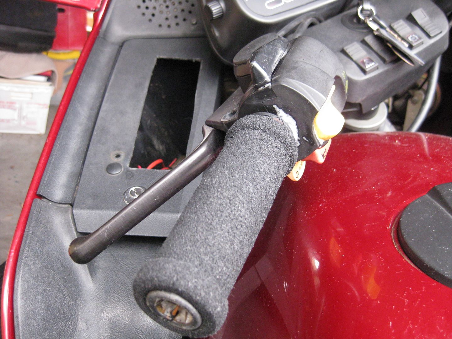

Decided to remove the horrible stock grips from my 1993 k75 RT and install a set of ProGrip 785 foam grips. Turned out it was more difficult than I expected. My K75 has heated grips, and it was pretty straight-forward cutting off the old grips - I slid a carpet hook knife http://www.irwin.com/tools/utility-knives-blades/linoleum-knife under the old grips. Took all of about a minute per side to slice them off. I was left with this:
...and this on the throttle side  :mbird
 :yow No wonder the throttle side heated grip wasn't working! If anyone has a clue how to rectify this, I'd be interested in a reply. I can still see the cut wires still down the handlebar guts, but have no idea how they're routed, or how to access them...
Anyway, these heated elements seem to be covered with some sort of heavy paper, and, of course, are slightly larger diameter than bare metal on the clutch side, and bare throttle tube on the other. I was planning to use soapy water to slide them on. Well, that's a LOT easier said than done! After a lot of shoving, though, eventually the throttle side went on. The clutch side, though, was a really tough gig with the additional thickness and non-slippery surface of the heated element. I took to using a set of multi-grips to help me with that one. After an hour's struggle, though, they finally went on.
I managed to install the end cap supplied on the throttle side, but the clutch side simply refused to co-operate. The additional thickness made it impossible.

Yes, I did put the grip back without fixing the wires. I'm a daily rider, and didn't have the luxury of time to figure out the wiring issue. I also figured that given it's on the throttle side, the throttle tube should just slide off once I remove the retaining cover on the bar mount.
It's helpful to know about the wire routing. Unfortunately, I can't view your photos because I'm in Australia and am not really up for joining the BMW club of America! Lots of dough to view a few photos! I know, I know, I'm a cheapskate! Did your wires look like mine? Mine actually look to have been cut - the breaks are very clean as you can see from my photo. I guess I can just bare a short part of the wires to check for connectivity and short circuit, then I'll be in a better position to assess the damage. I'll have to have a further explore, I can see what I can find.

On re-reading this thread, I've just realised that NONE of us actually answered the question originally posed by iiXioM: how do you remove the heating element? The grips themselves are a snap to remove, and we've hijacked his thread with our musings and pronouncements on that subject instead.
On the throttle side, the job's really simple: the heating element is part of the throttle tube, so unscrewing and removing the plate on the brake mount that retains the throttle tube will do the trick. On the clutch side, (disclaimer: I've never done it), it looks like you simply remove the mounting screw shown below. Well, that's what I'd be trying, anyway. If you want to remove the wires themselves, I imagine you'll need to find the place they exit from inside the bars - somewhere down near the bar mounts - and then disconnect them from the harness connectors and withdraw them through the bar ends. I'd also be tying a length of thin-but-strong thread (maybe dental floss) to the connector ends before withdrawing the wires so as to assist with re-installing them later.
