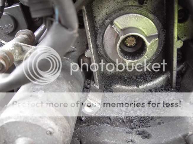

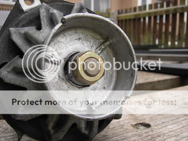

Anyway, went into town today and just before getting there I noticed the battery/charge light was lit. I carried on into the car park and went to the appointment I was heading for. I had a look when I came back out so I could decide whether to call a breakdown service (and wait a couple of hours to be told they couldn't fix it, then wait another couple of hours for something to tow the bike) or whether I could get home as it was. Here's what I found:
See all those little black lumpy bits? That'll be my alternator cush drive rubbers not doing what they should :nono
I'd started the engine to move it from undercover (dark), then started it again to determine that the alternator wasn't turning with the engine. So I decided the best course of action was to live with no lights in the rain and just get home on the battery if I could...
Those redtop batteries seem good anyway, running with no alternator with lights for maybe 10 minutes, 4 starts and then an 8 mile ride and the engine cut just as I was parking at home.
Looks like another job for the list.... I'll balance the cost of any new parts I need when I get it apart against just going for an alternator upgrade now.

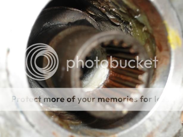

Hmm, this is a slight discomfort in the posterior then.
The alternator cush drive is a little worn, both rubber and metal:
I'm pretty sure they shouldn't look like that :laugh
Now I have a decision to make - obviously the rubbers will be new, but do I get used parts (dog and cup) or new from BMW? Used (from motorworks) are half the price of new and have a 6 month warranty, but the new ones come with a 2 year warranty... (I'm talking to myself, it's a rhetorical question)
But, see my question in the workshop...

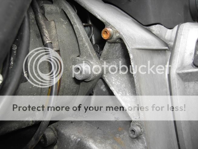

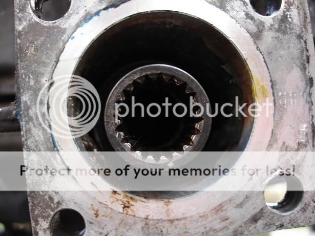

Right then, got the driving dog retaining bolt out (as detailed in the workshop thread) and it brought most of the threads from the shaft with it...
So, either bigger bolt or helicoil - still not a big challenge by itself. To fit all the tools in to do that (and remove the dog due to my puller issues) it looks like I'll be dropping the engine and splitting the cases.

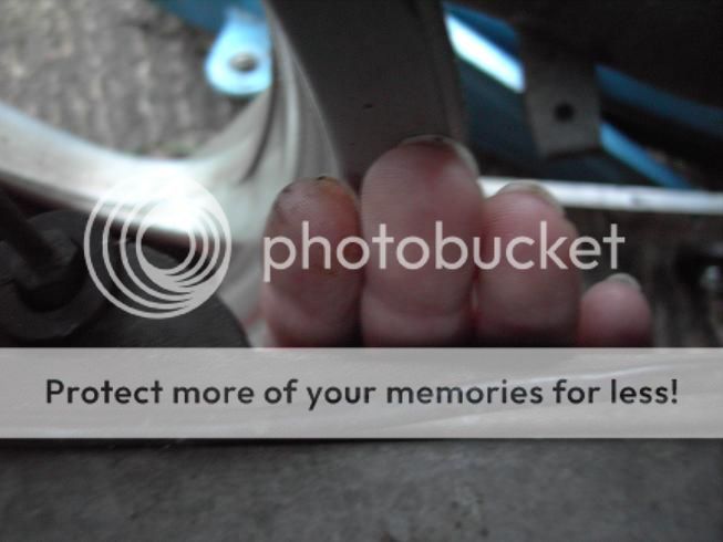

Before all this I thought I'd give the bike a bit of a wash again (it was filthy when I got it, trying to get it all clean in one go wasn't going to happen) and I found out why the brakes are binding occasionally. On the front brakes 3 of the 4 pads have a little problem - the friction material is coming away from the backplate. Looks to me (I can confirm when I get them out) that some moisture got in somehow and the backplate has rusted and then pushed the linings away. It feels like the rear has done the same.
That'll be new brake pads needed too then.
Anyone want to wager on whether the caliper pistons/seals are going to be up to being retracted to fit new pads?
Plus all the rubber brake hoses are dated 1986 so are original and I just know if I disturb anything they'll split just to taunt me.

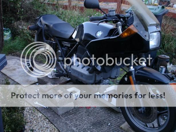

So......
I give in.
This bloody thing is coming apart and getting the shock of it's life. I was going to do a little bit here and there as I got time but it seems that every time I touch it to fix one thing I find something else (or 3 something elses). Might as well just tear into it.
Watch this space.

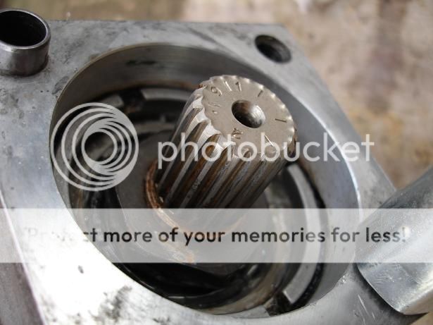

Not really any more interesting bits done - did an oil service and spline lube though.
Made a 'ghetto' centre stand from some blocks, a jack and a big wrecking bar  :2thumbup:
Rear splines:
Don't look all that bad to me.

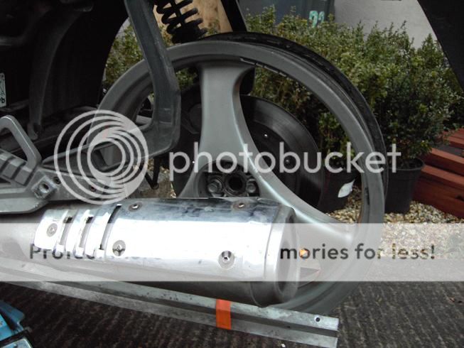

So, my wheels............
Front one has a ding in (which I knew about) and the rear, well, ~ springs to mind (found out just how bad during recent service activities - no wonder people have been pulling up to me at the lights and telling me about my rear wheel :yes)... According to the PO, the rear brake caliper made a bid for freedom by losing a bolt. I bet that was fun.
I've been keeping an eye out for a while for some reasonably priced wheels to make an appearance and a rear turned up on ebay - got it for £21 delivered. It's not a K75 wheel though. It's not a K anything wheel......
It's from an R 1100 RS. Fits straight on, lines up as well as the original wheel. It's a little wider - going up from a 2.75" to a 4.5". Got a little bit of clearance to play with.
Only thing is it's an 18" instead of a 17" - no real hardship but means tyres are a little harder to find.
Watch this space to see how much the tyre rubs the swingarm....

Ok, so that rubbing tyre issue.
Guess what?
It doesn't!
A 150/70r18 MT90 mounted on an R1100RS wheel goes straight in with plenty of clearance.
A 110/80r18 BT on the front means I'm now rolling on radials which has made an astounding difference to the handling. Very little tracking of road repairs etc. - it goes where I point it. The rear tyre does completely outgrip the front though, so when another cheap part-worn front in the right size turns up I'll be trying that. I don't want to splash out on a new tyre for a couple of reasons -- I'd rather trial tyres for a couple of pounds rather than spend nearly 100 and not like it at all - and - the front wheel still has that dent (no, it hasn't fixed itself yet) so I don't know what is going to replace it. I'd like a 19" but it depends what turns up.
