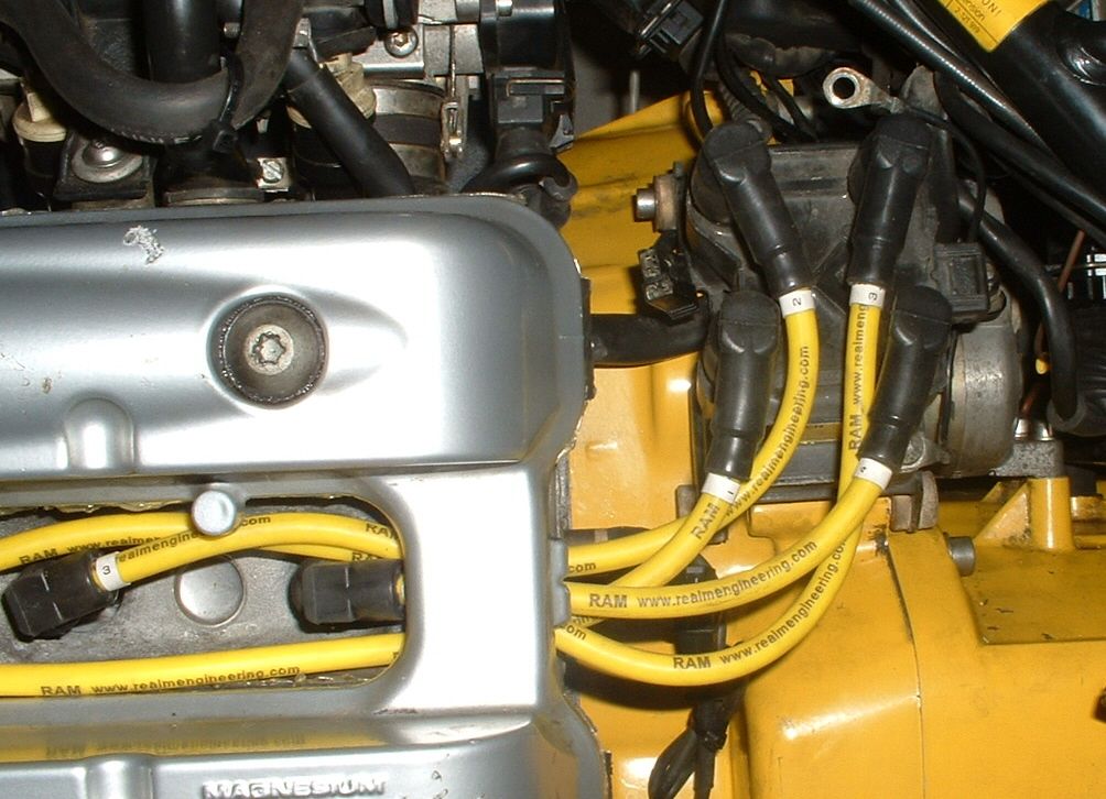

OEM leads are renowned for
a - being crap and
b - being crap.
Apart from the fact they are a "parts bin" selection - just take a look at where the lead is wrapped round itself to make it fit in the lead trough ! Also take a look at the cracks that appear as a result.
Best illustration is to remove the cover and when dark [ 'ish ], start the bike and observe the lightning display !
One of the first items I developed for my Kays was in conjunction with RAM. Here's one set of 8mm Hi-Po lead sets - all fit perfectly. Many peeps over on the K11OG and Flying Brick forums using them. May other fine lead sets available of course.

First off to clarify - I have NO commercial or financial connection with Realm Engineering [ RAM Power leads ]. I simply liaised with them to develop what I considered a superior lead set at a sensible price for my proects.
They ship worldwide, and occassionally group buys are arranged to reduce the carriage costs.
When I was developing and testing the leads - I got a great deal of feedback from guys on the K11OG and Flying Brick sites - and in return for that I secured a 10% discount for forum members [ as with the RAMSHOX I developed ]. Realm today confirmed they will extend that to any Kay specific forum / club / site.
The RAM leads were designed to fit EXACTLY and the caps were chosen specifically for a good fit.
The coils shown in the first pic are K1100 - different of course for K100 and K75 - EACH lead set was individually designed for fit and function.
Check them out on www.ramshox.com. and tell them TJ sent you so you get your discount.
