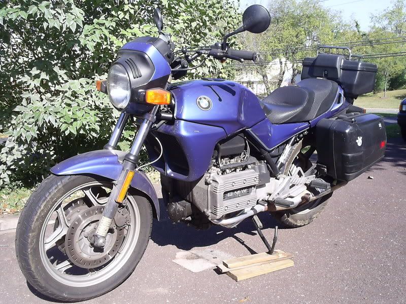

This K75S will be my 5th K-bike ownership,

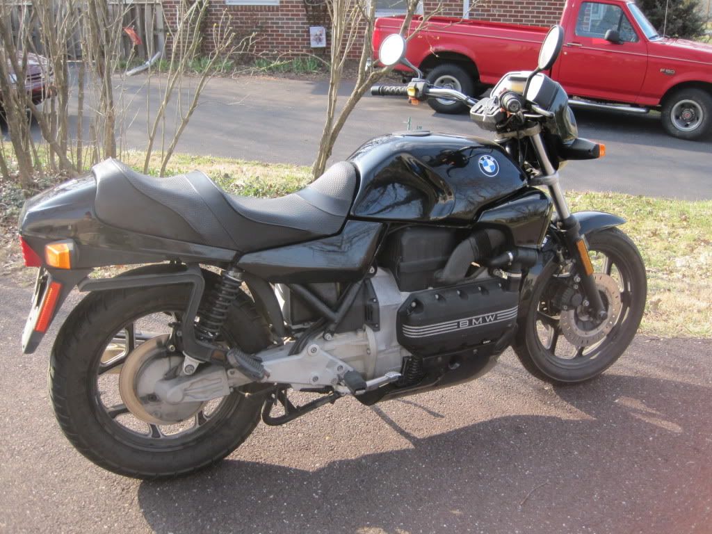

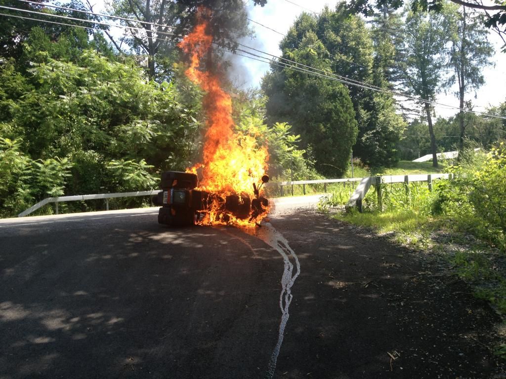

85 K100 prooject that I fixed up and sold to my good friend, he rode it for over 40k miles until it went flame-on:
