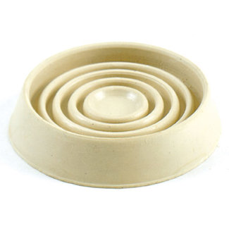

I had two of mine break while transferring them to a new transmission once :(
Found some rubber furniture feet at Home Depot:
Melted a hole through the centers of 4 of them with a hot nail:
Drilled and tapped the holes up to M6:
Had to trim a bit off the diameters so they would all fit, but stacked them up to roughly the same height as the OEM hardware:
Bolted them on, and haven't touched them in a year!

I like pallums idea, it is very diy/mcgyver :2thumbup: but the original rubbers would allow the battery to flex up and down, whilst with your idea they would only be able to compress the rubber(so flex down). But as I said I like it and you said they where holding strong for over a year already. So it is definitely an option.
However tapping a bigger hole and then inserting a helicoil wil some threadlocker on the coil and then just screwing in the original rubbers, because those are still like new and I have a tap and inserts lying around. So I think I will go with wmax351's plan and if that does not work out, I will go with the first option.
