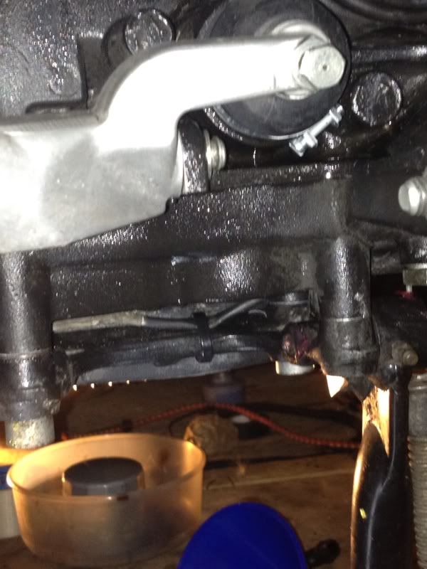

Offline tsbt
  • Posts: 241
Re: Plugs won't spark on the RS
« Reply #8 on: July 26, 2012, 02:29:38 PM »
Is this my problem? guess I'll find out.
92 K100RS 4V
75 KE125
Rick G
« Reply #9 on: July 26, 2012, 07:49:23 PM »
The space behind that boot is within the gearbox oil space and is like that because oil needs to get to the throwout bearing. The seal prevents oil getting any futher and into the shaft.
I have seen some seal put in the wrong way by mistake, on first glance it seems like it is the wrong way round but the side with the small cylindrical spring should go towards the rubber boot.
One thing that caught me out once was the adjuster screw being screwed in too far which prevented a good seal at the outer end of the boot where it goes against the actuating arm. This makes the arm sit too far back and the angle is not right so the sealing surface doesn't seal.
