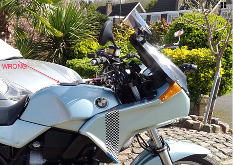

Post by: Laitch on May 10, 2017, 11:17:33 AM
Your fuel tank cap should be rotated 180º so its hinge is at the rear. As it is now, water accumulating around the perimeter of the cap can infiltrate the tank and mix with fuel. Obtain a new gasket and remount it.
It is an interesting looking bike and is sure to make its owner look like quite the adventurer.

Post by: wuyang on May 10, 2017, 03:33:45 PM
Cheers ...keen eyes, I'll round to sorting it.

(http://i742.photobucket.com/albums/xx70/wuyanging/db4667bd3d212a9e71acb6c2582d1709.jpg)
Title: Re: Mayo creamy oil cap temp light
Post by: Laitch on May 10, 2017, 04:06:40 PM
What do you mean?
Some oil filters have paper decals or stickers on them with the name of the filter or other information. Those need to be removed when the filter is mounted in an oil sump like it is with the K. If they aren't removed, they'll show up as clumps in the oil that people will describe a brie, mayonnaise, cream or who knows what else, based on the describer's experience with goo.
Post by: BrickMW on May 10, 2017, 04:30:37 PM
Ok.
The water inside the bottle is just like drinking water,,,,,not black....
Clear water? no coolant? If that's the case, then the white stuff is either lithium grease from the clutch splines, (haha... jokes) or more likely Stop Leak which has now blocked the radiator and/or the thermostat and/or the water pump.
The absence of coolant leads me to believe there may have been a pesky leak that was being frequently topped off with water only, or someone has already tried to flush the gunk out, or some of those products instructions say to use water only for "treatment" then drain and add coolant.
I found similar stuff in my coolant after purchasing my truck, heater barely worked so I flushed the sh!t out of it leaving a pile of white globules on the ground similar to your pic. Heater immediately improved 1000% and I was still patting myself on the back on the way to work the next morning enjoying the toastyness I had restored to the cabin. When I arrived at work and got out  there was an 1/8" stream of coolant shooting straight out of the front of the grill from my radiator. PO had obviously taken shrapnel through the grill and went for the shortcut fix. Had a nice buildup of the same white stuff in and around the hole. (<---Go ahead, go crazy with the jokes) :hehehe
I would remove the fuel tank, top off the radiator at the cap, then drain the system into something I could measure how much came out. The volume and condition of what comes out will be helpful clues.
