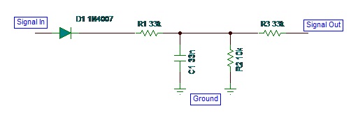

My solution (found through trial and error of filters found on the net) is this circuit below.

RBM:  I tried that circuit.  It did steady the bounce for the most part, but I still had an occasional bounce at idle.  At increased rpm, it went all over the place.  If I added a diode it reduced the range of the bounce.
Seems like you're using a high pass and low pass filter with a diode--did this work?  Does it hold steady now?

Post by: Xjskins on May 22, 2015, 06:39:23 PM
The needle is steady and smooth throughout the entire rpm range.

Post by: mossy173 on May 29, 2015, 09:15:12 PM
dang, still bouncing around. I did substitute a 1n4005 diode, do you think that made a difference?

Thinking about it, I have my filter fairly close to the gauge.  Could this be an interference type thing, where electrical fields from other parts are influencing the signal along the path of the wire after the filter......wild guess...
Title: Re: Installing aftermarket Cluster
Post by: rbm on May 29, 2015, 11:21:51 PM
The filter has to be as close to the gauge as practical, for the reason you cite xjskins.
Mossy, did you try just the one low pass circuit?  A 1n4005 won't make a difference.  It has a lower reverse voltage spec but that doesn't matter.  Is there anyone with an oscilloscope you can borrow to get an idea what you're trying to feed to the gauge?

I built the low pass filter in reply 2. It helps quite a bit, but I still have some jumpiness in my tacho, which is an Acewell.  I want to try the one in reply 4. My question is what capacitor do I use?  I'm not understanding the notation in the diagram. Thanks!
Post by: Xjskins on May 10, 2016, 07:56:20 AM
Although it was been a while, I believe it to be 33 nano farad.  The free program that I used to draw that was Texas Instruments TINA, and it is loaded on the other computer, will confirm for you later today.

Just thought I'd report my progress. Built and installed the circuit from reply 4 but with a 47 nano farad capacitor instead of a 33. Just fired and revved the bike in the garage (didn't have time for a full test ride) and the tach looked very steady and accurate. I'm going to call it a success. Will report back if there are problems upon a full test ride. But if I don't post, future readers can assume that this solution worked for me. Thanks all for the assistance. Best, Justin.

I've been suffering from the jumpy tachometer for a few years now and found this thread, unfortunatly the schematics on reply 4 is gone, do you think you can explain the circuit?
//Tom
Post by: Laitch on June 15, 2017, 06:16:18 AM
This is the schematic to which you refer; it is visible in reply #4 so check your computer or phone settings.
* Hoskins Reply#4 schematic.jpg (14.14 kB . 512x172 - viewed 1069 times)
Thanks, must have been looking at the post while not signed in!
