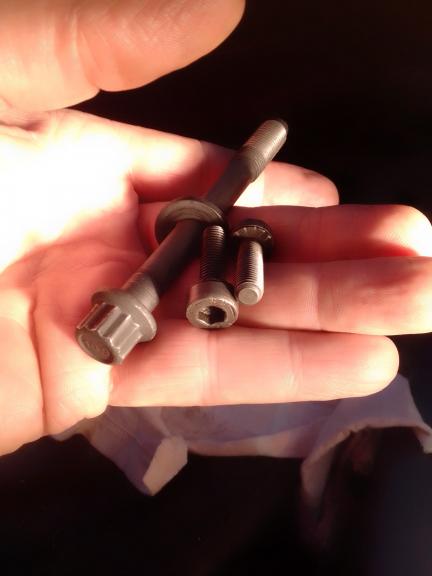

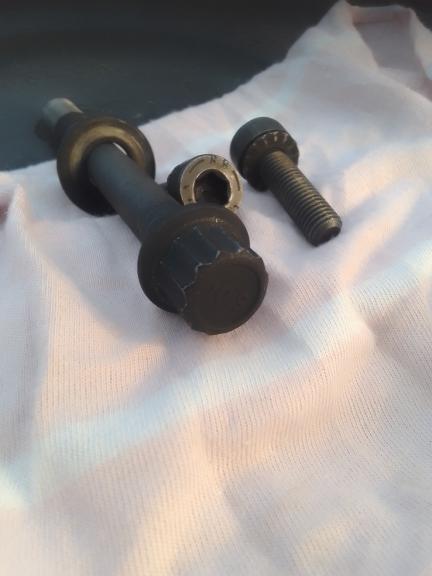

 I really don't think they're torque to yield bolts, probably just bolts. Torque to yield bolts have some typical characteristics that these just don't.
If a bolt breaks that doesn't mean it's torque to yield, probably it was just sheer bloody bad luck. There could be many different reasons for bolts being described as single use. Wearing my cynical hat for a mini, if the person telling you to replace them is the person trying to sell them, that's a hint. Sometimes it's good form to replace cheap parts with new if they're in difficult to get places, which applies in this case. Sometimes lock washers are considered single use, and since these lock washers are also captured washers, that might apply in this case.
In the photo is a Long torque to yield bolt, and two clutch bolts from a K100. The K bolts are marked 8.8 so they're high tensile, good for 800MPa tensile strength. If you just get bolts from a hardware, they might be 4.4 or less, they might just be plain Jane mild steel, they might just stretch or break.
The torque to yield bolt has a non threaded section, and part of that is reduced in diameter, that prevents any stretching from occurring in the threaded part, which we obviously don't want.
