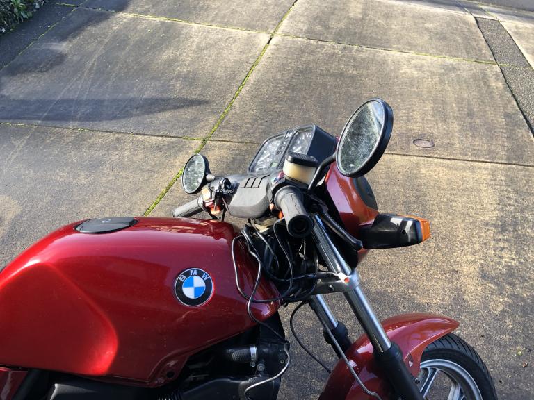

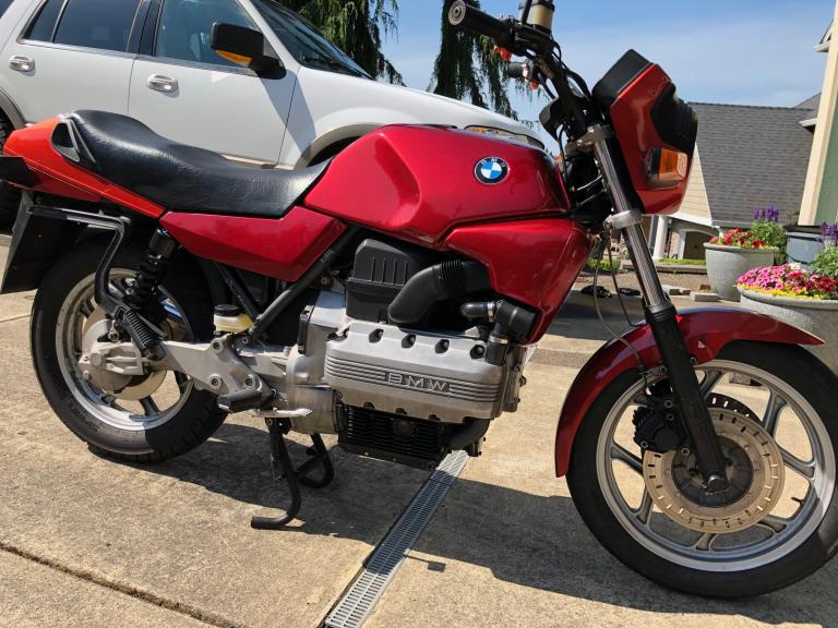

Here's the new tail/brake light...
In this pic I was trying on the 4.5x18" 3 spoke wheel... part of the wheel story I'll tell later  :bmwsmile
Title: Re: Bob's 85 K100 Project
Post by: johnny on October 06, 2019, 04:34:21 PM
that is a fine looking brick... dont let anybody tell you the gas cap is on backwards...
what is that sticking out the bung... some kinda new kind of gerbil apparatus...
is that a 1200 wheel...

Thanks, Johnny...
Not a gerbil... that's my new LED brake light!  I'll be replacing the seat and rear cowl at some point, and the easiest and quickest way I saw to mount that light was to attach it to the existing brake light.
The wheel laying no the garage floor is from a 1200 (part of the long wheel story).  Not sure where the wheel that's on there in the picture came off of.  It's the 3 spoke 4.5x18.  Got the tire wrangled on last night and I'm wanting to take her out for a spin!  But need to get it balanced.

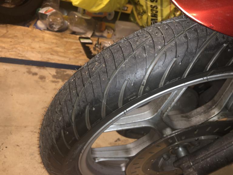

Oh, I should add that I had read many posts about going to a larger tire.  So in anticipation of center stand issues, I bought a center stand from a K1100 like everyone was talking about.  To my disappointment, the 1100 center stand also hit the tire.  I was in a hurry because I had to meet my brother for dinner so pushed the bike into the garage, leaned it against a pole, and dealt with it later.  Ultimately I just removed the center stand and she sat on the kick stand last night.  I read somewhere that I need the actual stand mount from the 1100 as well, while others have said you just need to trim the hell out of the left leg of the stand.  comparing the old vs the other old I'm thinking the mount isn't the issue but I need to sort that out.

Thanks Laitch!  Would that have been brought about by the low fuel level?  It hasn't made that noise since that last fill and I've never had it that low in fuel since either.

your photos show oe snowflake wheels... why you wanna  mess with other than oe wheels...
I have tire envy whenever I see a bike with a bigger tire than mine.  I'm justifying my decision to stray from OE by telling myself radial tires are going to be better than the old bias plys.

Post by: johnny on October 06, 2019, 05:35:58 PM
why not go directly to car tiors if you want wide...
you can put radials on those oe snowflakes...
here is the tior thread... (http://www.motobrick.com/index.php/topic,5480.0.html)

Post by: volador on October 06, 2019, 05:52:42 PM
Oh, I should add that I had read many posts about going to a larger tire.  So in anticipation of center stand issues, I bought a center stand from a K1100 like everyone was talking about.  To my disappointment, the 1100 center stand also hit the tire...  comparing the old vs the other old I'm thinking the mount isn't the issue but I need to sort that out.
Sharp looking moto!
46522311150 Center stand supporting bracket is same used by K100 & K1100
https://shop.maxbmw.com/fiche/DiagramsMain.aspx?vid=51713&diagram=46_0114&partnumber=46522311150
This thread may be of some use showing the added left leg mod needed
somewhere around page 3
http://www.k100-forum.com/t2713-wider-wheels-radial-tyres-on-a-k100

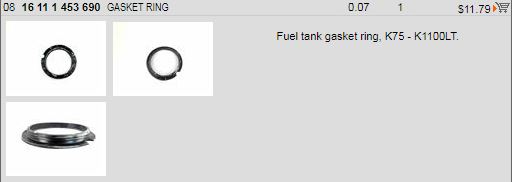

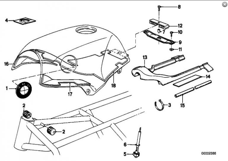

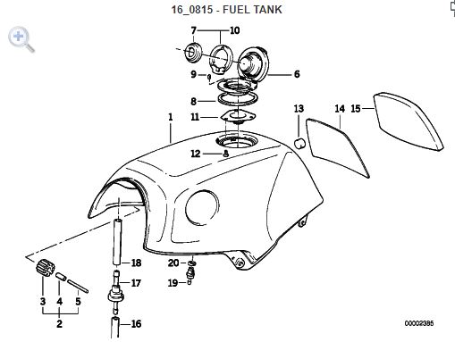

Post by: volador on October 06, 2019, 07:39:14 PM

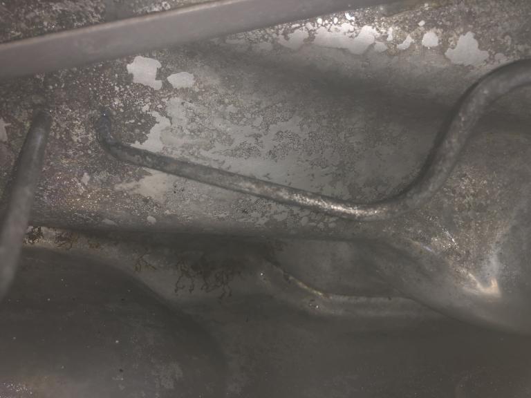

Go about tank removal carefully.
The thermistor type fuel level sender is no longer available and rare as hens teeth on the interwebs.
Round connector ends power the fuel pump.
The photos are from DJEwen's '85 build  http://www.motobrick.com/index.php/topic,10875.375.html
http://www.motobrick.com/index.php/topic,12340.0.html

This pic is from the web shows a newer 43mm diameter fuel pump with sock strainer as opposed to the older 52mm pump

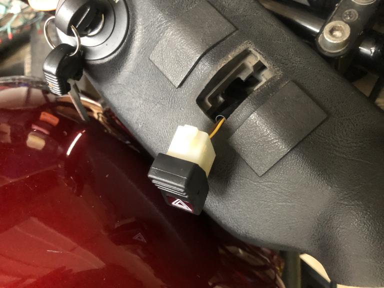

- No ignition switch that I can find, so maybe the PO just hard wired it?  No, that would leave the lights on.  Hmmm don't know.
- The little "dashboard" where the ignition switch would normally be mounted is missing

Been reading about how to best clean the inside of the tank.  I think I'll start with a water rinse or two to get all the yard debris out and go from there.  I've read about people using things like carb cleaner, baking soda and water, and vinegar.  Not all at the same time of course.

At this point, with a tank that dirty, the violent foaming action of baking soda and vinegar might just be beneficial...
Post by: Martin on December 02, 2019, 02:56:20 AM
Soaking with cheap old cleaning vinegar seems to work most of the time. This can be used in conjunction with scouring pads, a pad on a blunt piece of dowel can be used for hard to reach places.
Post by: The Mighty Gryphon on December 02, 2019, 09:24:43 AM
Scotchbrite, Dawn detergent, and white vinegar were my best friends last summer when I did the tank on my "new" K100RS.
Be sure to remove the fuel level sender before you start.  If the arm doesn't move don't force it.  I did and it cost me some large bucks to replace it.  I don't know the best way to free it up if it's rusted solid, maybe a week or two in vinegar followed by lots of penetrating oil(not WD40).

That sounds like a good combination and I happen to have both of those.  I have the older tank config so no float to contend with... although it does have the old style 7L/4L level sense that tends to fail at some point and replacements aren't to be had.
* Tank Diagram.JPG (52.18 kB . 768x541 - viewed 1764 times)

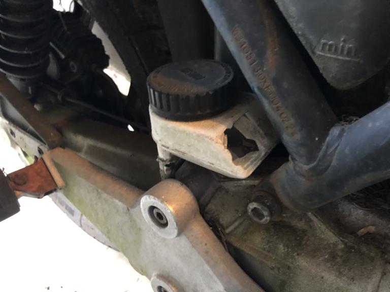

A few more pics...
I had thought the rear brakes worked but based on this picture I'm going to change my position...
* Rear Brake Tank.JPG (40.15 kB . 768x576 - viewed 1800 times)

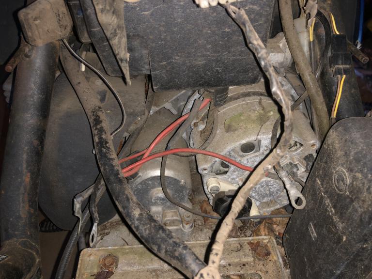

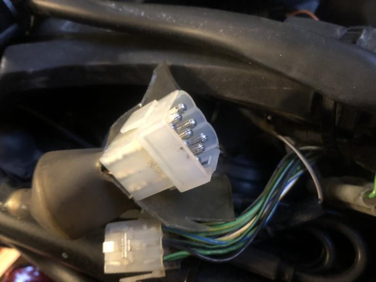

Picture of the area behind the alternator.  Hooking the battery up should be pretty straight forward...
* Alternator.JPG (77.66 kB . 768x576 - viewed 1774 times)

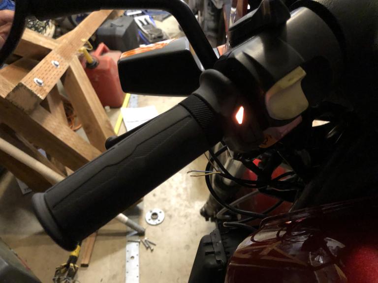

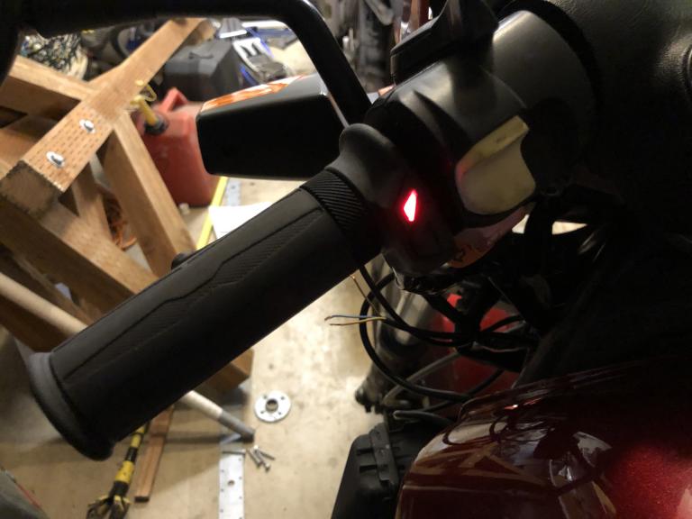

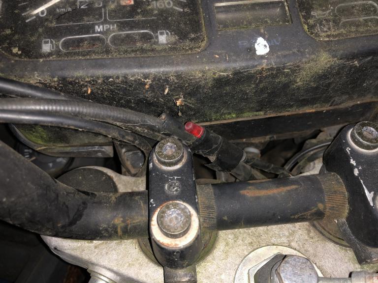

This is the red LED that the PO mounted where the ignition switch would have been if the dashboard was still there.  Not sure what it's for?  Maybe to indicate ignition is turned on?  I suppose it could be several things if the lights from the instrument cluster don't work...
* LED.JPG (82.33 kB . 768x576 - viewed 1647 times)

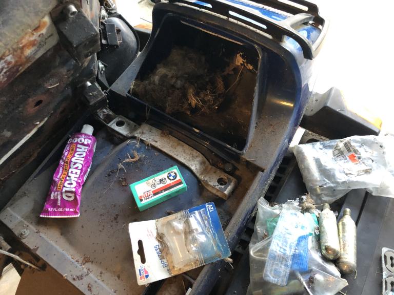

This is what was in the storage compartment.  Some CO2 cartridges to fill patched tires, a mouse nest (no mice), and some other misc stuff...
* Rear Cowl.JPG (73.29 kB . 768x576 - viewed 1788 times)

Oh, almost forgot to mention that I didn't see the ignition switch anywhere.  Will need to put in a concerted effort to locate it or at least the wires that would go to it.

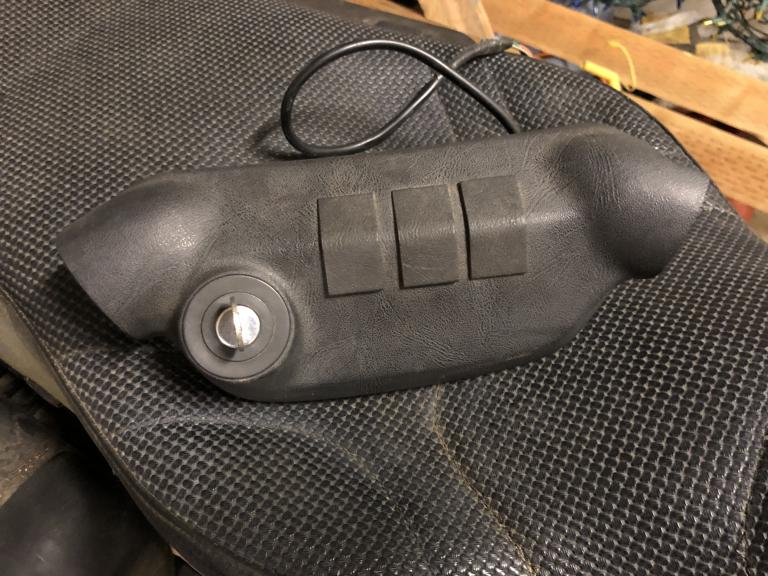

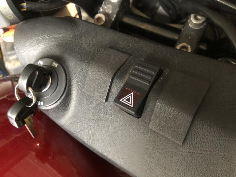

Received my RS dashboard with the ignition switch and key.  I'm thinking the PO swapped out the handlebars (actually, I think someone had mentioned that) because the dash doesn't fit up like it should.  Since I want to get to the RS config one way or another (get the blue bike running or move the fairings to the red bike) I'm going to go ahead and pick up a pair of RS handlebars.
* Dashboard.JPG (89.31 kB . 768x576 - viewed 1629 times)

Got a couple of gas caps off ebay.  I didn't think about asking about a key for some reason.  So I've got two gas caps with no key.  I've read I can have a locksmith make a key for it so will attempt that.
Two different styles of gas caps...
The gas cap on my red bike is like the one on the left from the bottom view but like the one on the right from the top.  The key hole looks a little banged up on the one with the recessed key hole so will see if I can use the other.
Post by: Martin on December 27, 2019, 11:55:31 PM
Use the later one on the right. The flap arrangement can be removed.
Post by: bobvans on December 28, 2019, 03:08:20 AM
Thank you, Martin.  I was just reading about how moist take that flapper off.
Is there a gasket ring that goes between the fuel cap assembly and the tank?  I was looking at an exploded view and it looks like I may need item number 8...
* Tank Assembly.JPG (32.09 kB . 509x383 - viewed 1616 times)
* Gasket Ring.JPG (15.67 kB . 512x182 - viewed 1542 times)
Post by: Martin on December 28, 2019, 03:26:08 AM
  :twothumbsupp BMW: 16 11 1 453 690  is the cap to tank gasket.
Thank you for confirming that, Martin!
Now that I look at the two gas caps I have, they both do have a "hard" rubber gasket around the bottom.  I'll go ahead and get a new one on order.

Did a bad thing today.  Started out good... ended bad.  I was getting into the tank cleaning.  Started scrubbing it last night with a scrubbing pad and some hand cleaner (for the garage).  Was getting some good results.  This morning I get the idea of using oven cleaner.  Sprayed some in the area that had some bad build up... and it made a good impact!  Started scrubbing around and seeing more really good improvement.  Sprayed some more and decided to let it soak for a while.  When I got back to it, the cleaner had basically taken the sheen from the inside of the tank where it was sprayed.  Turns out oven cleaner shouldn't be left on aluminum for very long.  OK for a quick scrub and rinse.  So here's what half of the tank looks like...
* IMG_1621.JPG (43.95 kB . 768x576 - viewed 1053 times)
I gave the tank a good rinse and figure I'll continue to work on getting the junk out and not worry about the surface finish.  Seems as long as the lye is out of there it shouldn't do any harm having a dull, rough finish.  Anyone see a problem with that approach?
Post by: volador on January 03, 2020, 02:03:30 AM
Look on the bright side you've created the perfect surface finish should you ever consider a tank liner like Red Kote
Post by: Laitch on January 03, 2020, 05:49:01 AM
The chemical reaction of aluminum to lye has degraded the protective surface coating of aluminum and made it less resistant to corrosion by water—not a desirable effect when using hydrophilic fuel like gasohol, or subjecting the moto to periodic idleness that could produce condensation. You might seriously consider coating the tank's interior.
Vinegar has been a popular choice here for breaking down and helping to eliminate goo and varnish in Brick fuel tanks. It works well.

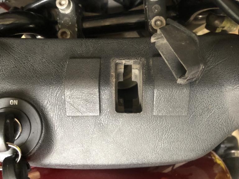

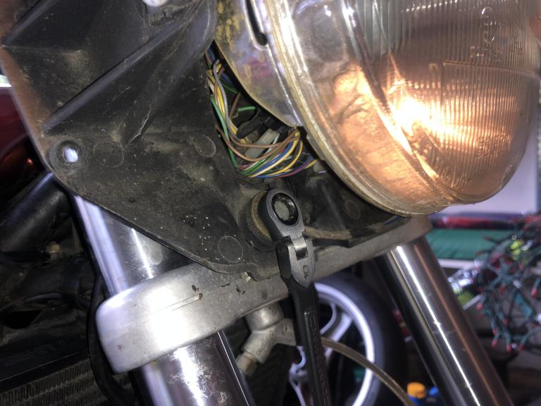

I got ambitious this week and start doing some cleaning and removing of the lower fairings on the blue bike... simple stuff.  Started looking at how the front fairing was held on and looks like I need to loosen four bolts/screws and slide it off.  One thing I noticed is that the fairings are mounted pretty losely and not all hardware was used so it gave me the sense that the PO just threw them back on to make it look complete.  Here are a couple of pics of progress (not very impressive, I know)...
At first I thought this flip up latch was some how holding the front fairing on but now I'm thinking it's just to protect the head light adjuster?
Post by: mw074 on January 25, 2020, 06:37:45 PM
That lever is a headlight adjuster for when riding 2-up.
Post by: mw074 on January 25, 2020, 06:45:50 PM
Point the bike at night at your garage door. Throw the lever and you will see how it functions.
Post by: Laitch on January 25, 2020, 06:57:05 PM
To expand on mw074's post, here is the description from the k100 rider's manual downloadable from the site.
(http://www.motobrick.com/gallery/2/1601-250120185448.png)
Post by: bobvans on January 25, 2020, 09:54:23 PM
Ahhh, that makes sense!  Thank you for clearing that up for me!

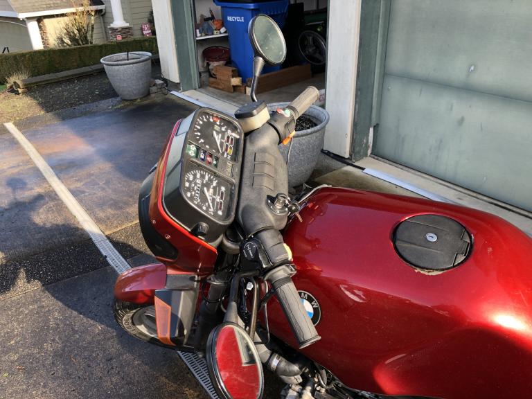

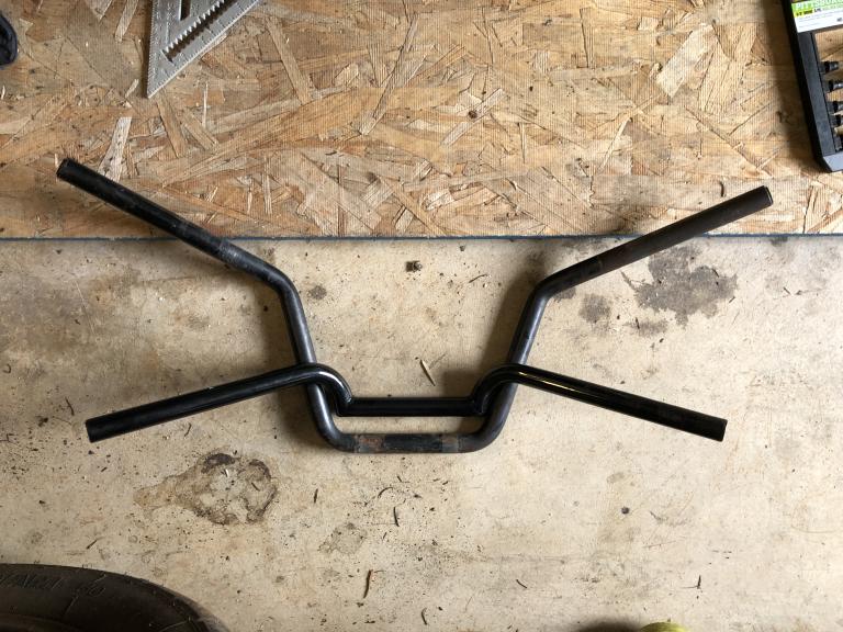

Post by: bobvans on January 25, 2020, 10:25:04 PM

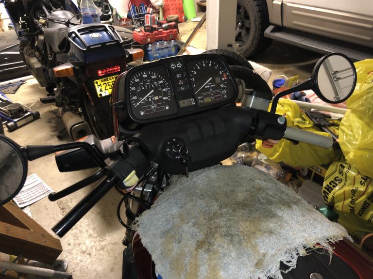

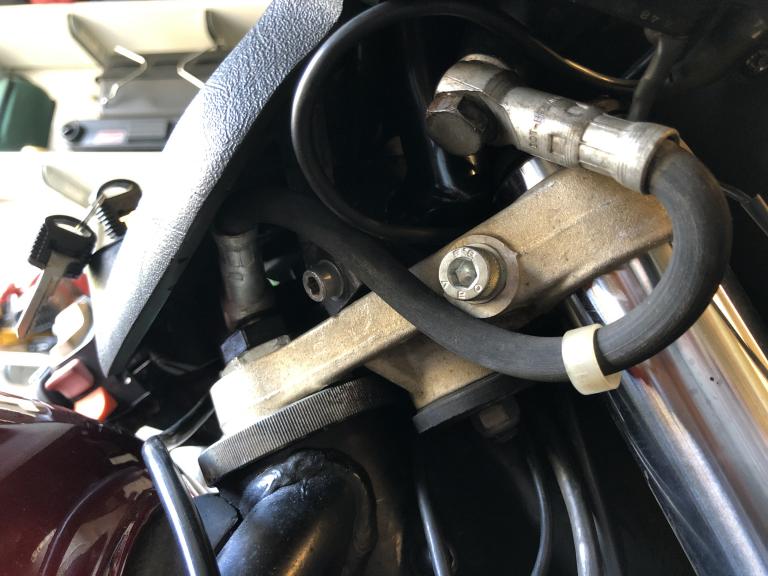

Something else I did this week is swap out the handlebars on my red bike for the RS handlebars.  They're quite a bit different!  Makes my old bars seem like ape hangers  :laughing4-giggles:
* IMG_1669.JPG (93.32 kB . 768x576 - viewed 921 times)
* IMG_1670.JPG (62.53 kB . 768x576 - viewed 949 times)
* IMG_1679.JPG (75.83 kB . 768x576 - viewed 855 times)
* IMG_1677.JPG (61.1 kB . 768x576 - viewed 951 times)
Not quite sure if I have the handlebars in the right place... I left the handlebars loose, put the RS dash on, and positioned the handlebars to line the control clusters up with the dash extensions.  Then removed the dash and tightened up the bars.  Had to adjust the banjo bolts for the brake lines to allow the dask and the reservoir/controls to sit in the right position.
* IMG_1671.JPG (84.25 kB . 768x576 - viewed 880 times)
I've been wanting to get heated grips mounted so waiting until I had those so that I could do it all at the same time.  Ended up going with the Koso Apollo's because I liked the integrated switch.

Here's a picture of the old handlebars for reference...
* IMG_0860.JPG (89.84 kB . 768x576 - viewed 960 times)

Post by: Laitch on January 25, 2020, 10:50:59 PM
There is more than 100mm difference in the length of an RS master cylinder hose compared with an RT master cylinder hose. I suggest replacing the hose with the correct size. With a moto that old, it's good practice to replace all the brake hoses anyway.
Put your red moto's model and year in your signature, too.
Post by: bobvans on January 25, 2020, 11:48:56 PM
The PO had replaced all the brake lines but that's a big difference in length.  I didn't like the big bend I have in there right now so good suggestion to replace it.
One thing I forgot to mention is that after I got the new handlebars loosely held in place, I noticed that I had the choke cable pinched in the bar clamps.  I didn't think it damaged anything but my choke light now stays on whether it's on or not so I need to sort that out.

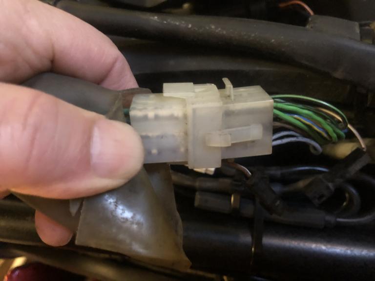

While swapping out dash pads yesterday I noticed that one of the switches was actually wired up to something.  The switch itself didn't switch so I just cut the wire and completed the pad swap.  This morning I went out to see if I could pull power from those wires so took the meter out to the garage and tested the various combinations.  Found what I thought was power and ground, connected those to my heated grips and flipped the switch.  Turns out the wires were for 4 way flashers!  Never knew I had them!  Well, since the switch didn't work I really didn't but that's an easy fix.  Will buy a new switch to get that wired up.
Post by: bobvans on January 26, 2020, 04:07:50 PM
Went to wire up my heated grips today.  Removed the tank and found the factory connector for the heated grips.  Would like to connect into that connector so was wondering if anyone knows the part number for the mating connector and terminals.  Thanks!
Post by: bobvans on January 26, 2020, 04:42:21 PM
Ended up cutting the mating connector off of the blue bike  112350

"WOW!  She turns in super easy now that I have a nice firm tire!  The smaller handlebars may also be contributing to this."
No doubt, not having air in the front tyre is going to make for some heavy steering and a new tyre ALWAYS feels SO much better that that "piece of crap other brand" you took off.
I find quite the opposite between the Standard bars and the RS bars.
I find that the RS takes more counter steering pressure because there is less leverage with the shorter bars.
Post by: bobvans on January 28, 2020, 10:23:48 PM
I totally agree with the RS (shorter) bars needing more pressure.  I've read where others have said the same... the shorter bars result in less "responsiveness".  I guess riding with that low/flat tire has given me an incorrect sense for what the taller bars feel like  :laughing1:.

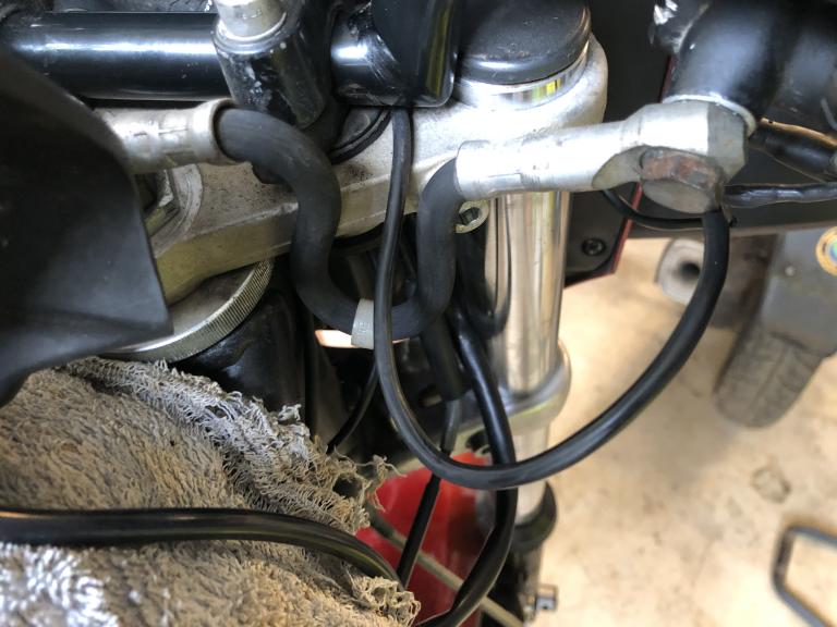

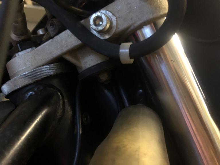

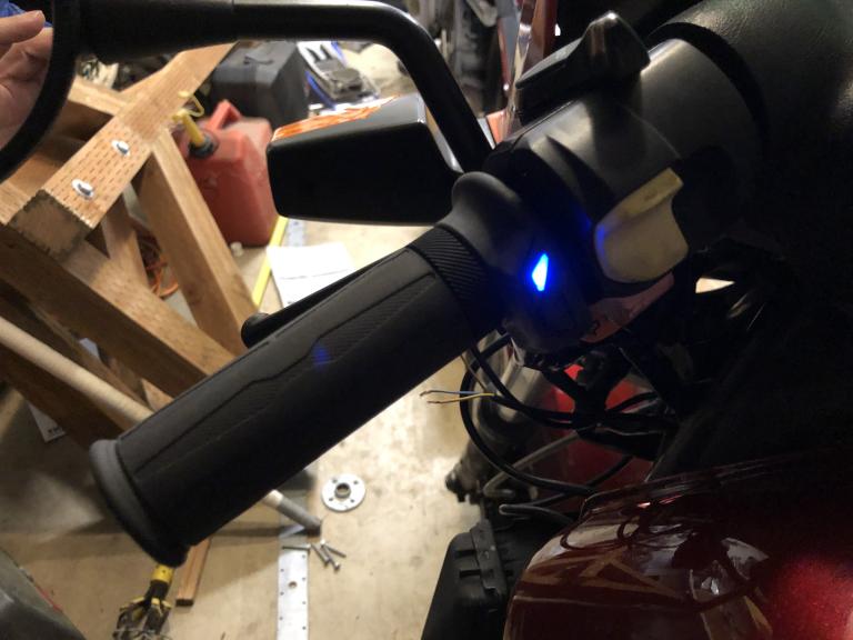

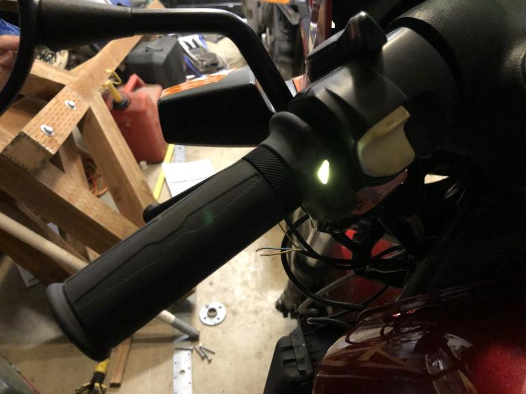

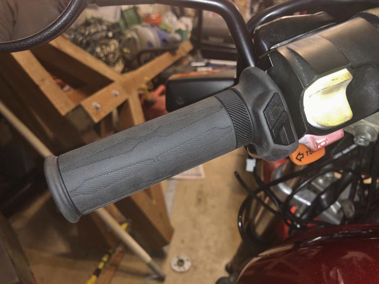

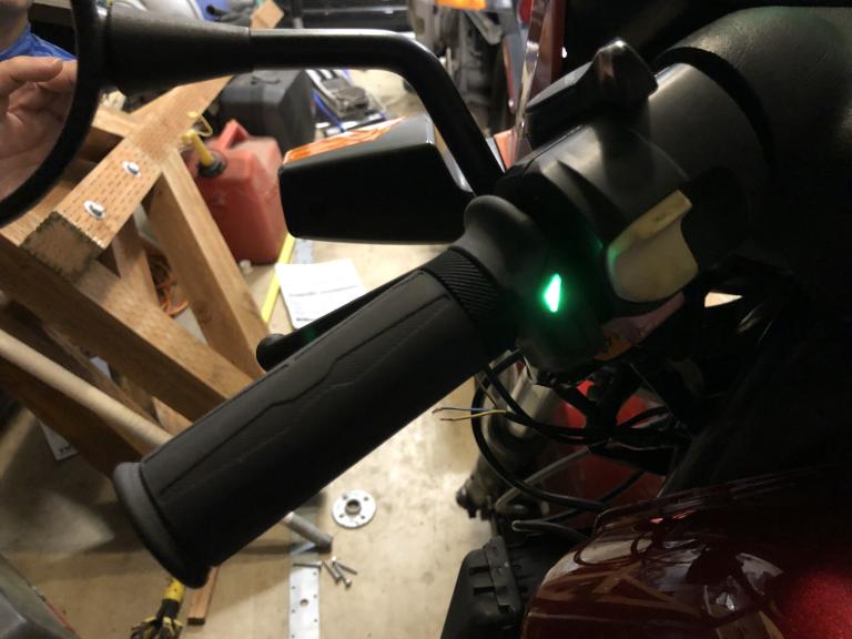

I got my heated grips all wired up the other day.  Tie wrapped the control module and excess cables to the frame to make it look tidee.  I was so excited to turn them on to feel the warmth!
Unfortunately only the left side grip was getting warm.  I waited and waited but while the left got warmer and warmer the right didn't.  I was so bummed.  Thoughts of how I would need to now uninstall them to return them, or what I could do to avoid or minimize removing and reinstalling.  Some of the reviews I've read for these grips did mention one side not getting warm or that they heated unevenly so I ended up with one of the bad ones.
Decided to just lift the tank back up and see if anything obvious jumps out at me.  This is what I find...
Took the controller with cables to work and found that the terminal was never crimped around the insulation to provide any sort of strain relief.  Not even sure if the wires were even crimped to the terminal because there were no broken wires in the crimp.  I ended up removing both terminals, soldering the wires to them, and crimping the terminal to the insulation.  Reinstalled the controller/cables and now both grips get warm.  Yay!!  icon_cheers
Post by: bobvans on January 28, 2020, 10:48:22 PM
I'm liking these grips.  The temp control is on the left grip so looks clean and easy to adjust.  5 power levels... the colors in the pics are a little off but you get the jist... (please excuse the MESSY garage!)

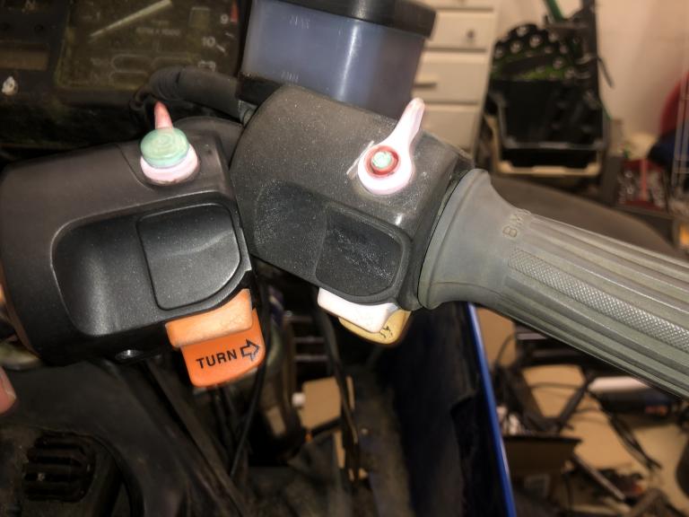

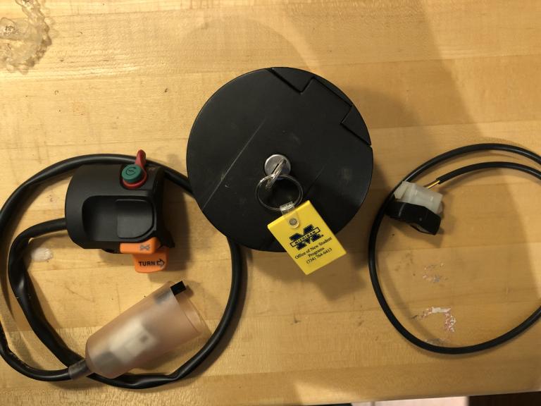

It's always fun to get packages in the mail...
* IMG_1719.JPG (51 kB . 768x576 - viewed 807 times)

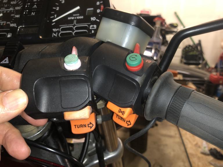

Took some time this morning to get the right hand switch controls swapped out.  First obstacle... how the heck do you get the main connector apart!  Ended up cutting open the protective sleeve to see what I needed to push.  Found the two catch releases on the two sides and managed to get it apart.
* IMG_1721.JPG (34.6 kB . 768x576 - viewed 840 times)
* IMG_1724.JPG (35.46 kB . 768x576 - viewed 794 times)

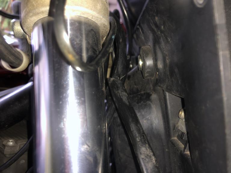

Next challenge was how the heck to get that big connector past the forks and out from behind the headlight assembly.  I didn't see a way to do this without taking the headlight assembly off (at least partially)
* IMG_1725.JPG (36.69 kB . 768x576 - viewed 830 times)
Took the headlight shroud off to access the four mounting bolts that hold the headlight assembly to the forks/triple tree.
* IMG_1726.JPG (65.23 kB . 768x576 - viewed 807 times)
* IMG_1730.JPG (53.64 kB . 768x576 - viewed 794 times)
I just loosened the two bolts on the bottom and the top right (looking at the headlight), removed the top left.  This gave me plenty of room to get the cable out.
* IMG_1734.JPG (44.57 kB . 768x576 - viewed 879 times)
While I was at it, I got the switch for the four way flashers installed.  Mounting the switch to the dash pad was pretty straight forward.  Followed the old wire to the connector on the main harness and plugged the new switch in.  Only thing is the new switch doesn't have the third wire (and I assume no light) to light up the switch.  Not a big deal since it's pretty obvious that the four ways are on.
* IMG_1736.JPG (76.38 kB . 768x576 - viewed 873 times)
* IMG_1737.JPG (58.05 kB . 768x576 - viewed 846 times)
* IMG_1738.JPG (60.78 kB . 768x576 - viewed 838 times)
I'm not happy with the wire/cable routing around the handlebars... will deal with that when I swap out the left hand switch controls (coming from ebay) and the shorter brake hose.  Swapping out the cables for the short RS ones is probably something I should consider as well.
Old vs New... on my red bike
* IMG_1742.JPG (54.93 kB . 768x576 - viewed 801 times)
The old ones I can put on the blue bike cuz those buttons are in bad shape  (assuming I get it running).
* IMG_1744.JPG (49.72 kB . 768x576 - viewed 849 times)

We had a nice break in the weather today so a group of friends went for a 60 mile ride.  The new handlebars are working out great!  Temps were in the high 30's to low 40's.  The heated grips were great!  But my thumbs were still a little cold.  Way better than without.  My fingers would normally be white and numb by the end of the ride and getting my helmet off is near impossible.  This time I could actually remove my helmet with no problem.
One thing I've been noticing for a while now is the smell of something getting hot somewhere.  Well today I found the source.  It started with the speedometer needle fluctuating back and forth.  It would move up as speed picked up but the needle wouldn't be steady.  So I check the forums and a few talk about spraying contact cleaner into the fuse sockets and sliding the fuses in and out.  So I did that.  But while I was at it I noticed a long brown wire that was loosely coiled up next to the battery.  It was connected to the engine but the wire insulation was showing signs of being overheated.
Glad that I found the source of the smell.  Will see where the wire goes and replace it with something more substantial and shorter.

So is that brown wire in the picture which ties into the transmission housing the primary ground cable?  I haven't checked to see where it leads just yet.
Post by: Laitch on February 11, 2020, 11:44:57 PM
We don't know where that brown wire connects. What we do know is that screw at the transmission is the usual point of connection for the cable from the battery's negative post.
Post by: bobvans on February 12, 2020, 12:02:20 AM
I'll have to dig around and see what the PO had going on.  I'll report back.
Post by: bobvans on February 12, 2020, 12:31:53 AM
Yup... that little brown wire is the only thing connected to the battery's negative terminal.
Positive terminal goes to the alternator and the relay box (I'm assuming the starter relay)

Post by: bobvans on February 12, 2020, 12:43:26 AM
upgrade with BATTERY CABLE KIT (4 GAUGE) - BMW K BIKE; NEG 61 12 1 244 577, POS N/A / ENDURALAST  available from EME
https://www.euromotoelectrics.com/Battery-Cable-Kit-BMW-K-BCK-5771317-p/bck-5771317.htm (https://www.euromotoelectrics.com/Battery-Cable-Kit-BMW-K-BCK-5771317-p/bck-5771317.htm)
Too bad the EME wire kit comes with black tie wraps... was hoping for white  :laughing4-giggles:

Post by: volador on February 12, 2020, 12:47:13 AM
shorten wire and crimp new ring connector, you be good to go
matches the rest of the earth tone wires

Post by: Laitch on February 12, 2020, 09:51:14 AM
The electronic control holder shouldn't be resting on the battery posts. Inspect the holder; its rubber frame mounts might be missing.
A compact and secure method for attaching the positive and negative cables is to remove the post screws that protrude upward from the battery then attach L-brackets to the battery to receive the battery's ring terminals, or attach the ring terminals with screws directly into the terminal blocks but I would consider this battery ready for recycling. Do you know its history?
The battery's hold-down plate is installed upside down and reversed; that should be corrected.
Post by: bobvans on February 12, 2020, 10:18:40 AM
Great observations, Laitch!!
The PO had told me the battery was new and that it was too short for the hold downs so he put a piece of wood underneath it.
I’ve read of others who flipped over the battery tray because the battery was too short or too tall, can’t remember which.  I’ll get in there and sort that out.
As for the holder sitting on the terminals, that was me... I was trying to get the holder/tray out so that I could see the battery better but It was bumping into the seat support so decided to get the picture from the side.  But in moving the tray around, the round bumper stopper fell out so the tray was sitting lower when I tool the pics.  I was only able to find one of the rubber bumpers but got it back in place.  Not sure the missing one was ever there because I didn’t see that one falling out.  will look a bit more.  May need to get a replacement.
Post by: Laitch on February 12, 2020, 10:50:19 AM
Raising the battery by use of the wood platform is a better means of stabilizing it than defeating the design of the hold-down. When the moto isn't being used, the battery ground cable should be disconnected from the transmission after the battery has been fully charged; otherwise, the battery needs to be fully charged then maintained on a trickle charger. To do neither will result in a faulty battery.

Post by: bobvans on February 13, 2020, 11:15:09 AM
That's good to know... thank you!  The bike came with a trickle charger but I've never used it.  Should the moto be on the trickle charger pretty much at all times then?

Bob speedo needle bounce can be cause by a dirty speedo sensor at the final drive or a dirty connection where the sensor plugs into the harness.
Post by: bobvans on February 14, 2020, 11:13:11 AM
I'll take a look at that, thank you!  Also read cleaning the 3 pronged connection inside the instrument cluster has fixed this issue for others.  I'll try the easy things first.
Post by: bobvans on February 14, 2020, 11:56:36 PM
I think I got the speedo fixed.  Took the sensor off the final drive and it looked fine.  Just wiped it off and put it back on.  I sprayed a little deoxit into the connector and plugged/unplugged it a few times.  Started the engine and put her in gear on the center stand.  Ran it up thru a few of the gears but the speedo was still fluctuating.  One observation was it seemed the connector mated almost too easy.  So I twisted the spade ends of the connector a bit and mated it back up.  Ran it up thru a few gears and this time the speedo was nice and steady.  Not sure why it started fluctuating to begin with other than the stacking of high resistance interconnects in the circuit.  Regardless, she's fixed!
Post by: Martin on February 15, 2020, 12:14:06 AM
 112350 112350
Post by: bobvans on February 15, 2020, 12:24:35 AM
A couple of pics...
Post by: bobvans on February 17, 2020, 10:22:46 PM
Dang it!  Speedo is fluctuating again!  It was rock solid earlier in the day and started fluctuating again when I went for a short ride.
Post by: Martin on February 17, 2020, 11:44:10 PM
Try tweaking it again at the plug and if that works go buy a waterproof two pin plug.
Post by: Laitch on February 18, 2020, 12:29:16 AM
Considering that relic looked like it had been pulled from a moldy hay mow, consider disconnecting the plug from the speedometer itself, cleaning all the connections and checking their tightness, too.

Tried wiggling things around but no improvement.  Took the female terminals out and crimped the ends closed a bit to better mate with the male ends.  It was a bit tough to mate the two but I'm pretty confident they're making good contact.  Still no  improvement.  Has me wondering if I have a bad wire.  I'm going to try swapping out the pick up sensor from the blue bike to see if there's any difference.  I've also read where people have fixed this by tightening the interconnect inside the cluster.  I want to calibrate the speedo so will have it open and can try that then.  In the mean time, I'll try a few other things.
