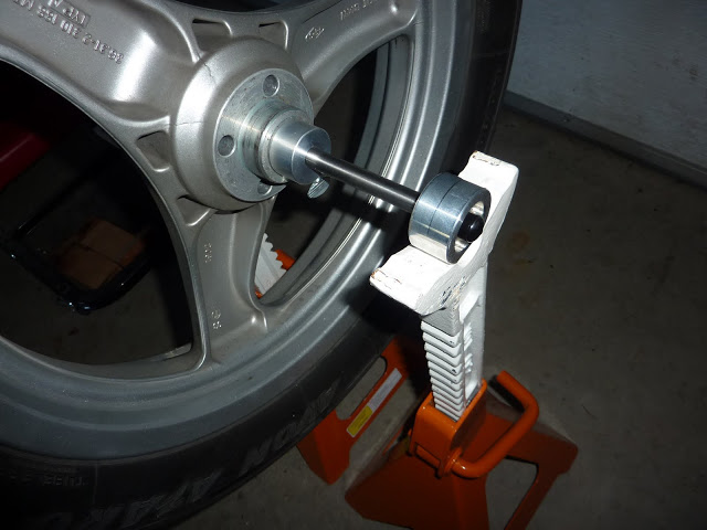

Post by: johnny on March 21, 2019, 10:18:47 AM
that is what accepts the cone on the oe wheel balancer...

Post by: Chaos on March 21, 2019, 10:52:57 AM
K's are supposed to us a balance shaft adapter that bolts to the lug nut holes, the center hole is not necessarily machined accurately in the center
Here is a sample of an alternative (http://www.boxer2valve.com/motorcycle/7223555.html) for rear wheel balancing without the bolt-on feature.

Post by: CG_3D on March 21, 2019, 11:19:32 AM
* P1000947.JPG (58.12 kB . 640x480 - viewed 531 times)
A-ha! Thanks so much for the info! Good to learn something new.  :2thumbup:
