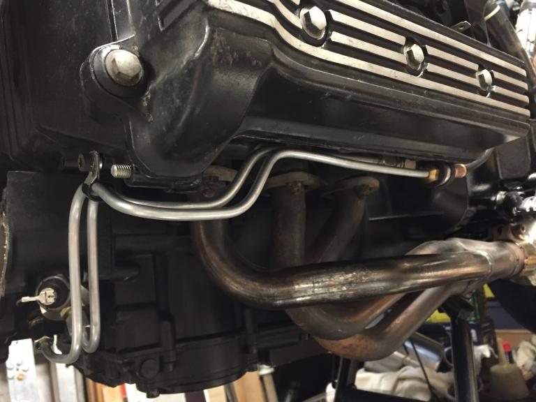

* Oil and Coolant Pressure Feeds.JPG (57.44 kB . 768x576 - viewed 1602 times)
Formed high pressure tubing for security. I believe I'll form a small guard to mount discretely just in front of connection points. Coolant feed is to the center section.

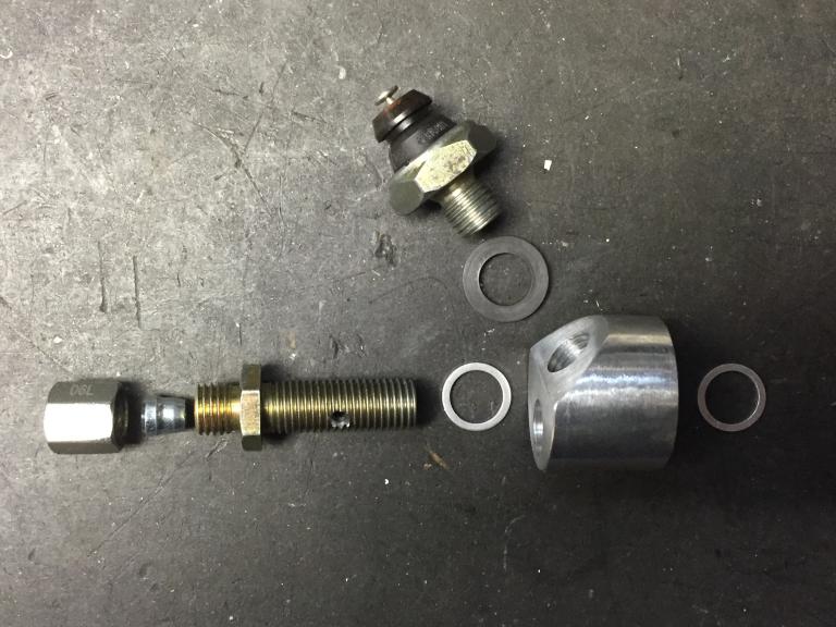

* Banjo for Oil Feed and Sensor.JPG (66.23 kB . 768x576 - viewed 1601 times)
Fabbed this little "banjo" to maintain stock pressure sensor while providing for the oil feed circuit to cartridge.

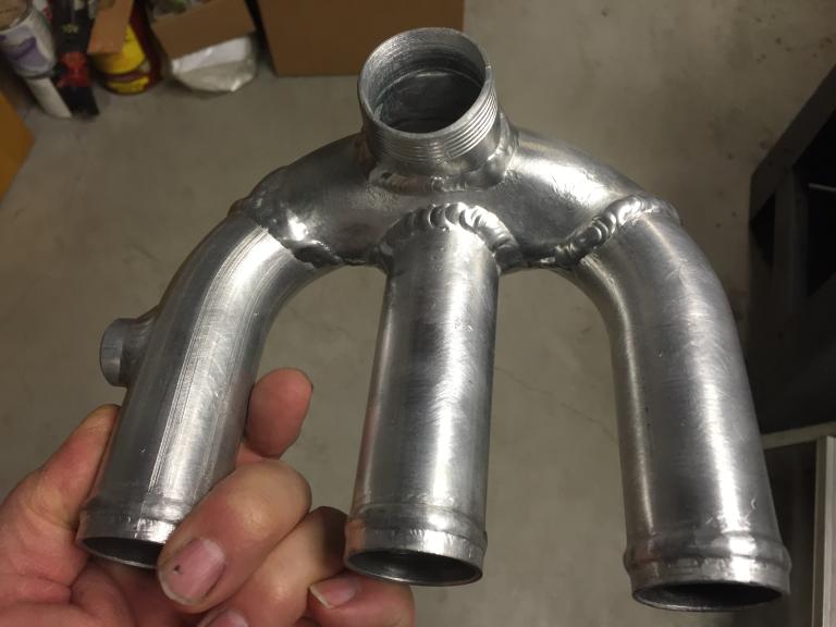

* Inlet Runner.JPG (40.58 kB . 768x576 - viewed 1654 times)
Inlet feed from the air to air, will have an air temperature sensor on the 3/8" fpt port.

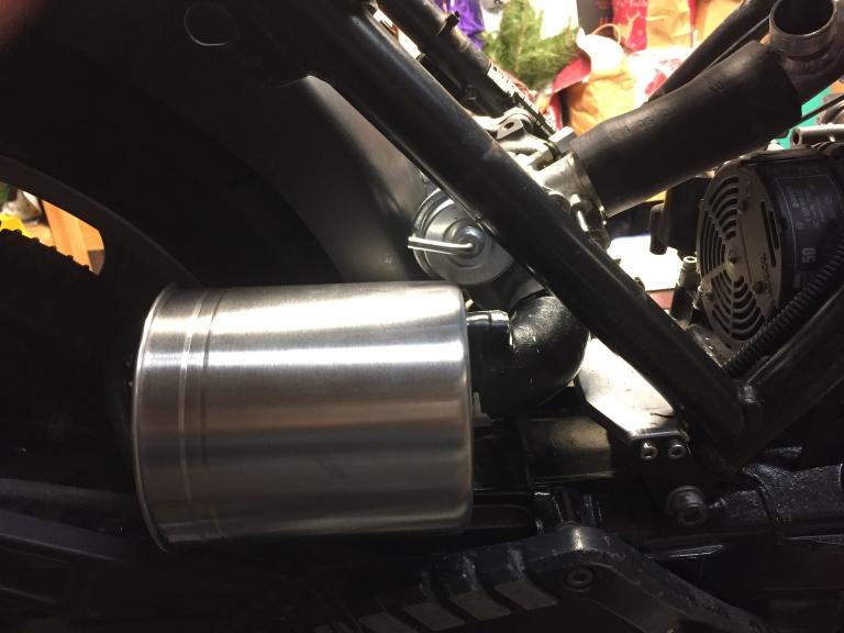

* Charge Air Cooler.JPG (72.26 kB . 768x576 - viewed 1617 times)
The charge air cooler will sit discretely below tank, I'm currently fashioning some tins to allow a small 3" bilge fan to force cool ambient air thru it and onward over the marine heat blanket that will wrap the turbine housing and exit plumbing. Hot air to the rear left side.

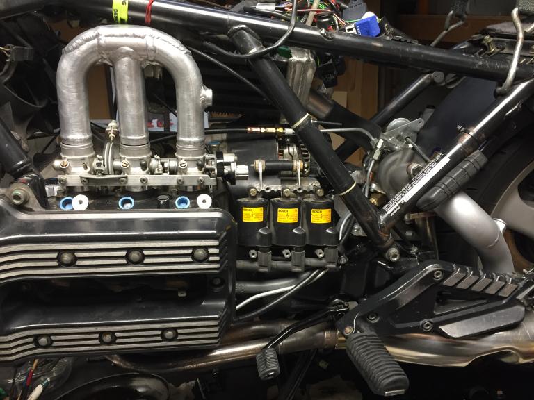

* G.A..JPG (78.71 kB . 768x576 - viewed 1655 times)
Bit of a general arrangement view. Very unfinished.

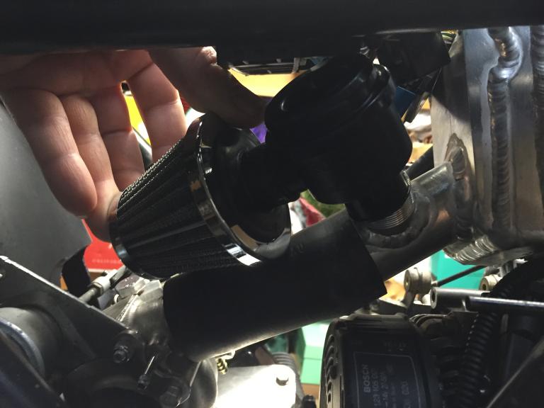

* B.O.V off Charge Air.JPG (44.45 kB . 768x576 - viewed 1593 times)
A Bosch blow off valve with a Motobins filter will hide on the right side. I'm going to plumb the crankcase vent through a small cleanable "externally vented" filter assembly, not showing in any photos, you can't connect to inlet or vapours will contaminate cooler etc.
* Air Filter Canister.JPG (43.69 kB . 768x576 - viewed 1624 times)
Transitioning to a round, canister encased air filter that will sit roughly where one of the ABS pumps had been (those have been removed).

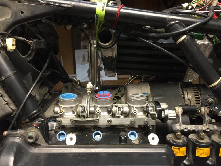

I needed to downsize the original relay/ fuse bucket for space required by charge air cooler, etc. I had sent that item plus a few other things to Jim VB to use to advantage, as per his post here also)
Hence, as the wiring morphs with space available, I've moved some items up into the tail section (above rear wheel) which is additionally where I'll station the Gel Cell battery.
But, a few items like starter relay, stock circuit fuse aray, and some other relays could reside inside something. Hmm - what to use. Out of the tickle trunk comes this little gem, I'll repaint but leave intact the original manufacturers text on the inside of lid.
That rear tail section board includes a small pulse width modulation circuit to provide speed control over the ventilation fan that rams air through the charge air cooler (under tank) and as well continues along via ducting to a shroud over the turbo hot side (turbine housing). That also has the marine grade heat blankets applied for heat management.
  • Abbotsford

Two thumbs up for innovative thinking.  Nice component placement and wiring too.

Thanks for your kind comments Robert! I've followed with appreciation your technical contributions to this forum and must advise that I've certainly benefited from the knowledge and information that you have most generously made available.
The "wiring" work on this bike is actually just at its initial phase - with a lot of pre-planning and design layout, due to a combination of desired functions and as well space available. I am no stranger to having had to back track on "upgrade" wiring and occasionally had to start over where I had thought I was doing something "better" and yet in reality created fresh problems.
In this case, the stock wiring will be cleaned up but left free of final sheathings and tie wraps till its commissioning testing has taken place. Equally, the Microsquirt wiring will be fully bench tested (lap top connected) using an item called a "Jim Stim" to replicate tone wheel sensor patterns initially, followed by actual cranking with plugs out to prove all systems jive, and that the controller will sync. That quite possibly will be done by spring at which point I hope to continue "center stand" tuning followed by over the road/ hill tuning to gain a reasonable MSQ.
