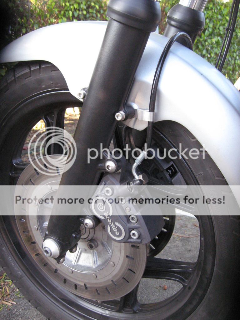

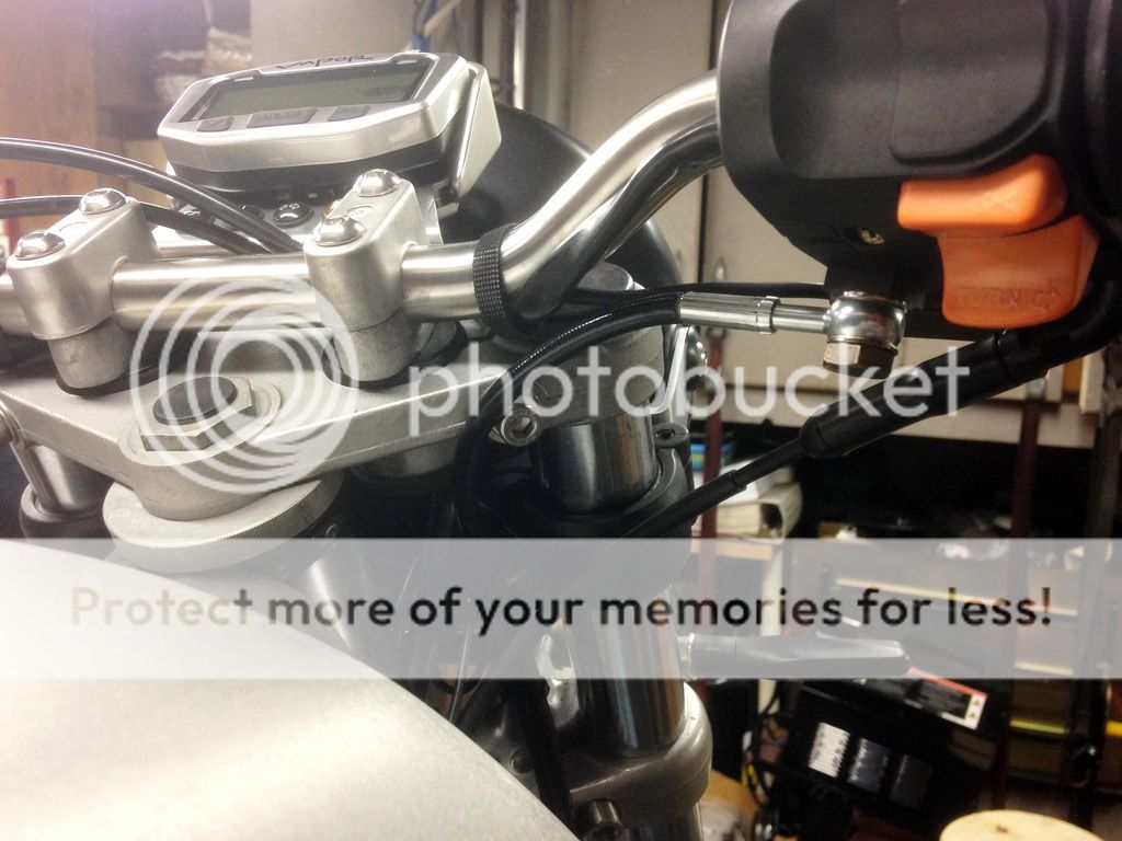

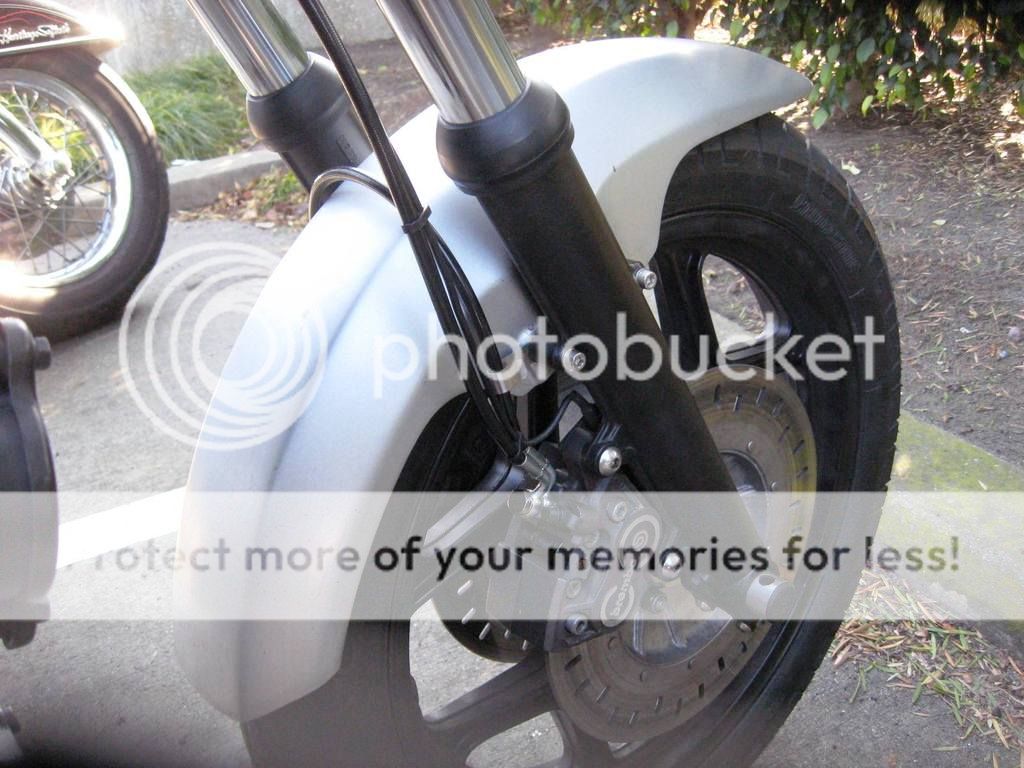

New front brake lines.
I was not really happy with the look of the two lines coming from the master cylinder down to the calipers.
Now it is one line coming from the master cylinder down to the right side caliper and, through a double banjo off that line, across over to the left caliper.
I added some retaining brackets from the rear mounts of the front fender for a cleaner routing.

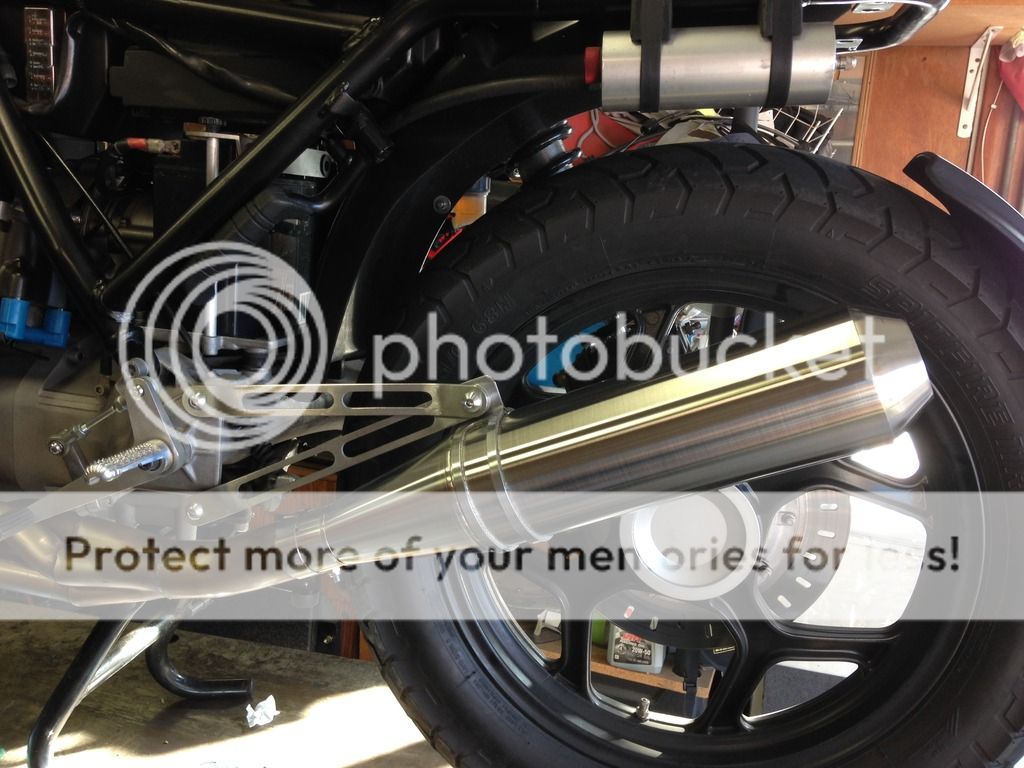

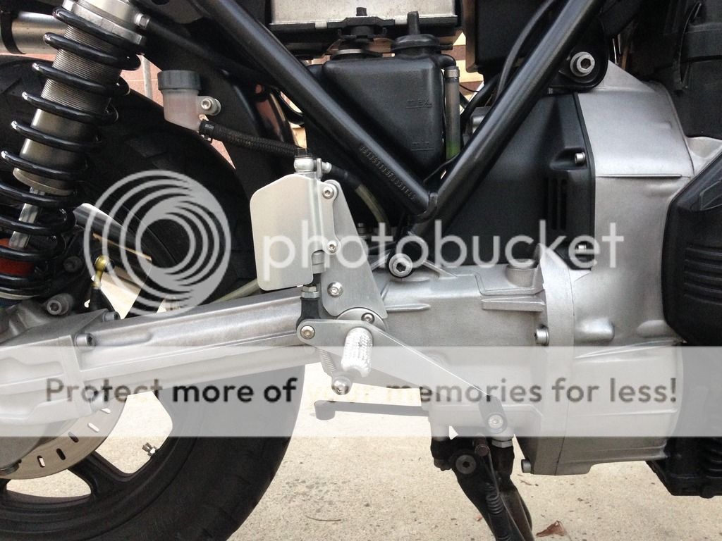

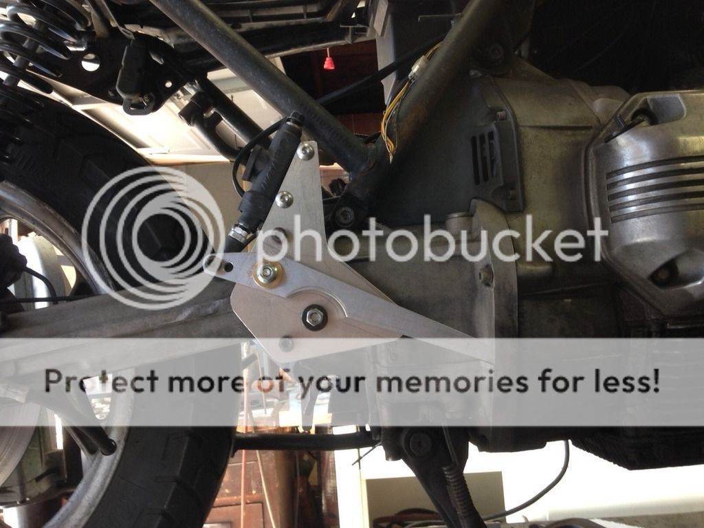

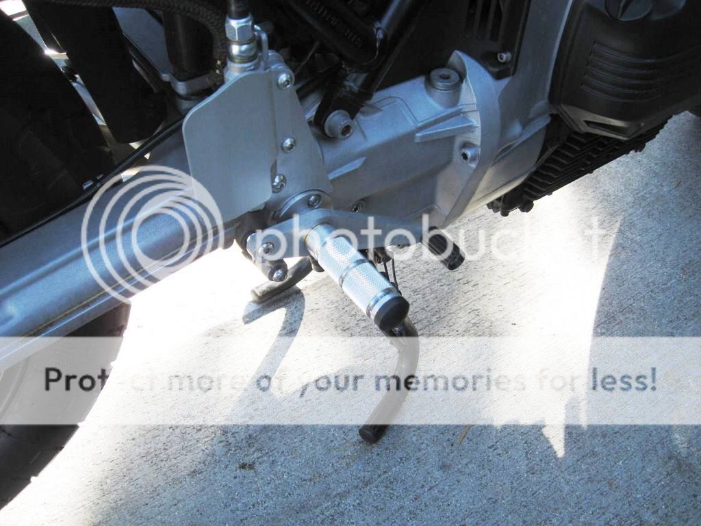

Here are a couple of detail pictures of my Custom (home made) rear sets.
All the rear sets I've seen for the K Bikes bolt to the two rear most stock foot peg plate mounts. That was too far back for my taste. (old'ish knees )
I played with location quite a bit and finally realized that the swingarm pivot location was perfect for me. So that became my mounting plate, if you will.
I drilled and tapped both sides and cut the levers out of 10mm plate. I added brass bushings for the pivots, ordered some metric heim joints and this is the result.

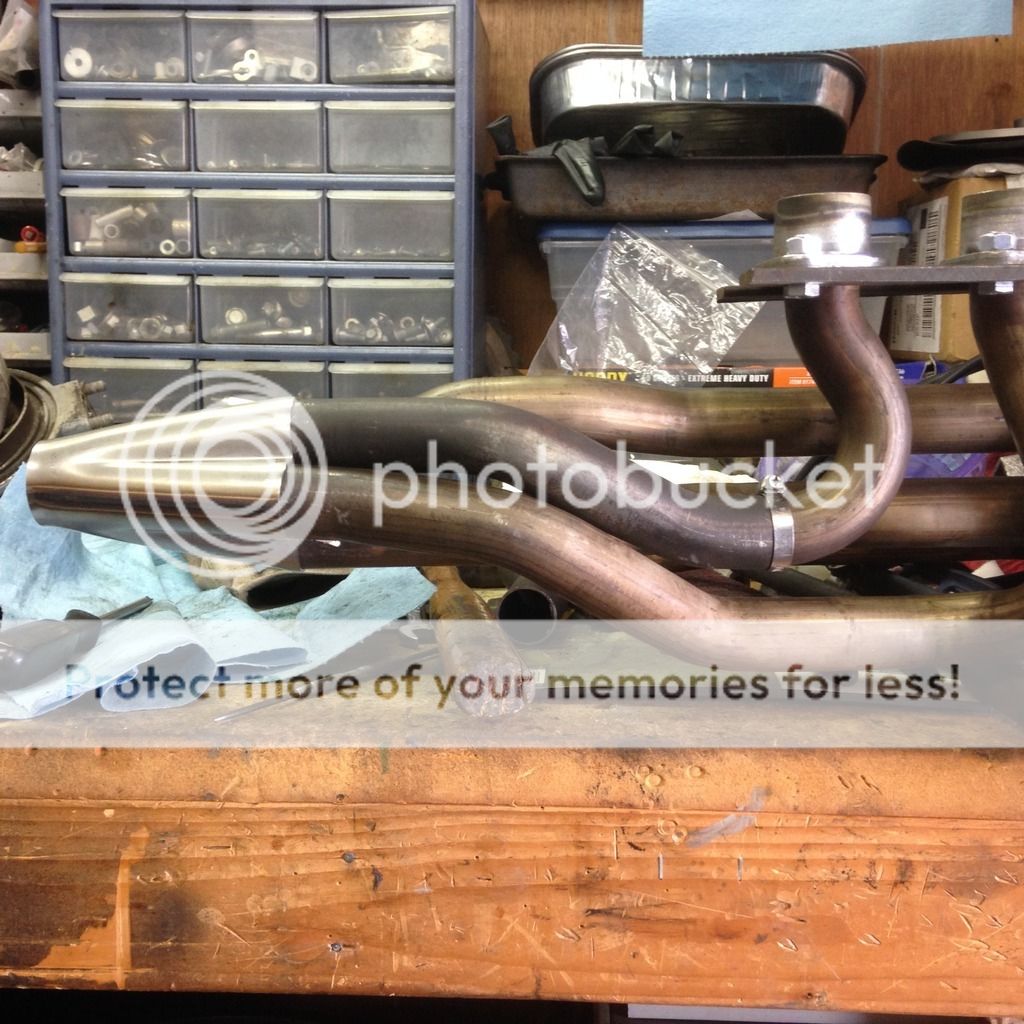

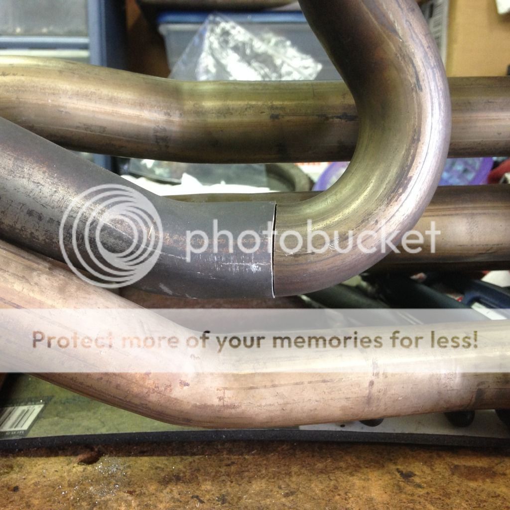

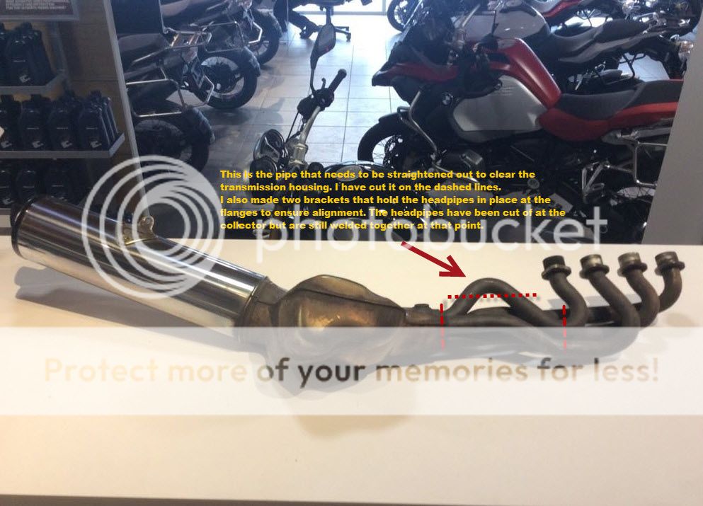

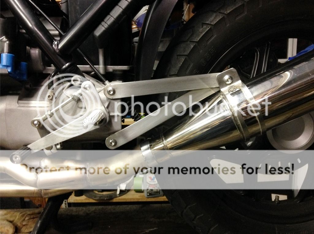

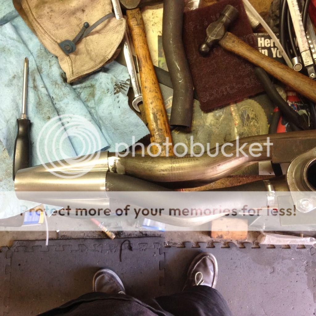

A few more detail photos.
from this
to this
K1200 exhaust modification to fit the k100 transmission. The sidestand mount had to go as well.

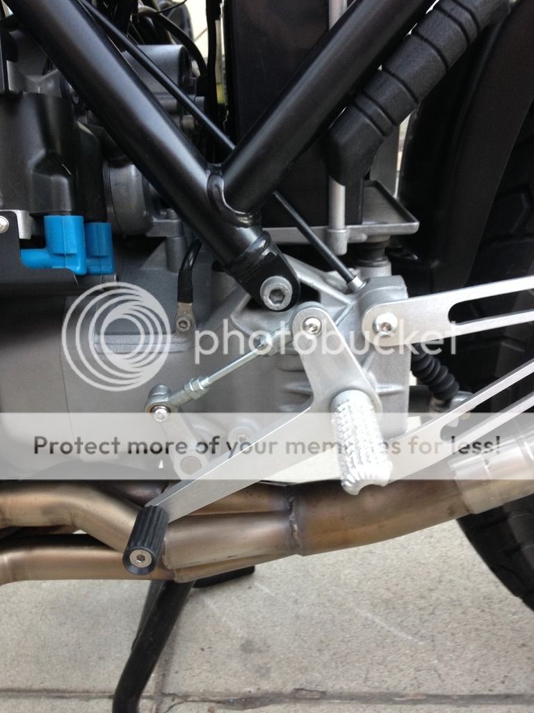

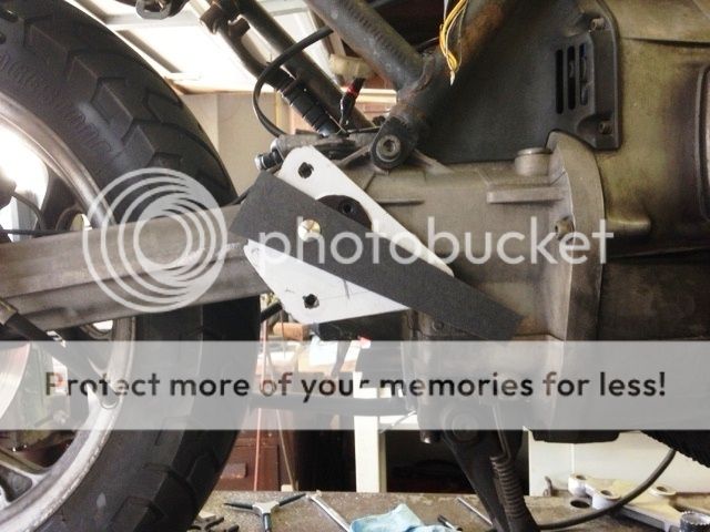

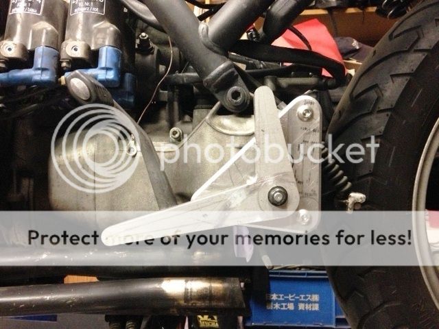

Above I showed the rears sets as they are now.
Here is where I started.
Brake side.
Shifter
I wasted several pounds of aluminum to arrive where they are now. I still want to give the levers an I-beam type profile but haven't quite figured out yet how to do it without a mill. I refuse to just drill a series of holes...

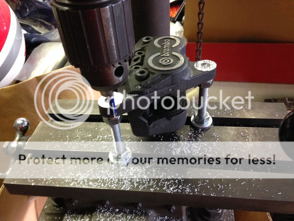

Oddly enough, I used a hybrid version of your method to adapt the K1100 calipers to the K100 fork legs. Except I didn't like the appearance of the finish. Since that side bolted up to the fork lugs I didn't mind all that much, but with the rear sets being in plain view, I do care.
I used a 1/4 flat wood bit, as seen here:

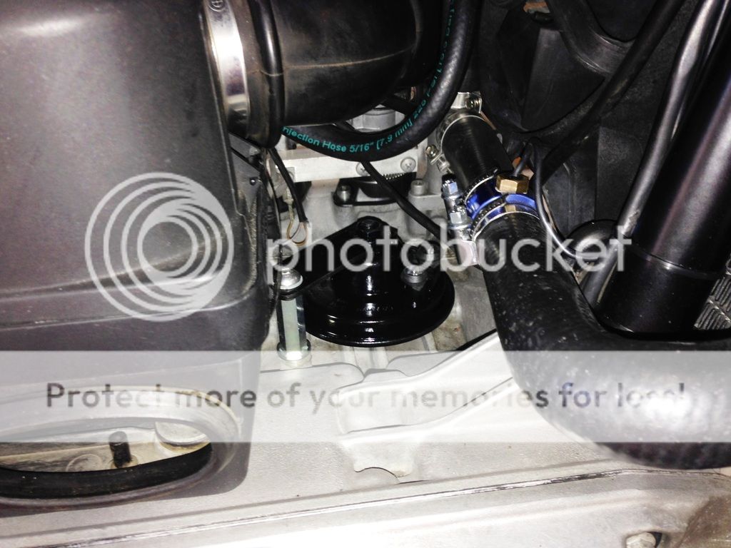

More details.

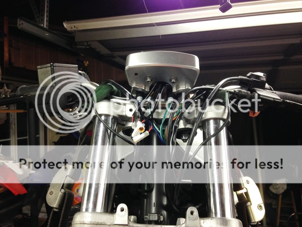

Here is where I stashed the horn, and you can see the temp sender for the Trail Tech Vapor gauge.

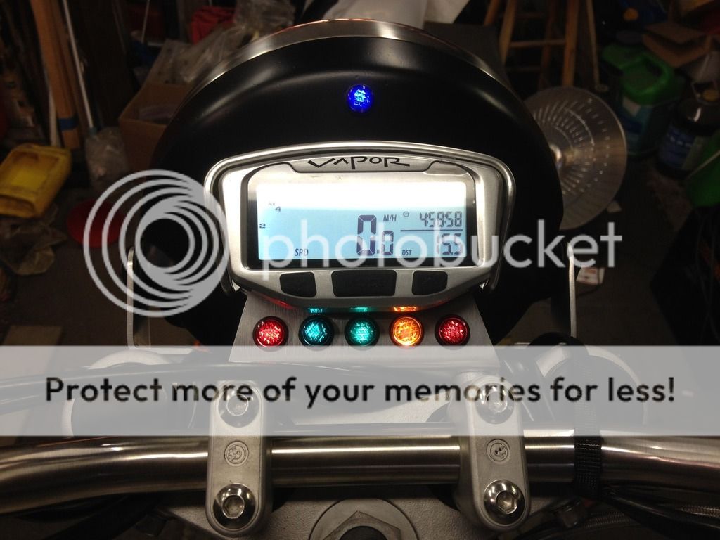

Speaking of the Vapor, couple more photos of that installation.
I used a mash up of different kits, especially the warning lights. Normally they come as a set of four but I ordered extra bulbs and combined them in a 9 pin connector. This allowed me to get all the warning light functions in one place.
From left to right: Oil pressure light is actuated by a stock sender.
The Neutral light is actuated by an R1100 neutral switch modified to work on the K shift drum. I don't mind not having a gear position indicator as long as I have the neutral light. I do have to pull the clutch lever to start the engine though.
The turn signal indicator is in the middle. I had to solder diodes into the leads so the right turn signal wouldn't also actuate the left and vice versa.
Highbeam ended up in the headlight bucket, just above the gauges.

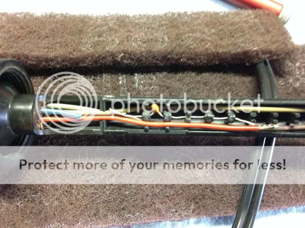

Low fuel was a bit tricky. I ended up buying a 2 kohm thermistor from the local electronics supply and wired it into the stock circuit in the 4L position. Works like a charm.
The Gen light was wired up stock as well.
The Vapor indicates speed, rpm,trip and odometer, clock,water temp, elapsed time, max speed/rpm/water temp and ambient air temp.
It also has shift lights, as well as high water temp warning. They are programmable for low and high, actually high and higher.
I've had one on my XR650R for at least 8 years, so it was an easy choice to make.
Thermistor
Any questions, feel free to ask.

I was doing laps around the bike trying to find a location for the horn. If I had a couple of the Fiamms I might have gone outside, but once I stuck the horn behind the radiator I was a happy man. The threaded boss is already there, unoccupied, and it's already threaded with an 8mm hole.
Gauges for a K are truly a challenge. I know it's been made easier by rbm, but I didn't know about his device when I started my build.
My initial plan was to use one of these http://tinyurl.com/zmsgl2c but $369 was more than I wanted to spend.
The Vapor has so much functionality, for the price that it was an easy choice.

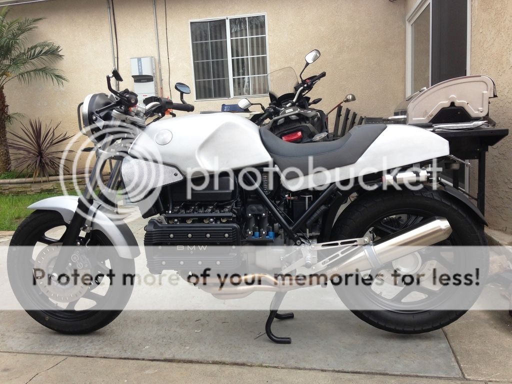

Another quick update.
The bike is 95% done. Now it's the iddy biddy details.
I did install a different set of footpegs. What was on there was quite short and extremely buzzy.
Got these off eBay, less than $10 shipped, but it took a while.
I had expected them to be drilled out, but they were solid save for the 8mm threaded hole on one end and a larger hole for the plastic cap one the other end.
Having said in the past that I wish I had a mill, well I would like a lathe as well.
Due to the design of my rear sets I cannot install a bolt from the mounting plate, since there isn't one. The swingarm pivot bolts are the mounting plate.
A stud could have been used but there was no way to tighten the peg securely without first filing or machining flats on the peg for a wrench.
So I drilled the length of the peg to allow the installation of an 8mm Allen bolt from the peg side.
Here is the end result. Oddly enough, these pegs are less buzzy, possibly due to their more substantial mass. They are also 20mm longer than the previous ones, even with 12mm cut of the inboard side of the peg. In other words, they are more comfortable.

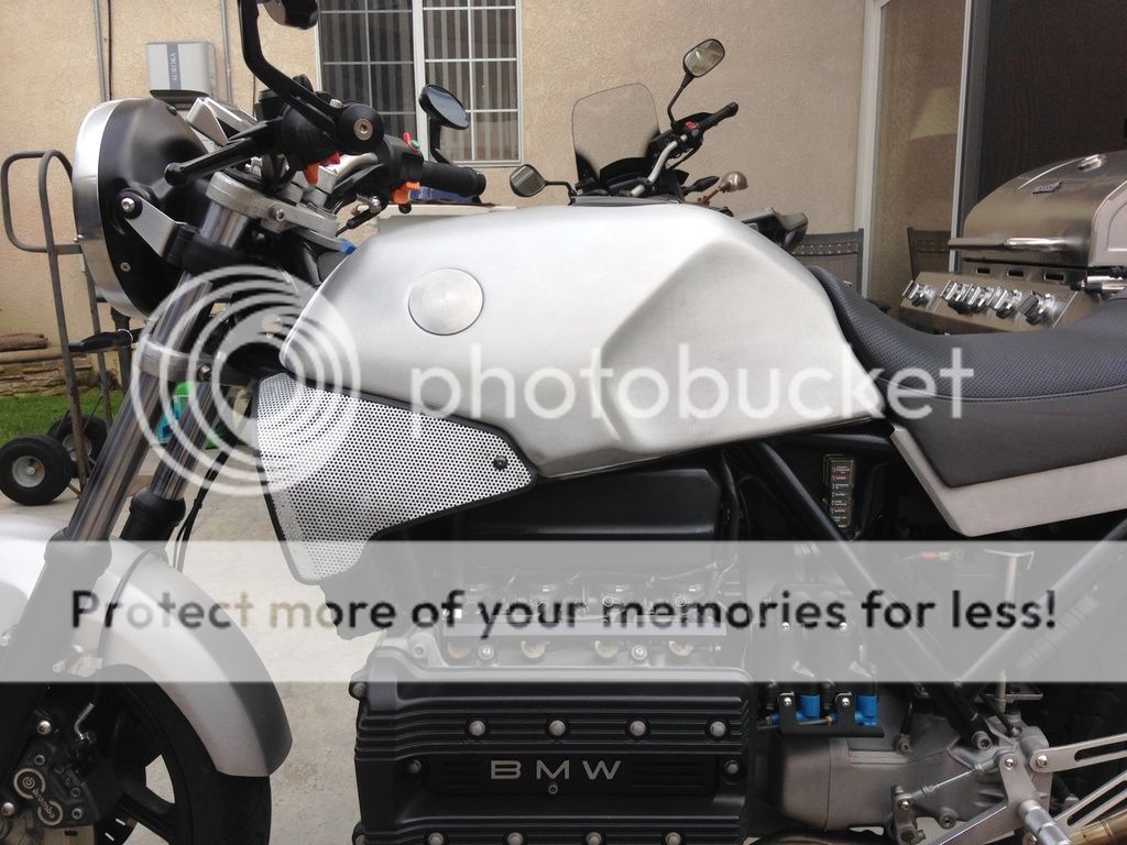

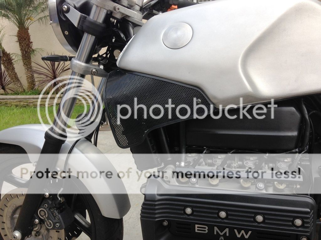

Here is one of the toughest areas to deal with on 'naked' K100s. The area between the radiator and the front of the fuel tank.
I actually own the stock radiator shroud that comes on the standard K100, but wanted to limit the amount of plastic/fiberglass to a minimum.
Here is what I came up with.
It's made from perforated aluminum, about 2mm thick.
I'm torn between black and aluminum, so here are both versions.
And one overall shot in aluminum. (Didn't think to do that before I stripped the paint...)

Silver looks good on the closeup. but the black looks better overall. at least to my eye...
keep going...

I'm torn myself about the color. The aluminum continues the theme of aluminum as a color, but the black just looks 'right' for that piece.
The stock I'm working with is painted black and I still need to make the other side, so that'll give me a chance to compare the two colors at the same time.

You did nice work. There's no question there. I did a lot of mock up too. I was going to make the same with either sheetmetal, aluminum, or fiberglass. Eventually, I came to the conclusion that the raw naked look of the tank is one of the things that makes the K endearingly ugly.
I'm partial to the black myself if you do decide to add them.

I like seeing the mechanicals as well, but I do not want to leave the mounting hole for the radiator shroud open. I've already painted that whole area black, and had a plug in the hole, but it still looks somewhat unfinished. I also don't want to cut it off, just in case.
The right side is used to hold the bracket for the ignition switch, but I've yet to find the perfect fastener for that task. I'm currently using a button head Allen, painted black, but it still doesn't look like it belongs.

I like the way that piece helps define the line of the bottom edge of the tank.
I like the silver best because it does the best job of highlighting the line.  But...it would be interesting to see the part made with non-perforated metal.
Also, something there is screaming for a shark mouth with lots of sharp teeth.
