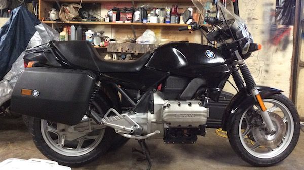

tragkorbs mounted and ready to ride til snow flies.  Then think about doing something w that awful black paint job.  And re-assess the water pump leak.

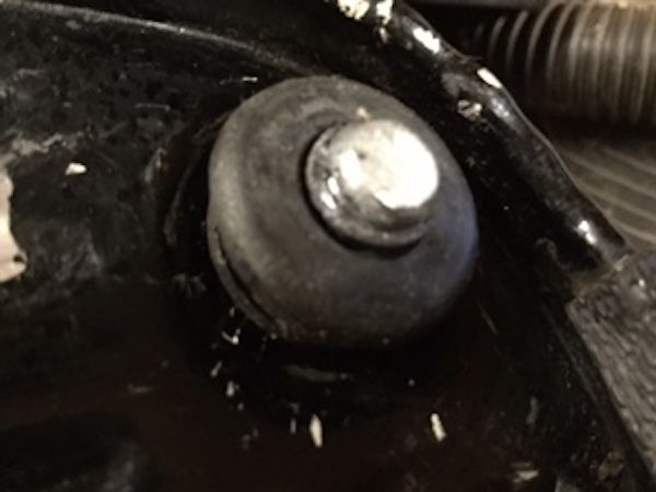

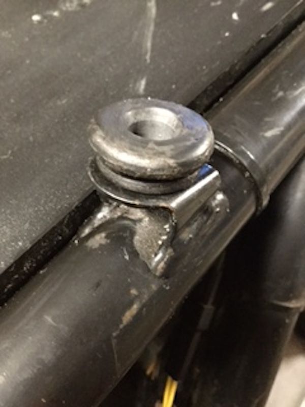

Hey guys, can you please tell me.  Are the rubber tank grommets supposed to remain fixed on the tank pins.  OR, fit into the frame brackets and remain fixed on the frame?
thanks
  • Illinois
  • 87 K75C
  • Posts: 6843
Re: New to me 87 K75C/T
« Reply #104 on: November 13, 2016, 12:08:21 PM »
Mine stay on the frame although one of them, on my K100 did have a tendency to stick to the peg on the tank.  I glued it to the frame, and use a little bit of Vaseline on the peg.

« Reply #106 on: November 13, 2016, 02:27:57 PM »
Both of mine are on the tank - which given the state of my bike would indicate they should stay on the frame....

« Reply #107 on: November 13, 2016, 02:54:33 PM »
10-4 on that, and Vaseline for all grommet-peg fittings.
 No glue on mine yet, but I did buy new grommets and clips.
« Reply #108 on: November 13, 2016, 06:59:42 PM »
I always was told that anything oil-based was a no-no for rubber....
Pure silicone to keep soft and not degrade...
« Reply #109 on: November 13, 2016, 08:05:51 PM »
I can say this.  I got em on the frame now, and w a bit of silicone tank pops on easily and the clips are a lot easier to install and remove.

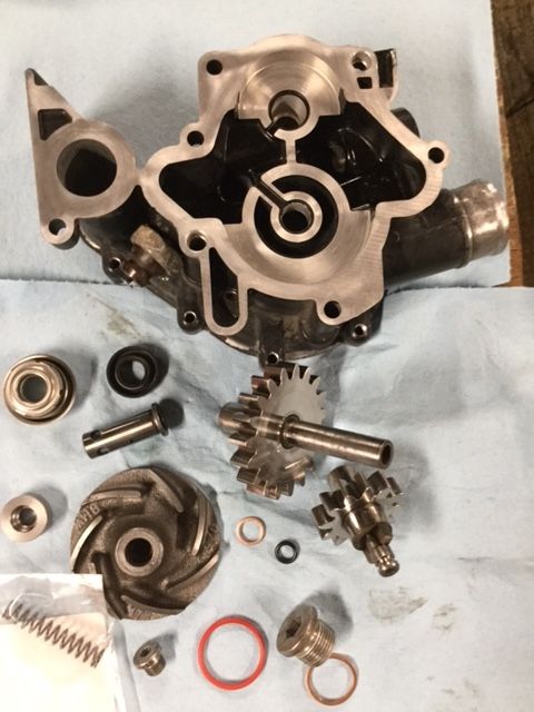

« Reply #110 on: November 25, 2016, 01:49:43 PM »
No luck Whitetail hunting,yet.

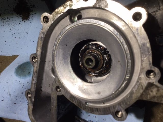

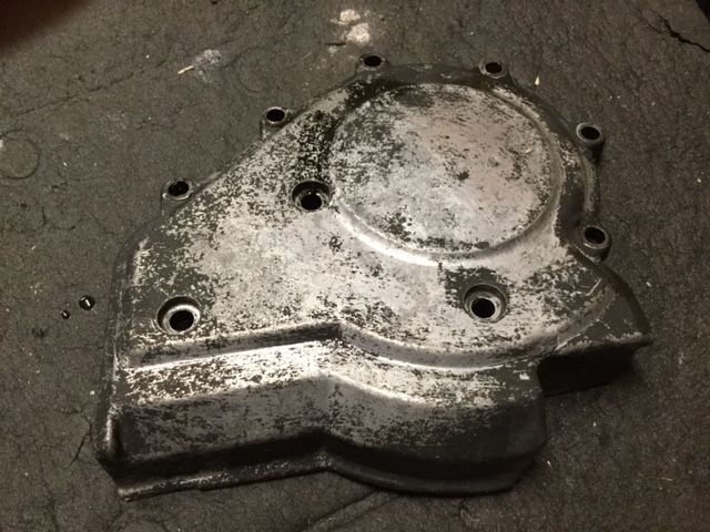

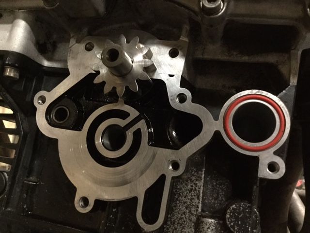

Got busy on the waterpump rebuild.

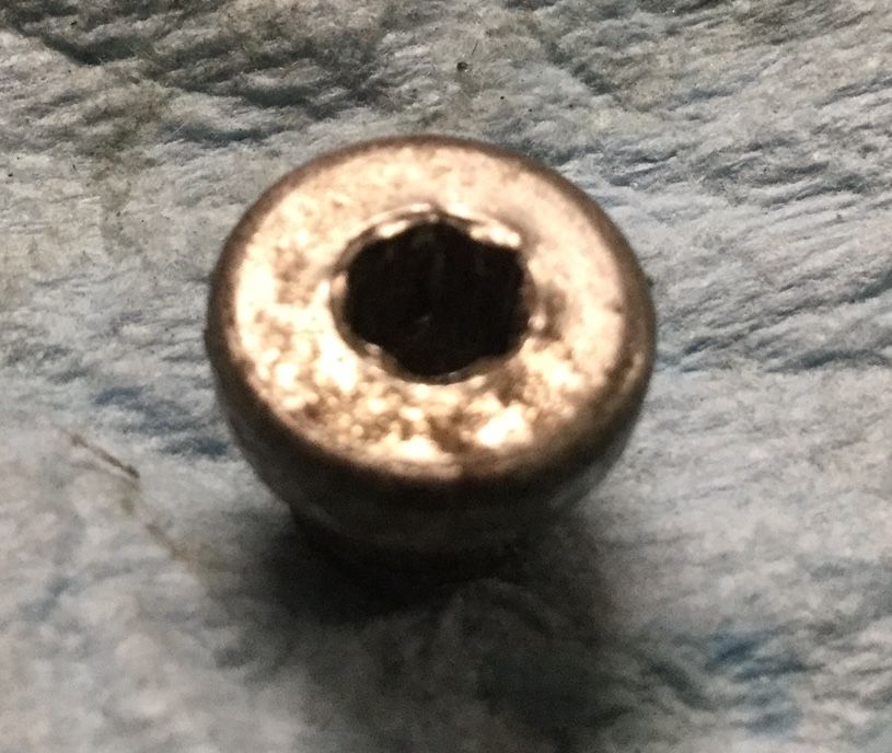

first thing I found was PO had stripped the head on the drain plug.
I may have found the issue...
Cleaning and re-assemble.
All done but the finishing part.  Waiting for the new drain bolt to arrive.
« Reply #111 on: November 25, 2016, 02:46:08 PM »
That pump cover appearance is now Harleyesque. A new bandana is in your future.
LOL, Oh yes.  Shocking, how little it takes to make a K look exactly like a harley.

The thought of slaving away with all that pride of ownership polishing is daunting,to me.Bricks are relatively free from this requirement but hey,if your into that then go for it.I love the utility aspect of my K.I hardly ever clean mine either...my kind of street cred?
As for my (old)Triumph,that is another story.It's definitely not utilitarian and the fettling process catches the next thing to fall off.
Im right there w ya.  The polish took all of 15 minutes.  I just didnt want to deal w headache of anymore shitty chipping paint.  The cover will gain a real nice smooth oxidation over the next year or two and will match the rest of the engine nicely.  Same as the timing cover.

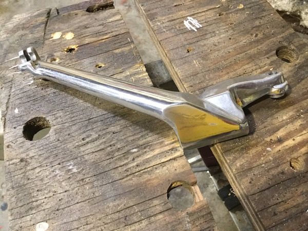

« Reply #118 on: November 30, 2016, 06:53:12 AM »

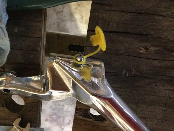

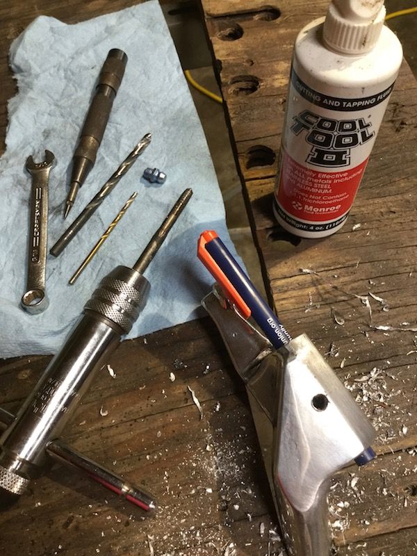

Martin suggested a clutch lever mod that made perfect sense to me.  So, I did my best to duplicate.
Cleaned it up a bit w a half assed quick polish before starting work.
a ball point pen tube fits tightly through the bearings to help keep them clean.  Flushed out shavings before pulling the pen out, then flushed again after.
Done.  Thanks Martin.   :2thumbup:

« Reply #119 on: November 30, 2016, 07:18:08 AM »
That's 15 minutes you'll never get back though. Now, you're doing it to the clutch release arm! Onlookers will be blinded! The elderly are distressed about your use of time!
 :hehehe
Your modification is well-done and an example for others. :2thumbup:
